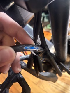

I will also add, on the biggest cable running from the PR to the motor, it seems to have touched the wheel while spinning and lost some of its insulation. I've attached a picture, but If you look close you can see that the metal from the blue wire is not touching the metal from the white wire. So unless having exposed frayed metal causes an issue, I don't think there is anything wrong with this. I think all I need to do is snip the frayed wires and wrap some electrical tape around it.IMG_6893.jpg

On the frayed cable, any chance the frayed portion contacted the frame when you hit the bump? Is the cable shielded?
