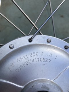

I have a Bafang G310 from Grin. I am about to purchase an old mountain bike, 26 inch wheels, V brakes. I would like to have a bike shop install the hub in the existing wheel.
Would they be able to use the existing spokes? Or will I need to get beefier ones for this build. When I chatted with the bike shop the other day, they said their spoke cutting tool couldn't handle thicker ebike spokes and most likely I would need to order spokes from wherever I got my hub motor.
What gauge of spokes would this setup need? Since the G310 is on the smaller side would the existing spokes be ok?

Hub motors are usually drilled for thicker spokes than what the rims need. As a result, when you use 14ga (2.0mm) spokes, you'll have to put 2.0mm flat washers underneath the spoke heads so they don't dig into the hub holes or try to pull through.
14G spokes with washers will work per Chalo's comment, but if you look at Grin's web site, I believe they recommend Sapim butted spokes, 13G at the elbow and 14G at the wheel, Bike shops ought to have a spoke cutter that can handle 14G.

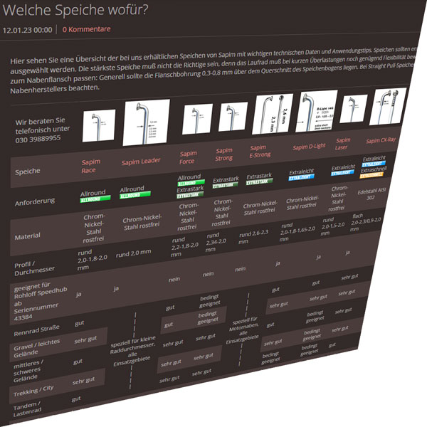

why do they have to be heavy motorcycle rims for 2.3mm spokes? i drive now a rim from DT swiss, hybrid u683 with Grins all axle and butted sapim strong spokes in 2,3mm and 2,00. i cant say that i find this spokes to be "strong" and thinking if i should switch to thicker spokes, but i am not sure yet. i think those DT swiss hybrid rims should handle higher tension from thicker spokes, unfortunately i dont see this information on their website, they only write rider weight limit of 180kg.
i noticed today that sapim has also E-strong spokes in 2,6mm and 2,3mm which they recommend for hub motors, here is a comparison (in german):

They have to be heavy rims so the spokes can be turned up to a high enough tension that they stretch elastically enough to follow the rim as it flexes under load. A 2.34mm round spoke needs 37% higher tension to stretch the same amount as a 2.0mm spoke of the same length, and 69% higher tension than a 1.8mm spoke. But bicycle rims are usually rated for maximum spoke tension of 100kgf to 125kgf. So at that maximum tension, the thicker spokes will go slack and cause problems at lower wheel loads, making the wheel weaker even though the spokes themselves are stronger.
That's where the DT marketing claptrap you quoted fails hardest. Spokes are under continuous tension only when the wheel isn't loaded. When it is loaded, the tension drops as each spoke passes over the contact patch of the tire, and if that tension drops to zero then the spokes go slack momentarily and cause loosening and fretting damage to the rim. The thicker the spoke, the lower the wheel load at the time this happens.
If you use a rim that can tolerate proportionally higher spoke tension, then you can make thicker spokes as reliable as thinner spokes at lower tension. But you could also use thinner spokes at the higher tension and the wheel will be even stronger.
