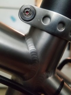

Still haven't found a frame. I caught a great deal on an new M620. Thought I would just keep it as a backup for my QK Ibex, but decided I want a hardtail bike for touring. (Plus it's 52V and the Ibex runs on 48V.)
But literally the only m620/Ultra hardtail frames I can find are:
Either from Alibaba and I can't seem to get any of those sellers to ship me a 'sample'
OR,
A titanium frame which will cost over $1000 shipped, frame only.
Part of my problem with FS frames is that the rear shock typically invades the space where I'd like to put a big triangle battery. But I'll also need to have a rear rack and panniers, and those options are very limited for FS bikes.
At this point I'd purchase a used hardtail frame which will mount this motor.
Any other leads?
Other questions:
No way to mount that motor on an M600 (or other Bafang mid-drive) frame without cutting and welding, right?
Am I incorrect in believing that a carbon frame will be less durable than a metal (aluminum/titanium/alloy) frame?
