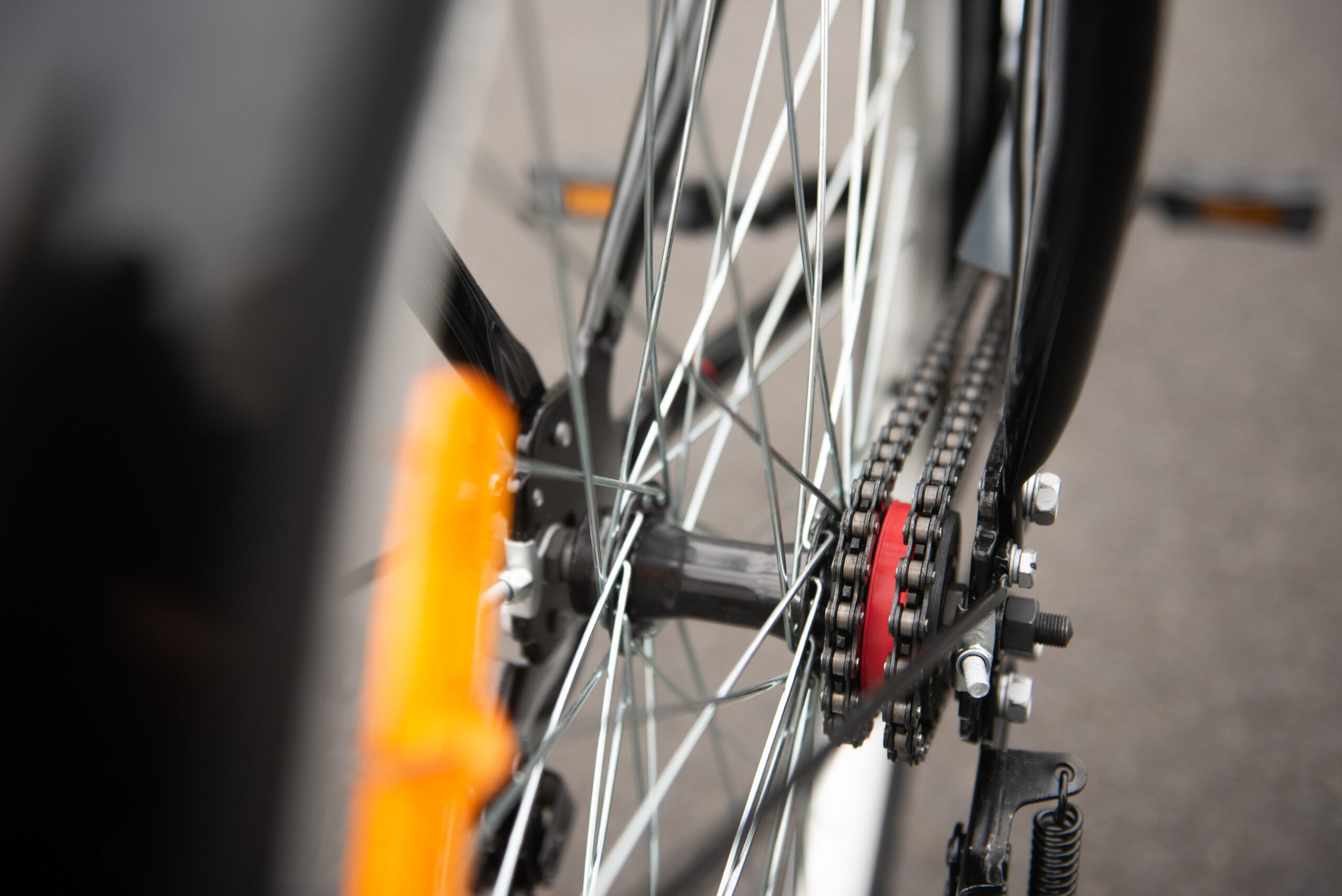

Check this bike out:
It only needs a box wrench (and spoke wrench) to service. Though I doubt a spoke wrench will ever be needed as it has a dish-less rear wheel with steel double wall rims and 13 guage spokes.

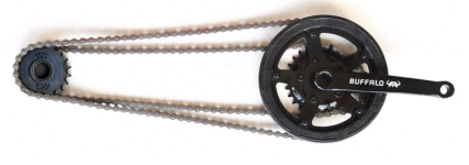

Here is the newly updated version of the Buffalo bike called Utility S2:
The major change is the kickback two speed pedal drive train (patented by World Bicycle relief) where the rider backpedals one half rotation to change from to either 45/19 gear ratio or a 27/18 gear ratio. This backpedal motion activates a shift ring which engages or disengages the pawls in the higher gear’s cog in order to accomplish the gear change. Both chainring and cog combinations use a 1/8" chain. One of the chains has 110 links and the other chain has 100 links.
Other changes include rim brakes front and rear (which replace the previous versions coaster brake and front servo type drum brake), aluminum double wall rims replacing the previous version's steel rims (for better braking with the new rim brakes) and wider rear frame spacing.
