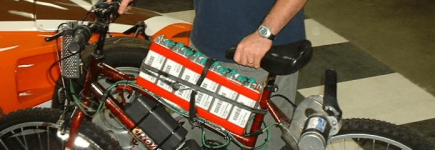

Here's an Ucap/NiCad bike from a long time ago.
Six 2500 Farad 2.5V Maxwells in series wired in parallel with the NiCad pack. It stiffened up the battery but really wasn't worth it, especially if we would have had to buy the caps.
