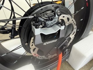

Hey everyone,
Starting a build thread for my Super73 S2 project.
Intended to be a little somethin’ to get be around the neighborhood and pickleball courts :) shhh
The plan is basically:
  • QS205 3.5T rear hub
  • 72V system
  • FarDriver ND72300
  • Shimano M7120 brakes
Current focus areas:
  • Torque arm design
  • Tail section/controller packaging
  • Harness routing
  • Cockpit integration
  • Lighting system
Current Hardware
  • Frame: Super73 S2
  • Motor: QS205 72V 5000W 3.5T
  • Controller: FarDriver ND72300
  • Battery: 72V 20Ah Samsung 50S
  • Brakes: Shimano M7120 + 203mm RT76 rotors
  • Fork: Tapered inverted fork
  • Cockpit: Renthal
  • Full twist throttle
  • Minimal switch setup
Electrical:
  • QS8 service disconnect
  • 72V -> 12V accessory system
  • 6-way fused accessory distribution
  • 1.5-series waterproof connector ecosystem
Still finalizing a few things and open to input from people that have similar setups:
  • Best torque arm strategy for slotted S73 dropouts. I have custom dropouts and then ones in the market don’t fit. Should I make a cardboard mockup and have it 3D scanned or take it to a CNC fabricator?
  • Thoughts on venting vs sealing the tail electronics compartment
  • Cleanest rear brake light integration setups
More updates soon.
Things seem to be going well. Waiting for stem and titanium bolts/nuts to arrive, as well as battery before I can stage everything up. The biggest scope right now tends to be fabricating brake mounts, torque arms, and electrical/controller enclosure.
Here’s a 3D prototype of the post mount extended adapter to kill the offset.
And another 3D print in action to see what the enclosure will look like.
Lmk know when you fab torque and brake mounts I’ll buy a set asap, just started putting my qs205 s73 tonight and found out the hard way
