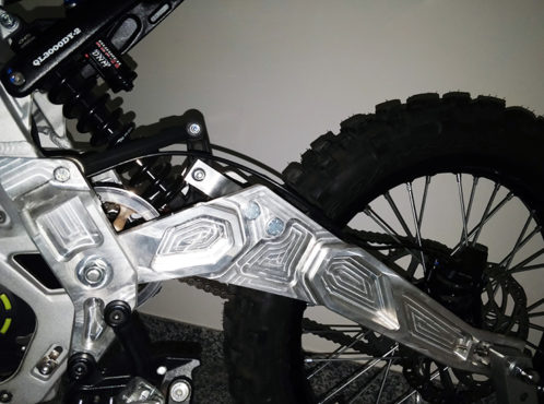

efMX Trials Electric Freeride said:saw a couple of interesting things on the inner webs..
Sur-Ron with wider rear swingarm and other mods from sur-ron-italia.it :
https://electricmotorcycles.news/sur-ron-italia-competizione-concept-by-gb-e-moto/
ebikeguy123 said:efMX Trials Electric Freeride said:saw a couple of interesting things on the inner webs..
Nice! I was looking for a way to put a larger tire on the back.. i would prefer something that looks more like the original swing arm though.
