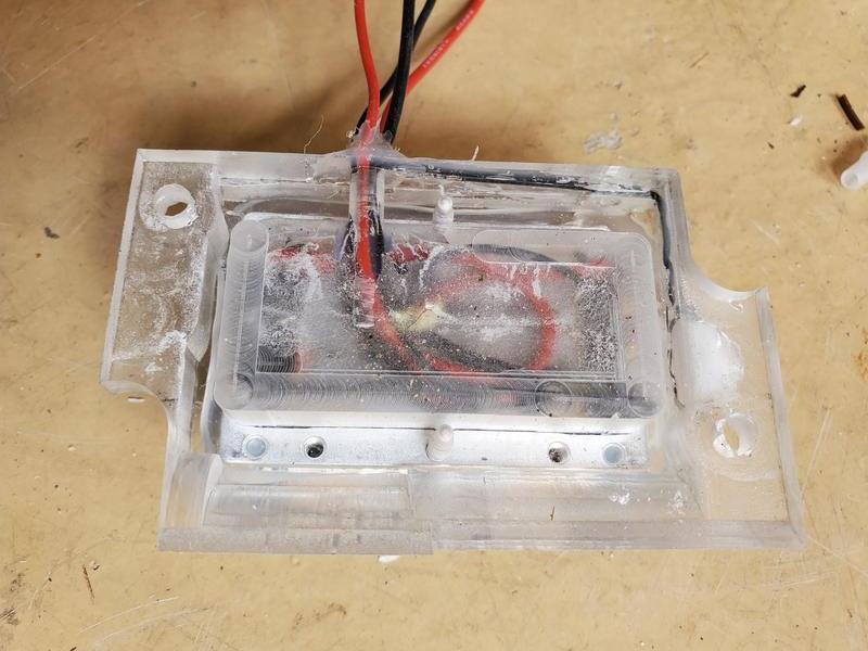

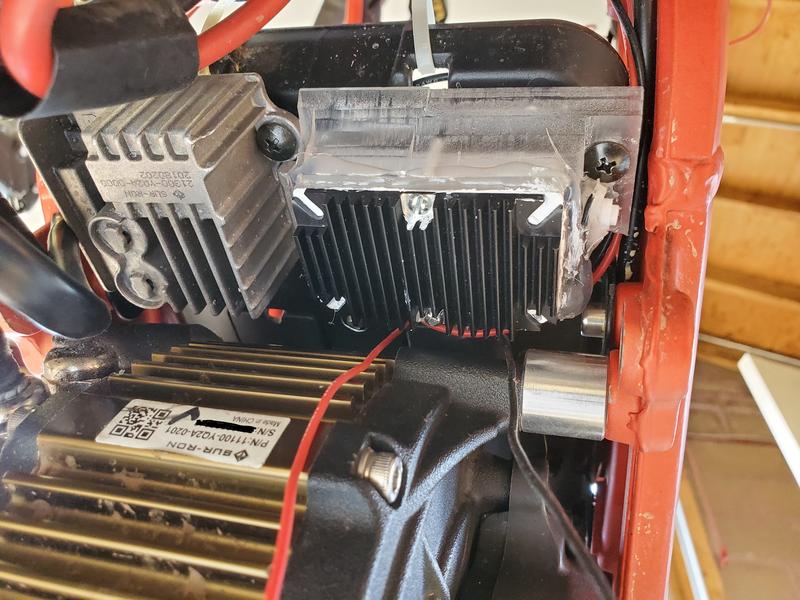

Finally built a case for my LED lights DC/DC converter. Milled from a piece of acrylic plastic. I installed it next to the sur-ron dc/dc converter because I removed the twist throttle device for a thumb throttle.
This wasn't an easy job and took me an embarrassingly long time to make. I wanted it to be very robust and waterproof. I added an on/off switch, but it will still turn on and off with the key switch if the DC/DC converter switch is left ON. If I'm not using my lights then I don't want to leave it on as it uses 4-5 watts on standby.

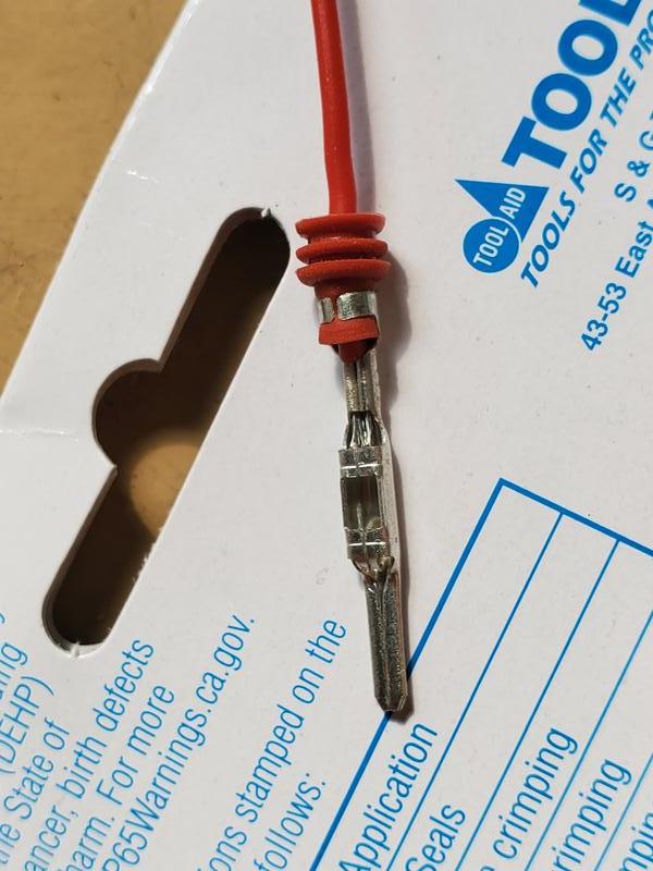

I made my own connectors to connect to the stock connectors, so I wouldn't have to splice anything for the battery voltage.

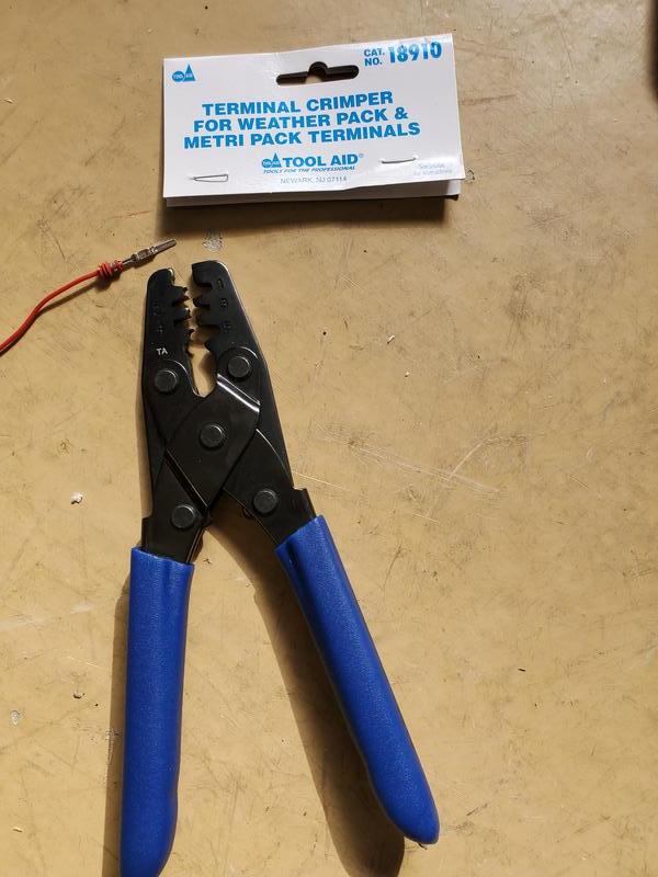

This crimping tool worked great and made very good crimps.
http://toolaid.com/product/18910

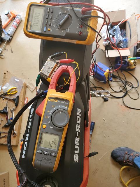

Was out last night testing out my lights. Unfortunately it seems my power supply has issues as I can't draw more than 7 amps before it has a huge quick drop in voltage and eventually turns my lights off. I have to limit the lights power.

The battery voltage (68 volts) going to the sur-ron DC/DC converter, that which I tapped into the wires, seems to voltage sag with very little load. These are 2 smaller wires and the 68 volts (battery voltage) goes on and off when you turn the sur-ron key.
Basically just the sur-ron dc/dc converter will drop the voltage from 58 volts to 48 volts just by connecting the sur-ron dc/dc converter and that draws less than 1 amp from the 68 volts wires.
I'm not sure how the battery voltage gets turned on and off to the sur-ron DC/DC converter when turning the key or bike ON,but there is something that seriously limits the current and you get huge voltage sag by trying to draw power from these wires.
Would anyone have an idea on what Sur-Ron could have done to limit the current going to the dc/dc converter and which causes huge voltage sag if trying to use these 68 volt wires?
Is this some kind of safety precaution they built in or is it just resistance in how the power gets sent when turning the key on/off?
I thought all along my DC/DC converter was the issue because I would never imagine that the high voltage battery input, which I probably only use 1.5 amps max, would be the issue. When I connect directly to the battery using alligator clips, I can power all my lights which draw 12.5 amps, with no issues.
As far as I know, the battery voltage goes from the breaker to the key switch (via the small glass fuse) to the DC-DC. You might want to check the voltages on the ends of the glass fuse. You shouldn't be seeing that kind of drop. Something is getting hot somewhere that's not supposed to be or one of your measurement points is bad.
With further testing the issue comes from the negative wire and not the positive. I'm not sure where the negative wire connects to. I may just connect directly to the battery with the negative and keep the positive connected to the connector this way the key will turn on/off my 2nd dc/dc converter.
The negative wire is not controller by the switch.
Its hard to find out where these wires all run because I don't want to start ripping the bike apart.
I figured out the issue. The ground wire I used was actually the Positive 12volt wire.
I connected to the +67 volt wire and the +12 volt wire. I actually got voltage from this because there was a 12,500 ohm connection from +12 volts to ground. This was enough to power my DC/DC converter even though it was going through a 12,500 ohm resistance, hence the problems I was having.
I then connected to the proper ground wire and everything works. Wasted many hours and ripped my bike apart to figure this out.
The bikes DC/DC power supply has 3 wires and shares a ground for the battery voltage and +12 volts.
I'm not exactly sure where that negative connection is but I think it must be about 4" up from the main controller lug. There's a section covered in heat shrink there and I don't see anywhere else it might come out.
Glad you figured it out. The stock dc-dc seems to be pretty good but I'm not pushing it.
