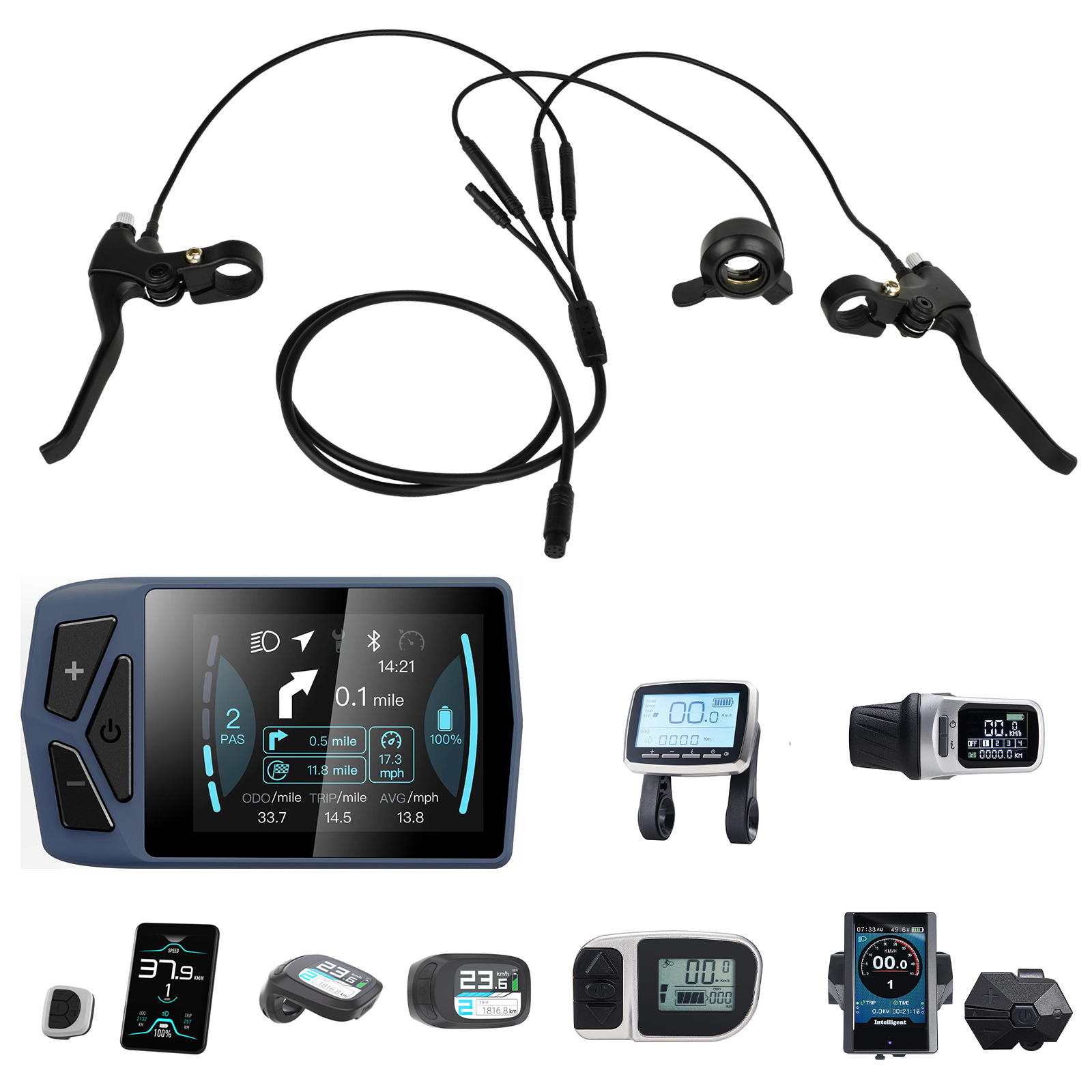

-for brakes.. magnets on glue are complete crap, so I need new brake levers:
-for gear shift sensor I need(?) shift sendor itself and cable(which connects to one of the cables going to the brake sensors?)

I ordered magnets. I might change display though (VLCD5 is awful), so I might need new sensors. One of reasons why I didn't install them yet.
Ow damn yeah that was the other reason, you need vlcd5 for the brake connectors they aren't on the breakout cable
@astronaut you post a 1 to 2 cable for those brake connectors, but how exactly will you connect those? The breakout cable 2-1 for the speedsensor is speedsensor and lights not brakes, the connector for brake detection is only inside the vlcd5 and you can't splice it from the display connector manually afaik.
Java configurator ->
You need 1T4 cable... I think.
Here you can buy it together with display.
I have 4 cables going from the motor to the handlebars.
2- brakes
1- display
1- throttle
I thought I could connect the 1 -> 2 plug to one of the "brake cables", and one end would go to the brakes, and the other to the - "shifter-sensor" (you could even install it somewhere at the beginning of the frame, where the cable comes from the right shifter), so from 2 brake cables I make 3 cables: 2 for brakes and 1 for shifter.
(but, as I wrote above, even if it works - I won't install it because I really always reduce the force to almost zero when I shift gears)
But with brakes, this is not the case. I often stand on the pedals "on the brakes", I often modulate the brakes before I have time to stop pedaling, etc.

The double sided tape that came with the kit is garbage does not stick.
I have hydraulic brakes, it's not so convenient with these stickers etc.
I'll be honest - on Tektro auriga there's not even anywhere to glue them, because the cylinder body is rounded, the handle travel is only a few millimeters (the brakes are very sensitive) from 0 to 100%(full wheel lock).
And in machanical case - everything is easier x10, because mechanical brake levers cost a penny... and you don't have to play with stickers and magnets. but - it's up to everyone to decide what they like.
Wife's bike - on Shimano BR-M375 (one of the best budget mechanical disc brakes) - I will change the levers to the levers with the buid-in sensors for sure
I have an old buget Tektro auriga comp brakes.
I'm sure that the ones I posted above - will definitely be no worse than them.
And as for the magnet stickers, glue etc....back when I was into car repair in my early youth in a "garage cooperative", the guys and I called it "rural tuning")) (tuning in the style of the movie Mad Max, or rusian ladas)
Ow I have quite basic entry level Shimano's, but I am really used to how they feel. Just as with my shifter, when I 'upgraded' my rd and cassette I bought the cheapest 10x set and put it on the bike ( old rd was crap ).. I rode it like that for a very short time, I hated the new shifter because it doesn't allow multi direction downshifts. So I did some more reading and turns out my Shimano deore shifter has the same pull as L-twoo's rd. So now I got my Shimano shifter back on, it's so much nicer it's also exactly where I want it to be and not have to reach for it trying to press it with my thumb.
The magnets probably work pretty well I got no doubt. But they look hideous. I wouldn't mind some nice integrated levers, but they would need to 'feel' close to what I'm used to in progression.
