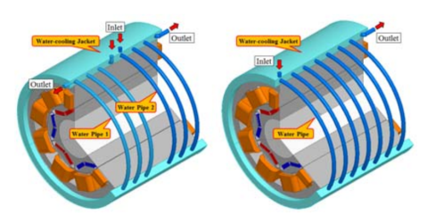

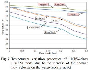

I was reading about water cooling jackets for inrunners and came across the attached paper describing what looks like an extra fancy watercooling jacket for a RC motor.
Looks extremely effective. I'm surprised we can even go so far as to lower the temperature of the inner rotor also, but notice how hard it is to make it budge
What i was thinking with the copper heatsink tubes is to essentially create this jacket inside the motor, but with liquid metal instead of water, for added mass and hopefully improved transfer to the case. This could be more impactful if you ran the coper tubes outside of the case to a heatsink.
That would make an exterior heatsink more effective.

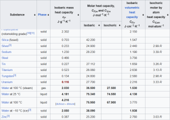

Keep in mind that it's not just about mass, it's also about the specific heat absorption capability of a material before phase change, and if phase change is acceptable within the system, how much energy is absorbed by that phase change.
For instance, with water, you can take in energy up to the point it turns into steam. The energy input before phase change doesn't expand the water significantly, but that phase change to steam expands it by something like a thousand times (which would blow up a sealed cooling system wiht no expansion or venting capability).
With the metal, it would take a lot more energy before it phase changes from liquid to vapor, and you'd never reach that before the system fails from overheating. But it doesn't take very much energy into the metal itself during the operational thermal range of the system, compared to water.

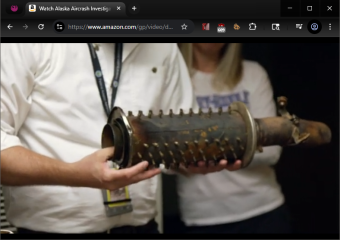

BTW, I was just watching this Alaska Air Crash Investigation,
and they show an engine exhaust heat transfer unit that takes heat from the exhaust and heats cabin air with it. The heat transfer fins are just round pegs spaced apart a fair bit. It's presumably built based on the specific amount of heat an engine in a small single-engine-plane makes vs the amount of heat needed to keep the pilot cabin at a certain temperature given prevailing conditions at altitude in the typical Alaskan environment. If they needed more heat there would probably be more pegs more closely spaced. I don't know the airflow rate from the cabin circulation fan, but expect it to be similar to an automotive one for noise / comfort reasons.

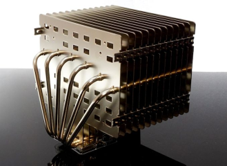

But even in the high end / high performing PC heatsink designs we see the use of what looks like water pipes all over the place. Even though we're disadvantaged by using what looks like aluminum instead of copper, the heat pipe seems to work. On the other hand, two fans is probably doing most the work.
Here is a high end noctua passive cooler. Those heat pipes are doing a lot of the work and we're brute forcing the task with metal.
This is a good demonstration of how much extra volume metal you need versus using fans, the typical heatsink + fan combination is half or third of the metal.
I do like the idea of going fanless and using a bunch of tubes to shuttle heat to a larger surface. No problem to me to add 1lbs of metal to a 4lbs ~1.25kw mid drive.

Wikipedia has a table of heat capacities and water has about 3x the capacity of most metals until we hit 100c. That's fine by me.
Table of specific heat capacities - Wikipedia
