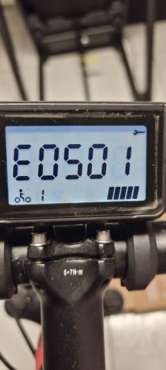

I own an EasyBike EASYSPORT M16-D9 (2017) e-MTB equipped with a TranzX M16 mid-drive system.
Unfortunately, the original TranzX DP16 display was stolen.
I purchased a used DP16 display, but since installing it I am experiencing the following issues:
According to TranzX documentation, E0501 indicates a speed sensor issue.
However, the speed sensor has been tested and is working correctly:
The magnet is correctly positioned and at the proper distance.
I therefore suspect a firmware / compatibility issue between the display and the motor controller, as the replacement DP16 did not come from the same bike model.
I have read that in some cases, replacing the display may require initialization or pairing via TranzX LogiX software.
Has anyone experienced this with a TranzX M16 system?
Is display–motor reinitialization actually possible?
Or does the display have to come from the exact same bike model / firmware generation?
Any help or technical insight would be greatly appreciated.
- When connecting the battery, I immediately get error E56Fb
- The display then boots normally
- Electric assistance works intermittently (1–2 s ON / 1–2 s OFF)
- Speed always remains at 0 km/h
- After a short time, error E0501 appears
- continuity (short circuit) when the magnet is close
- open circuit otherwise
- wiring checked, no broken cables
Thank you in advance.
