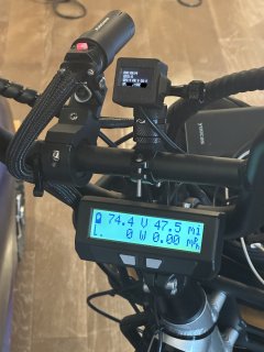

All mounted up with a little 3d printed case that has some rudimentary gopro style mounts.
I imagine, if you wanted to go a bit further, you could replace the CA screen with something like this. But it's getting a bit "out there" to go so far.
