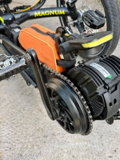

Think I will reflash the EKD01 display before I ride again, and going to install the 44T chainring. Do have a 46T coming in. Had a 46T on the previous M625 cadence motor.
Seems with each upgrade I gain 2 MPH more before the motor's clutch disengages... and there's nothing felt with the pedals until the speed drops or I go up an incline of some sort. Downhill, don't have any power on/with the pedals.
42T with NuVinci n380 gave me 10 MPH before clutch disengaged.
42T with 11/34 9 speed cassette gave me 12 1/2 to 13 MPH before the clutch poofed on me.
44T with 11/34 9 speed cassette gave me 16 MPH before the clutch started to feel feathery, and by 17 MPH I had nothing to pedal with/against until speed dropped.
Rotated the motor up against the front derailleur and used the two brackets that came with the motor, along with two spacers, a nylock, and an 6mm bolt to fashion a brace that actually worked. 😲
Throttle's new maximum speed is 28 MPH

The vendor thinks I would be better off with a 50+ toothed chainring. I cannot imagine pedaling on rolling hills, or 3% grades with such a beast. THink my leg muscles wold snap!
Does any other recumbent rider/triker use a 50T to 56T chainring?!?

Surprisingly the TSDZ16 did exceptionally well going up the hill on the return. 10+ MPH in Mode 5, gear 5. Crested in 7th.
Similar issues that I had with the 44T. Varies on how I pedal. Discovered a new-to-me technique for recumbent trikes.
  • Plodding along can lose drivetrain resistance as low as 15.8 MPH. If i get aggressive can hit 18 before it gets mushy.
  • If I hammer it on the perspective like I am on a MTB, although slightly on an angle, and mash down thrustfully ((maybe add some pulling on the return (SPD secret)) I can get to 20+ WITH A LOT OF WORK being laid back.
  • Did manage to hit 21 MPH on Mode 3. Cannot use Mode 4 or 5 as it revs up the RPMs too fast on the TSDZ16.
  • Mode 4 is iffy on its assist, and mode 5 will top me out fast on RPMs. Mode 5 for climbing hills. 4 Is okay on flats if I pedal more like a bike than a trike, in and out, not engaging all fully around the chainring.
  • If I want to take it easy and plod along, Mode 1 to 3 is fine, middle cassette gear spins out at 15 MPH.
Overall I think the 44T covers it well on a recumbent trike that does take on some hills.
If all out flat, maybe a 52T if you can find one. Was barely able to find a 46T offset chainring. Not finding anything with more teeth.

Was trying to locate a 50T chainring for the TSDZ16, just not found anything past the 48T that really takes a lot of humping to get to 20 MPH. Would like to attain 20 MPH without a lot of strenuous effort.
Not looking to be a speed demon. It is mostly the flats is where this motor lacks oomph. Unless there is some sort of grade it falls short on support when riding laid back.
