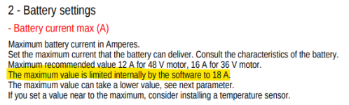

Humble question - what is the real amperes limit of TSDZ8?
My EKD01 on ori firmware displays over 1500W at max with fully charged 48V battery which gives 1500W/54V =~27,5A.
Default is 23A, Ichecked Ekd01 with an ammeter and the power displayed on Ekd01 is about 25-30% higher than the actual power from the ammeter, so if it displayed 1500, you had about 1100W
Did you tested this with OSF also?
In Java Configurator manual it's stated:
and I don't know if the value of 18 A is hardcoded into firmware itself and if it does apply also to the @mstrens OSF variant.
