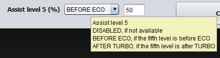

Please be aware that when using the EKD01 you have to use "BEFORE ECO" in order to have the correct power assist level order. I confused this setting until i checked the code yesterday and then changed my config.Thanks for the answer.

If you are using "AFTER TURBO" your assist levels will look like this:
