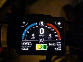

In OSF,I forgot to say I saw two errors on VLCD5 display: 07 and 02.
Error 02 = error in torque sensor = torque sensor provides values that are out of normal range
Error 07 = battery over current.
On my controller I also get abnormal value for torque sensor. It does not mean that the sensor itself is defect. It is most likely the controller that is not able anymore to drive it properly.
I am afraid that you controller died.
The best way to be sure is to upload one of the original firmware.
