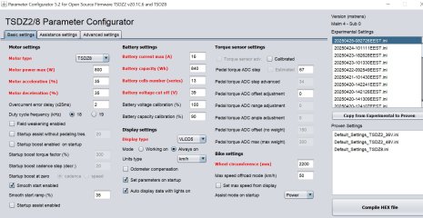

Thanks for the feed back.
Note : in the configurator, you use the default setup for the torque sensor. It supposes that the max ADC torque is 300.
In fact, another user reported that the max ADC torque was higher for the TSDZ8. It was 450 if I remember wel.
Increasing the max value will probably make the motor a little less reactive/sensitive

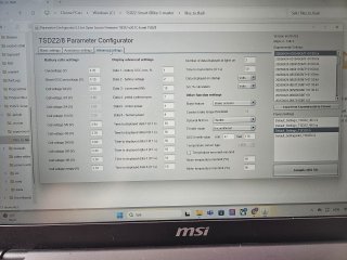

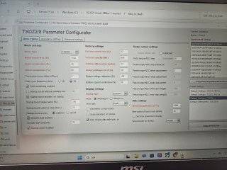

I tested various foc settings (14,22,30) acc dec and modes on the bike. In Cadence mode everything works quite smoothly but in tsdz8, rather few people want to ride on Pas;My conclusions for now (I rode about 20km on various settings so it's rather not much) changing only Foc 14/22/30, from acc dec 35/35 pwr mode, there is noticeable although much smaller jerking that was on older versions at all foc levels, and it's hard for me to say which foc was the best.
However, when I increased acc to 45-55 (although this setting is less important and could even be 35) and significantly increasing dec first to 70 and now to 80, the bike works the best for now on a higher Foc (30) in my subjective opinion. With dec80 22A 1100W, starrboost, field weakning in pwr mode it runs quite smoothly with almost imperceptible jerking also on climbs. I will test more and let you know, if you want MStrens I can check other Foc values. I will let you know soon how the energy consumption is on individual Foc, on 14 it was similar to the test version 3.0.
