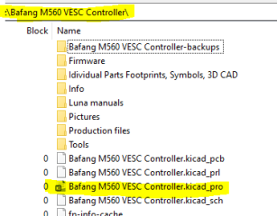

The archive with the current versions of the motor controller files (KiCAD version 9.0.0), Gerber files and firmware files can be downloaded here (updated on 2025-11-24)
[ trademark infringing archive removed ]
[ trademark infringing image removed ]
The archive file with Gerbers for PCB ordering
The KiCAD project file location
The latest firmware file location
The thermal pad cutting template file location

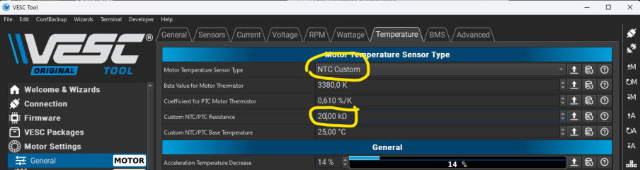

The VESC tool has the "NTC Custom" option, you can set all details yourself. So no need to compile your own firmware
Holy cow! It works! You are right!
I just connected the controller PCB with USB to the computer, launched the VESC Tool application on the computer, connected the controller in the VESC Tool application and adjusted the settings in the "Motor Settings"-->"General"-->"Temperature" menu and uploaded it to the controller.
Here are the correct settings for the Bafang M560 temperature sensor
At room temperature
After warming in the dryer
So we do not need to change anything in the temperature sensor circuit or firmware!

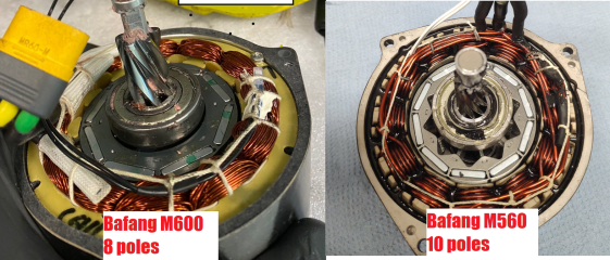

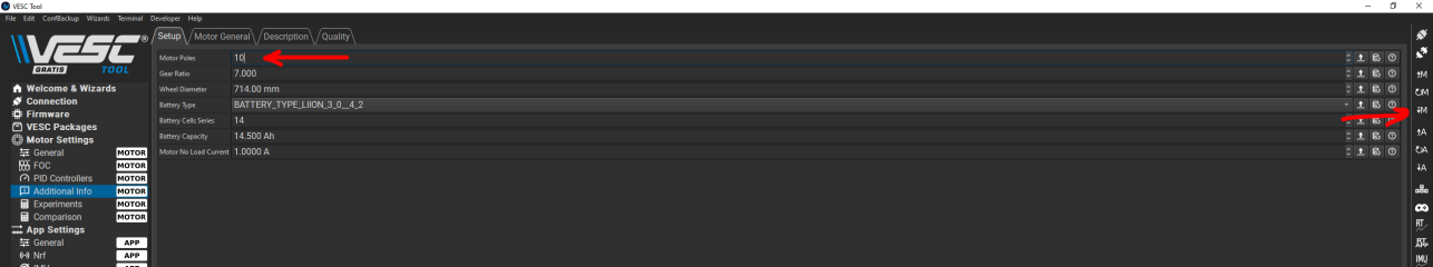

OK guys, we got another problem. I just realized Bafang M600 and M560 have different amount of poles of the rotor. Bafang M600 has 8 poles, but Bafang M560 has 10 poles.
I attached Luna M600 controller on the M560 motor, calibrated the rotary encoder (it looks like the rotary encoder calibration went OK), but it does not spin (it just jerked a little at the beginning when I actuated the throttle and then it stopped with buzzing sound. And after this it just makes buzzing sound when I push the throttle but does not spin. I also can see on the gauges the amperage rises when I push the throttle).
Anyone knows how to setup the controller with the VESC Tool for this motor (preferably with the mobile application on the phone) without messing other settings up (I tried to setup the motor and it looks like it messed all the functions, like encoder does not calibrate anymore after this, all sorts of errors on the display, no reaction on the throttle, I am sure the torque sensor does not work too after this).
And I guess it is not just simply changing the poles in the VESC Tool, I am sure other parameters should be adjusted too, but how?
This is what the VESC Tool reads from the Luna M600 controller by default. But M560 motor is different (different amount of magnets/poles, different windings, different wires).
I flashed the Luna M600 firmware back, connected with USB, launched VESC Tool and set 10 poles. But it does not work anyway (same way as with 8 poles making buzzing sound and does not spin). How do I make it works?
OK, I connected it with USB to computer and used VESC Tool to set 10 poles and detect FOC. Id does not rotate in "Encoder" mode. But If I set it to "Sensorless" it does spin. Encoder calibration does not help. How do I fix it? We need the encoder.

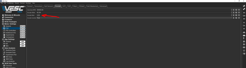

Here are the encoder settings. Should I change it somehow? Is it somehow paired with amount of poles?
I think we did it guys! Luna M600 works with encoder now on the Bafang M560 motor!
It turned out the encoder calibration did not work properly through the Luna interface or something. I wen to the FOC-->Encoder menu in the VESC Tool and calibrated the encoder there and now it works!
Now we know it works so we can proceed with designing the controller for M560 motor.
What is the setting now? Which parameters have changed in the tabs "General-->Sensors" and "FOC-->Encoder" ?
Here are the General-->Sensors settings. I did not change them, those are default from Luna
Here are the current FOC-->Encoder settings. It looks like only Encoder Ratio changed. It was 4 from Luna and it did not work. After executing Encoder detection through the VESC Tool menu the VESC Tool set it to 5 and now it works

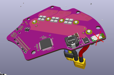

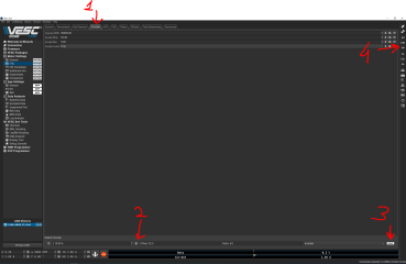

More great news! I figured out how to make the VESC Express work with the Luna M600 controller!
It it turned out all I needed to do is set the VESC Express dongle Baud Rate to 250K.
I can not believe Marcos refused to tell me such simple little thing. Those VESC guys are such petty folk it is unbelievable!
Anyway, we finally made it works guys! So we do not need the USB and the integrated Bluetooth on the PCB anymore!

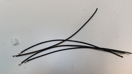

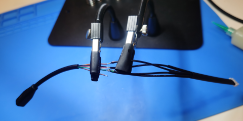

In order to make to make the VESC Express dongle works you have to make a cable to connect CANH, CANL, +5V and GND pins from a motor case connector to VESC Express dongle (you can use the purple connector in the motor case because it is used for brakes and shift sensor and it is quite useless feature so you can occupy that connector with VESC Express dongle).
You will need this plug (the purple 6 pin Female)
You will also need 2 of JST jumper wires part number ASPHSPH24K305
You will also need 1 of JST connector housing part nubmer PHR-4
Cut the JST jumper wires on 2 pieces each and assemble them ito the JST plug
Strip the purple 6 pins plug connector wires and solder them to thee JST plug wires making sure when you connect JST plug to the VESC Esxpress and the 6 pins urple plug to the motor housing connector CANH, CANL, +5V and GND are maching

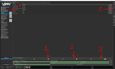

Connect the VESC Express to the motor and to computer with USB cable (you also can use Makerbase VESC EXPRESS, it is cheaper and has Bluetooth in addition to USB and WiFi and also it can take power from USB. So it is basically way better than VESC Express).
Open the VESC Tool application and connect the VESC Express. Click "VESC Express", set baud rate to 250K, click "Write" in the bottom menu, click "Scan CAN"
And there you have it! Now you can work with the controller and have nice external USB, WiFi and Bluetooth connection!
I already found a good spot for the integrated Bluetooth module but I guess we do not need this mess anymore

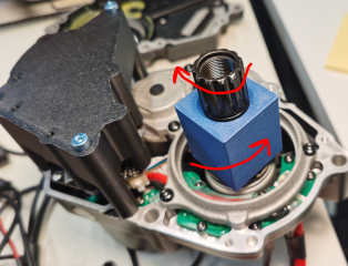

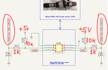

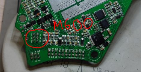

OK guys, we have some real problems. It looks like the torque sensor from Bafang M560RS (and probably regular M560 torque sensor) does not work with Luna M600 controller.
I 3D printed an adapter to apply torque and rotate the torque sensor shaft at the same time and it did not spin the motor. I tried all combinations of torque direction and rotation direction and nothing works. I also tried to calibrate the torque sensor through the Luna interface in the VESC Tool application and it did not work too.
Is there any way to make the PAS/Torque sensor works with VESC Tool?
It looks like the torque sensor on Bafang M560RS is not connected to CAN transceiver chip while M600 torque sensor is connected to CAN transceiver chip. We need to figure out if M600, M560 and M560RS are different torque sensors generate different signals and require different connection. I already can tell for sure M600 and M560RS torque sensors are not compatible. Now we need to figure out if M600 and M560 (not RS) torque sensors are different or not.
If anyone has regular M560 (not RS) controller laying around can you please check continuity with multimeter between these pins (those pins are CANL and CANH and M560RS controller has no continuity between those pins on the torque sensor connector and on the can transceiver chip).

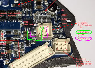

I checked the connection to MCU and It might be the M560RS torque sensor works similar to Bafang M620 UART torque sensor. Two pins are connected through some resistors circuits and look somewhat close to Innotrace controller circuits (not exactly similar thought. It looks like those pins are LJ pin (Torque) and DS pin (Rotation/Direction) just like on Bafang M620 UART Torque sensor,
It looks like there are at least two versions of M600/M500 torque sensors with different pinout, CANbus and Not CANbus and Luna designed it for CANbus version. The Bafang M560RS torque sensor looks somewhat close to Not CANbus version.
I am not sure if this picture below is M600 or M560 controller but the pinouts of the torque sensor is close to Bafang M620 UART.

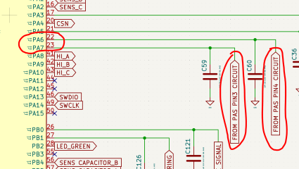

Is there any way to tell how the Luna M600 firmware uses the signals from the pins 22 and 23 of the MCU looking on that VESC page on the Github?
Those pins are connected to the torque sensor through some resistors and 5V circuits (maybe the torque sensor changes resistance between those pins and ground so it works like voltage dividers and the firmware process it like torque and cadence values depending on the voltage?). And how the Luna M600 firmware uses CANH and CANL signals from the torque sensor?
PA6 and PA7 are the Quadrature PAS input pins. You can get the crank rotation direction and the candence from them.
But the function hw_get_PAS_torque does not use it, it just calls the function luna_canbus_get_PAS_torque , that returns luna_settings.torque_sensor_output that is extracted from the CAN bus message. The cadence, that is also included in the CAN message, seems not to be used by the Luna firmware, why ever.
The candence is still read from the PAS pins PA6 and PA7.
