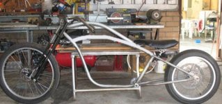

Good mate Noeeeel...came by this morning picked me and the 10 inch "V" Pulley
up to take to his workplace (Modified Vehicle Systems) to turn it down on the Metal Lathe.
As always, pictures of the whole process were taken for your
viewing pleasure-->
Pictures a pretty self explanatory i think? the sides were first removed, before a 15.5mm 'flat'
surface was created for the belt, the center was then turned to allow fitting of the 3speed hub
sprocket (see below pics of Matt's completed pulley)
Extremely pleased how the pulley has turned out, HUGE thanks
to Noel for his time and to the boss of MVS for the use of the workshop/Lathe.
As mentioned in the work log before epoxy teeth will now be added to the pulley in the
same manner as Matt (1000watt) has done on his 10in Pulley i.e-->
I shall borrow Matts 'cut' belt... if the pulley needs additional material
removed so as the belt teeth spacing is accurate this isn't a problem, bulk of the
turning has already been completed another 0.5mm can be taken off the circumference
if need be....
Back soon folks :)
KiM
p.s i will be financial enough to buy theExtra Wide Sturmey Archer 3 speed hub from ChoppersUS this week i have decided to do this straight
up rather than use a trike hub initially, this will cause some delays in the progress but i figure do it now or
it might not be done at all down the track as ill be having to much fun riding it about LoL..

I have altered the springer tube to lower the front ride height and im
rapt with the way the bike sits now, less "chopper" more "pro-stock/cruiser" look to it
I like it, that's exactly the look I'm going for on mine :)

I wish! Spent a few hours though and made a good start on mounting the reduction drive
unfortunately it is after closer inspection a tad too large to mount on the seat tube
but i had allowed for this hence the "stretched" rear end :: wink::
First i need to make a mount to bolt the redcution drive to using the 4 provided mounting
holes on the drive itself, this is how i have decided to go about it-->
(yes the threaded shaft on the motor will be lopped off so nothing will be protruding outside of the frame :) )
I think the pictures are pretty self explanatory? The metal rule's in the last pics will obviously be replaced
by tubing, the drive will be sideways adjustable to allow for correct belt alignment.. VERY
happy with how it fits neatly into the space in front of the front wheel, looks too good for the rest
of the bike though, needs some colour on the frame to pretty it up some hahaa
Back tomorrow with a fully mounted reduction drive and motor :)
KiM

the the square tube has a wall thickness of 2mm matey, i plan to also have a
square "mounting" plate welded to the base of this making it 4mm all up with 2mm sides, i
think this will be more than adequate seeing the bracket is bolted top and
bottom and only 40mm in height, can't see it flexing IF it does, ill simply brace it internally...
