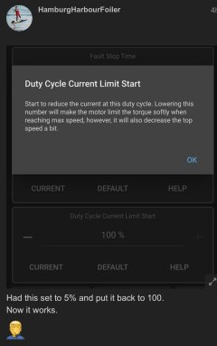

why would the esc only put out 55amps when I go full throttle up a hill when it’s set to as high as 200 motor amps and 140 battery?
Hmm interesting and I’ll see if that does it. Nice find.
