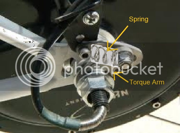

So I had some new ideas about having a torsional spring to protect the gearmotor from shock loading. Inspired by the EVworkslab.com non-flat torque arm and Amberwolf's idea of using a leaf spring.
So I would have a torque arm spring cut in 304 stainless steel, in a similar shape to the non-flat EVW torque arm(see pics below).
The original EVW TAs are 5/16 thick A36 steel, and recommended for sub 2500W builds. He also reported some FEA results:

Now all this means that the axle will have to rotate inside the frame. So basically I will have a new set of greased bearings where my dropouts used to be.
My frame would now have 16mm round holes where the dropouts used to be, my motor axle has 14mm(major dia.) threads.
I will machine a collar to slip onto the threaded axle to pick up the radial loads. I will have washers on either side of the frame to allow the axle to twist. The whole thing will be packed with grease, and maybe shielded from the elements.
Heres a sort of exploded diagram of the bearing between the motor axle and frame(plus the torque arm spring, thing, allowing the axle to twist a bit):
But how thin to make the leaf spring... The motor is an oil cooled MAC 12-turn at 72V and 30-40A.
Will I need to perform FEA? Or would 1/2 the thickness(as drawn in the second drawing) of the original TA work? or 1/3 or 1/4 the thickness...

The problem you are trying to address is gear misalignment due to shaft flex. Floating the axle will only make this worse.

The axle will only be floating in a rotational sense... the axle nuts will still be as tight or tighter than normal and there will be lots of washers/spacers to stiffen the system otherwise.
When landing from a jump the loading of the gears can't help, in addition to axle flex. Also, upon landing, axle flex would be exaccerbated by torque from the motor... have people broken gears doing jumps with the motor off? (no motor torque)

Heres a new design. I could use two TAs, one each side, or make it thicker. Not sure what material to use, I was going to use some sort of Stainless steel, but maybe if I can find some I'll use some type of spring steel
In Solidworks I managed to do some stress analysis, not in an ideal way though. I couldn't figure out how to simulate torque. Also I don't know how to give it a fixed position allowing only rotation(for the part the motor axle goes in).
