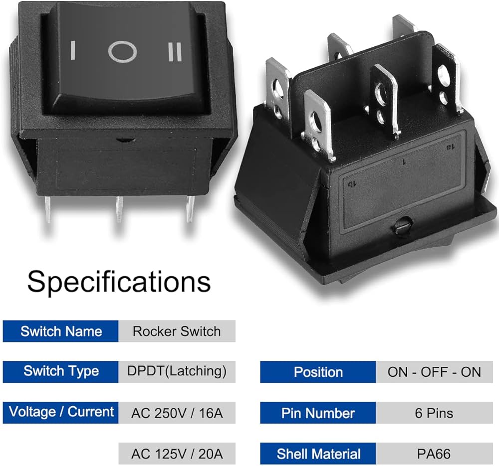

Just rando amazon parts. Yes sir, that harness does include the display. My controller doesn't have a display dongle, so not all display features are available to me, but I do have the indicator light LEDs. The speed mode LEDs don't seem to have any reasonable solution to make them work. I can make the LEDs light up, but making them show which speed mode it's in will require something pretty elaborate. Making NML and SPT would be relatively easy but making MID light up would be complicated. I think ultimately it would require some kind of board and someone with actual programming skills. I think I'll be able to just live without them lol. Some of the LEDs are also not needed in my jurisdiction, like the position light, we don't have those here. I'm thinking about repurposing some of that for maybe hazard lights or something.
What are you using for you 3 speed switch now? (Couldn’t see it in the pics). If you replace the single pole with a double pole version, then you can use the second pole to send 12v to the high and low speeds, which is probably simplest.
I'm just using the cheap generic 3 speed handlebar switches off amazon.
The thing I'm not able to wrap my mind around is how I would make NML light up because in normal mode there's no connection being made. So like in high speed, the 5v wire is connected to the ground, in low it's the 0v wire connected to ground, and no wire connected to ground means normal. As far as I can tell, the ground on the 3 speed dongle is just a neutral wire.

8 pin, 3 position, double pole slide switch would work. Switched ground on one pole, switched 12v on the other pole.
