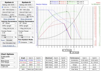

If you have the model of your controller, or if post a pic of your controller label, it would help to determine whether you can up the voltage with your existing unit. You can predict that your speed will increase by about 13/10, or 30 percent. The ratio is based on the number of cells in series to make a 36v pack, or 10, and a 48v pack, or 13. There will be a torque increase as well.
Not your motor or controller, but just an illustrative example:
The range you get from a pack is based on the energy stored in watt-hours, or Wh. Wh = voltage x Ah, so whether you get and increase or decrease in range can be estimated easily. If your 36V battery is rated at 14Ah for instance, and your new 48V battery is rated at 17Ah, then the original battery has 36x14 watt-hours of energy, and the new battery 48x17 watt-hours. Or, 540Wh and 816Wh, respectively. In this example the range increase is approximately 51%.
