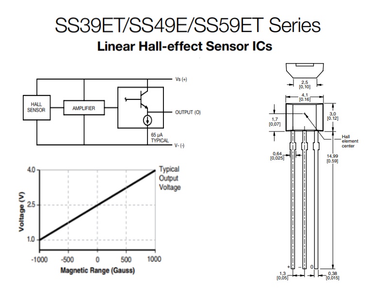

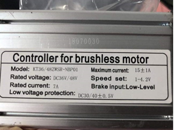

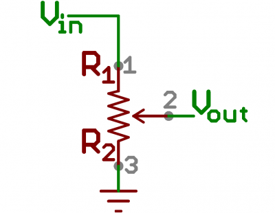

During construction testing I have been using a 10k pot as a speed regulator which needs to be a third of the way before the wheel turned and under load the speed is a bit variable without being adjusted.
Bought a thumb throttle controller and was surprised I could not measure its resistance leading me to believe it is digital unit.

Generally speaking, most Ebike controller throttles fall into two categories.
Hall sensored throttles which I would think you refer to when saying "digital". Electronic may be a bit more accurate, as they put out a "linear" signal output. And is an integrated circuit, with a few other electronic parts included besides the actual hall sensor itself.
And potentiometer type throttles, such as what you had used.
For more detailed information on these two types of throttles, see this thread...
Guide to Hall Sensor Throttle operation, testing, and modification. - Electricbike.com Ebike Forum
As always, there are exceptions... An Arduino programmed signal PWM output for one.
Have I just been luckily using a resistive device on a digital controller that worked
As each type of throttle, outputs a different signal voltage level, this would seem to be true.
Depending on the controller, it may require one type or the other. Or may be programmable to except either, or a specific throttle signal input voltage.
Example of a hall sensor throttle controller expecting 1-4.2V "Speed Set"...
This thread discusses obstacles that may be run across with different throttle signal voltage inputs, and the controller's responses to them.
Using an On/Off-Momentary Push Button Switch that’s normally open to replace a hall throttle.
It's the variable speed with no change of input that sounds problematic to me...

Thanks for a very clear steer, the Guide to Hall Sensor Throttle operation, testing, and modification.
i
s excellent and I hope over the next week or so to apply it and identify my controller and thumb throttle and will report back of the outcome.
I only need walking speed so the information to set the start and wot will provide that.
