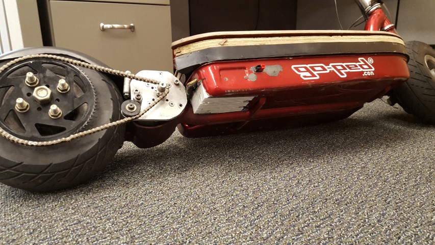

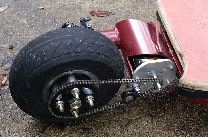

When I started this, my chain was slack, but seemed usable.. it started skipping off though, so I fit the chain tensioner on it.
Its spring loaded, so it will keep the same tension.
zoomed it pic:

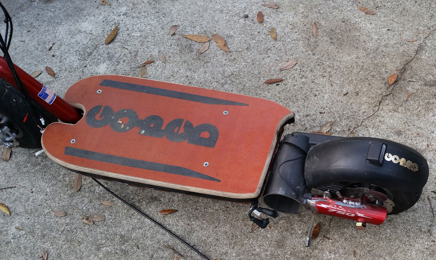

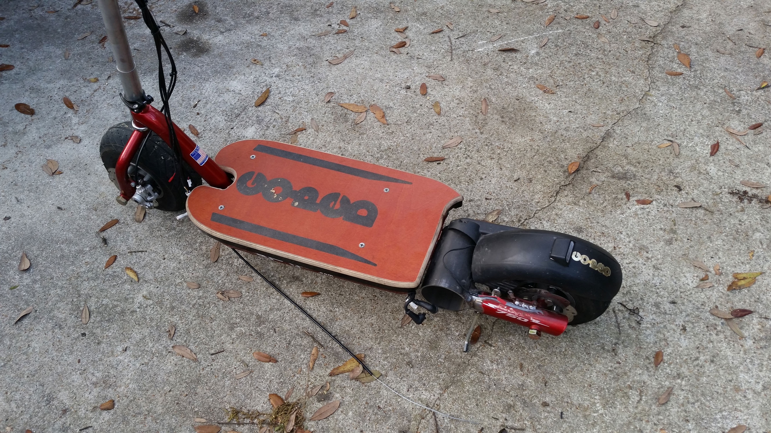

I can try to take some, but its just a brake tab welded to the tube... just like the front fork. What is it exactly you want a pic of?
I just went through my pics... here are two big pics of the tab
EDIT: right click on these pics and select "view image" or similar.... endless sphere clips the side of images that are too big... You could also download then view them.
I got the tab from UpsetChemist here: http://www.billetboard.com/showthread.php/8676-FS-Maddog-Front-Rear-Brake-Tabs-and-Frame-Fillers
I talk a little about it here: http://www.billetboard.com/showthread.php/11256-FTG-questions-What-breaks/page2?highlight=offset
sure. I'll take some pics when I get home, but I'll try to explain it here
you pick the slimmest caliper possible, then shave down the adjusters... then you space the disc as close to the wheel as you can without rubbing the tire when it flexes... then measure/buy longer wheel bolts and shave the wheel bolt heads down. Now you have everything as close as you can.... you space the wheel off to just clear the wheel bolt heads.
Then its like any other caliper mounting. what I did was mount the caliper to the bracket, all centered. then I cranked the inboard pad in a bit, and ran a zip tie through the cable run. I placed it all on the disc until it was exactly where I wanted it, watching were the pad touches, and then tightened the caliper with the zip tie holding it there. two tack welds to hold it in place, double check everything, and if it all looks good, take it all apart and finish weld.

I ditched the "heatsink block" idea for the controller, and I cut a hole in the bottom.. it now has a flush mounted heatsink. It works excellent, however with the cooler weather, I cant tell if it made a big diff. Will have to wait until the middle of summer to know for sure. Its cool now ,53*F (11.6C) according to the internet... but on the way to work, nothing came close to warm.
heres a pic of the new bottom:.. (if you look, you can see the result of running a new chain 3 miles at 40mph and forgetting to lube it. it already has one kinked link.)
I also trimmed off the extra shaft coming out of the fan. I hit my ankle on it a couple times pushing the scooter, and finally decided to cut the thing. Now that its cut, I kind of wish I put the anderson connector on the back, where it used to be.
