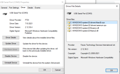

Drivers from QS:
Drivers installed on PC for COM Port 3:

Update: I ended up purchasing a programming cable from Electro & Co. and that did the trick. The programmer looks identical to the original one that I used, so I am not sure what is different. Perhaps the software on the mcu?
Hit up https://www.electroandcompany.com/ if you are running into the same issue.
