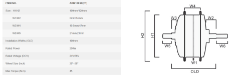

From a wheel build standpoint this version of the Aikema 100SX linked below (which is dish-less with 47mm spacing between center of spoke flanges) is much better than the Bafang G370 (second image below) which has 4.5mm dishing offset and spoke flange spacing of 45mm (measured from center of flange to center of flange):
Bafang G370F (measurements from ebikes.ca spoke calculator):
Why is this important? Because there isn't much difference in weight between motors and it is easier to build a laterally stiff and durable wheel with lighter components using the Aikema hubshell.
