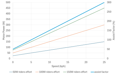

my favorite behavior for commuting is this: a linear increasing assist factor with speed. At low speeds in the crowd of the city, you have a good sensitivity, you can ride any slow speed you like, the higher the speed gets, the more power you get from the motor, so you need only little effort to keep a high speed.
This is quite easy to calculate:
Code:
motor current setpoint = (a*torque*cadence*speed + b*torque*cadence)/speed
So parameters a and b have to be settable by the user.

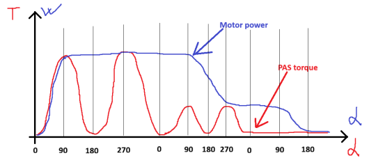

I addition to decay time, there should be decay zone which will be measured in amount of pulses of the PAS rotary encoder. Whichevewer comes first (time or amount of encoder pulses) should command the power reduction.
For instance you do not want to precisely follow the motor power to the torque on the crank because of the torque on the crank in not consistent during one revolution and even goes near to 0 at some position of the crank. Without decay or some smooth algorithm the bicycle power will feel jerky. The higher the power the jerkyer it is going to be. At 4000W of power without decay you have like 4000W at 90 deg of crank arm and 0W at 180 deg of crank arm, and so on each 90 deg fluctuation between 0W and 4000W.
This is how motor power depending on torque should look like. Ideally it should be a graphical interface in the VESC Tool application just like this graph where user can drag the points of the curve and the application will determine the parameters
T is toque on the crank arm
๐œถ is crank arm position angle. The PAS can not determine the angle but the algorithm can use pulses per revolution parameter and peak torque within one revolution or 1/2 revolution or 1/4 revolution to determine the starting point of the decay moment
W is motor power.
The graph shows ๐œถ but not time. When cadence is slow the time should start commanding the decay interval prevailing over the cadence. When cadence is fast the cadence should command the decay interval prevailing over the time.
In the firmware to make it simple it is not necessary should be a mathematical formula, but it can be mapping tables with multiple values the algorithm compares the actual parameters against to determine the motor power.

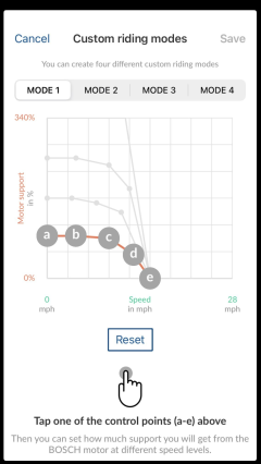

Bosch let you define individual modes by a graphical interface where you can drag points to the wanted position.

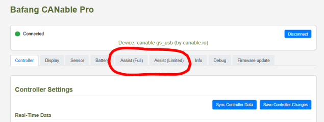

But coming back to the implementation in the OSF. We can use any mask in the Bafang Canable Tool for defining anything we want, especially the Assist tabs have many possibilities, of course.
But how to describe the assist behavior in a table? :unsure:

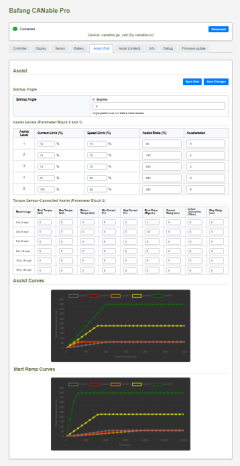

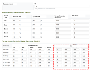

After thinking a little, I will implement it this way:
For each assist level, you can define a specific ride mode:
  • Mode 0: Simple PAS mode like in the "old" BBSxx world. Battery current is controlled, phase current is limited to a global max value
  • Mode 1: Simple PAS mode but motor torque (=phase current) is controlled, battery current is limited to global a max value.
  • Mode 2: Torquesensor mode, assistance is depending on the riders effort. The assist ratio is settable in details for each speed range, like the "Custom Riding Modes" in the Bosch Nyon. The settings for speed and current from the PAS definitions are ignored, only the global limits for speed, phase current and battery current are active.
In all modes, a "torque override" can be activated, so the setpoint calculated in the ride modes will be overwritten by the pure torquesensor value , if it's higher. Similar to a throttle signal. You can define the threshold for this override function individually for each level.
So you can have different ride modes one the same setup.
I would use the Bafang Canable "Assist (Full)" tab in this way:
Of course further suggestion are welcome :)
