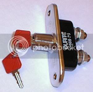

Hi, I've tried looking everywhere for a 36v 30 amp switch, rocker type, or anything of that nature, to kill the power from the battery when the bike's not in use.. I would be happy if I found one, a waterproof one would be even better, but I've had no such luck anywhere on the net.
Does such a switch even exist ???
Has anyone any ideas where to find one online ?

If you look at automotive switches they are usually rated for higher voltage like Doctorbass said. For waterproof you might check out a motorsports / boat shop. Marine switches usually have good brass contacts/ terminals for less corrosion.
They definitely exist, I found lots on my search. Try and find one that is DPDT, now that is the challenge! I'm probably going to make my own. Do a search for a battery disconnect switch, you'll find lots.

I havent installed one yet, but installing a switch is something I have already figured out! You can do a search for "battery isolation switch" You will find tons of them, all kinds of quality and prices, and even Keyed! Oh yes, when theyre on, THEYRE ON! They got single battery versions, double battery versions - bank one OR bank two, and combo versions - bank one OR bank two OR both! And any of them can be gotten with keyed operation as well, in a variety of volatage and amperages to make you quit wondering what youre gonna do! Question will be, which one you gonna use!
Thanks for the help guys, a marine switch I think is the way to go and I've seen a quite a few already online - I just didn't think to look in that direction, but they seem perfect for what I need.
