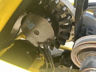

.... I landed upon a bright yellow KMX tadpole. But not just any bright yellow KMX tadpole,. Take note the Astro 3220 tucked behind its seat, and a hellof'a lot of custom hardware. My first thought was Matt. Yes, Matt... so where is Matt these days?
I'm not into tads, but if I could scrape together $2500 bucks, I'd surely own this one.
Interesting. Some of the same approach as me - that large empty space behind the seat was tempting. I suspect my goal is more opposite - I aim for reliability, usability, and load hauling. With a 4Kw motor, I suspect (but don't know) this was designed for speed.
I use a Gates Carbon belt, and I've repurposed an existing hub motor. I've mounted a GMAC, a ShengYi SX2, and an All-Axle in my motor cradle as I experimented. The v3 All-Axle wasn't released yet when I was designing, so I tried what I had while working out the motor cradle design.
...even got some nice heatsink fins on it.
Would probably be fun to drive with a VESC in FOC mode instead of using these old square drive RC controllers that can barely drive those motors without exploding for unknown reasons.

If I can, it's getting a front suspension kit, 16" DOT rims/Mitas MC2 16x2.25" tires on all 3 wheels, new controller, an upgrade to a 20S pack using Molicel P60C cells, and a velomobile body with roll cage around it. I want to keep it easy to pedal with the motor shut off, and freewheeling midrives separate from the pedal system don't have cogging torque losses.
