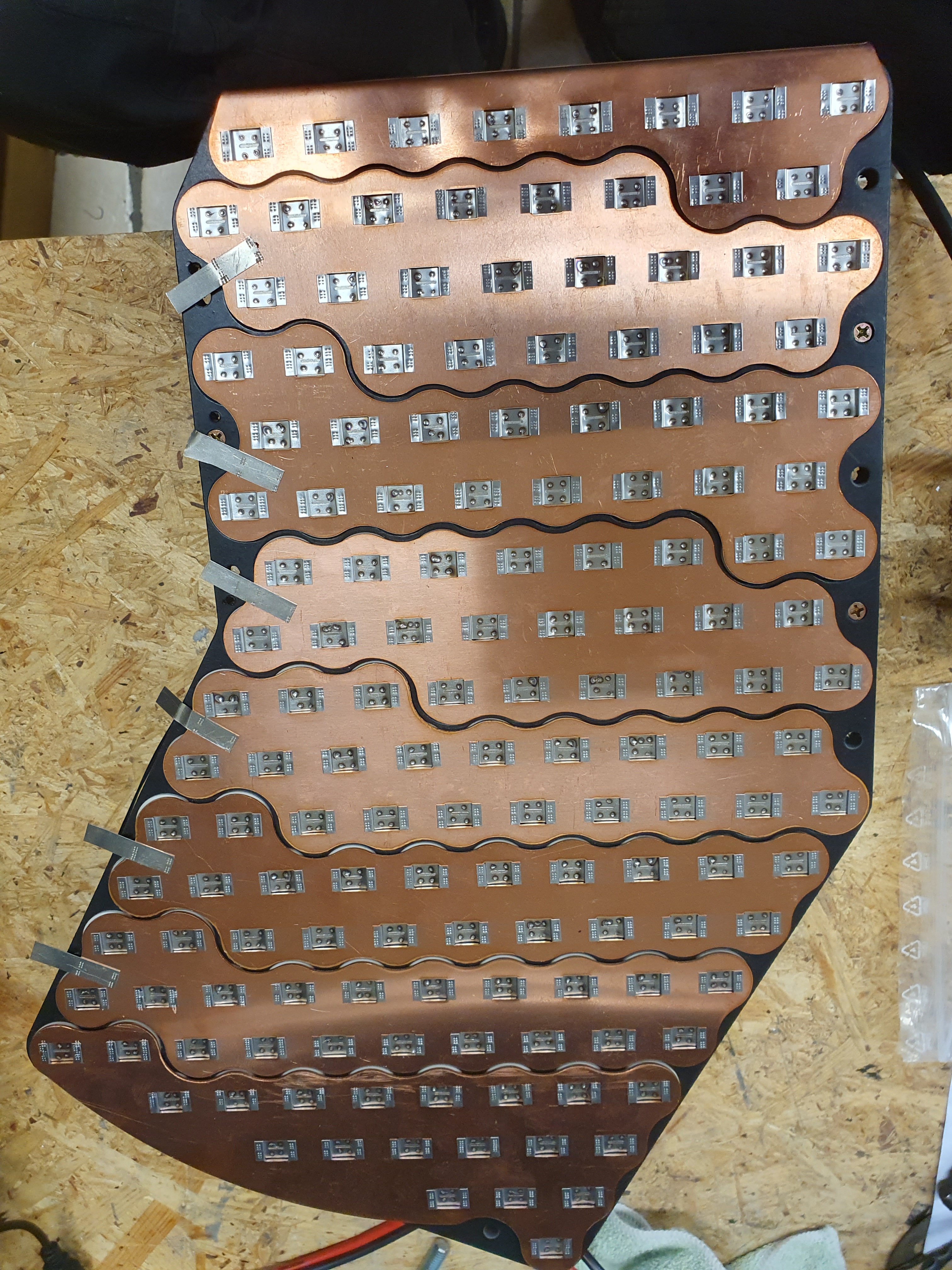

Testing bus bars, everything seems fine, but some of the little tabs for the balance wires will be in the way.

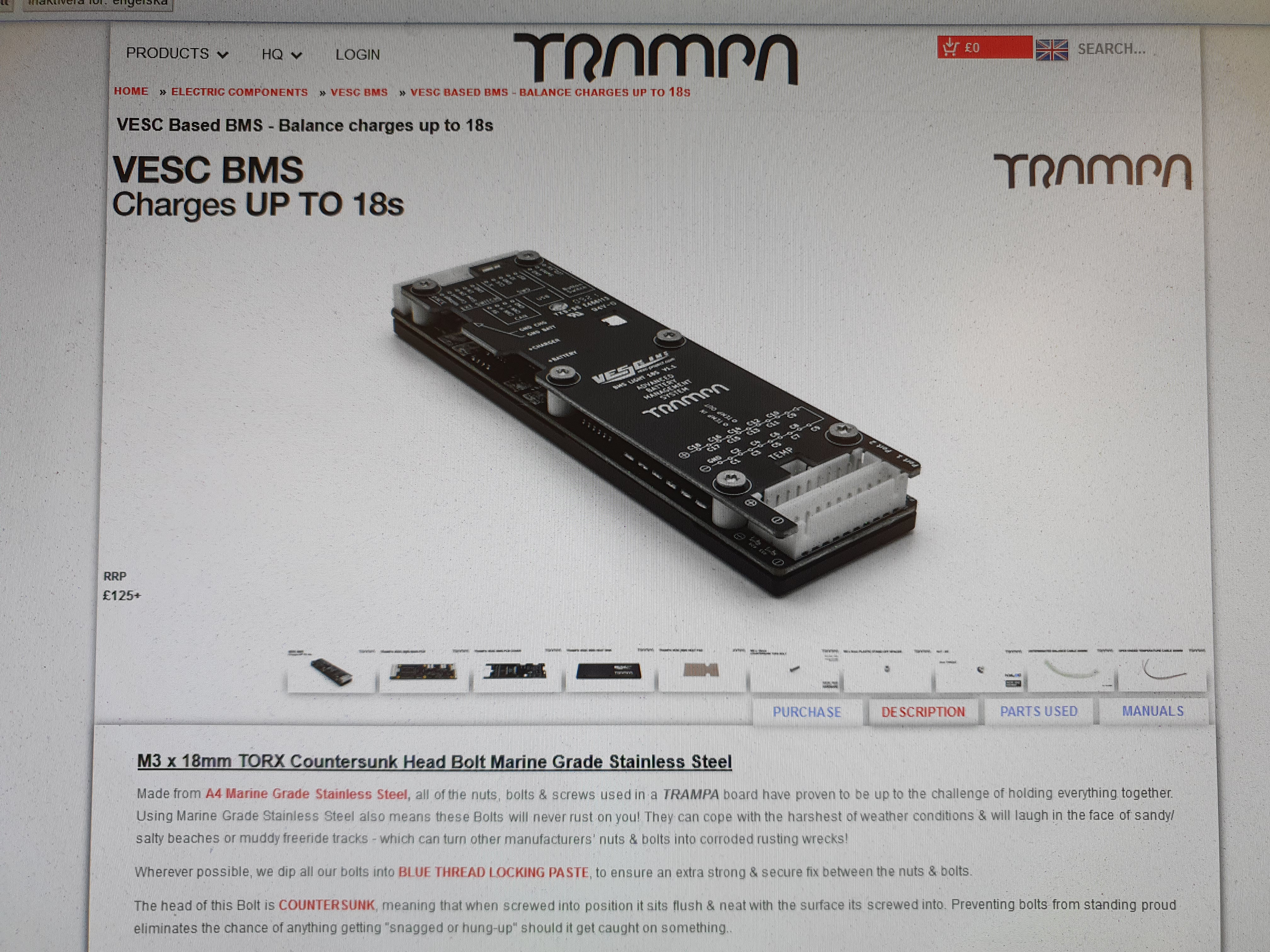

There is the trampa bms:
It is 18s, and I dont see anything about running two in series or something like that, but I know I have seen it done.
12A charging?! 🙁
2 for each battery wont be cheap.

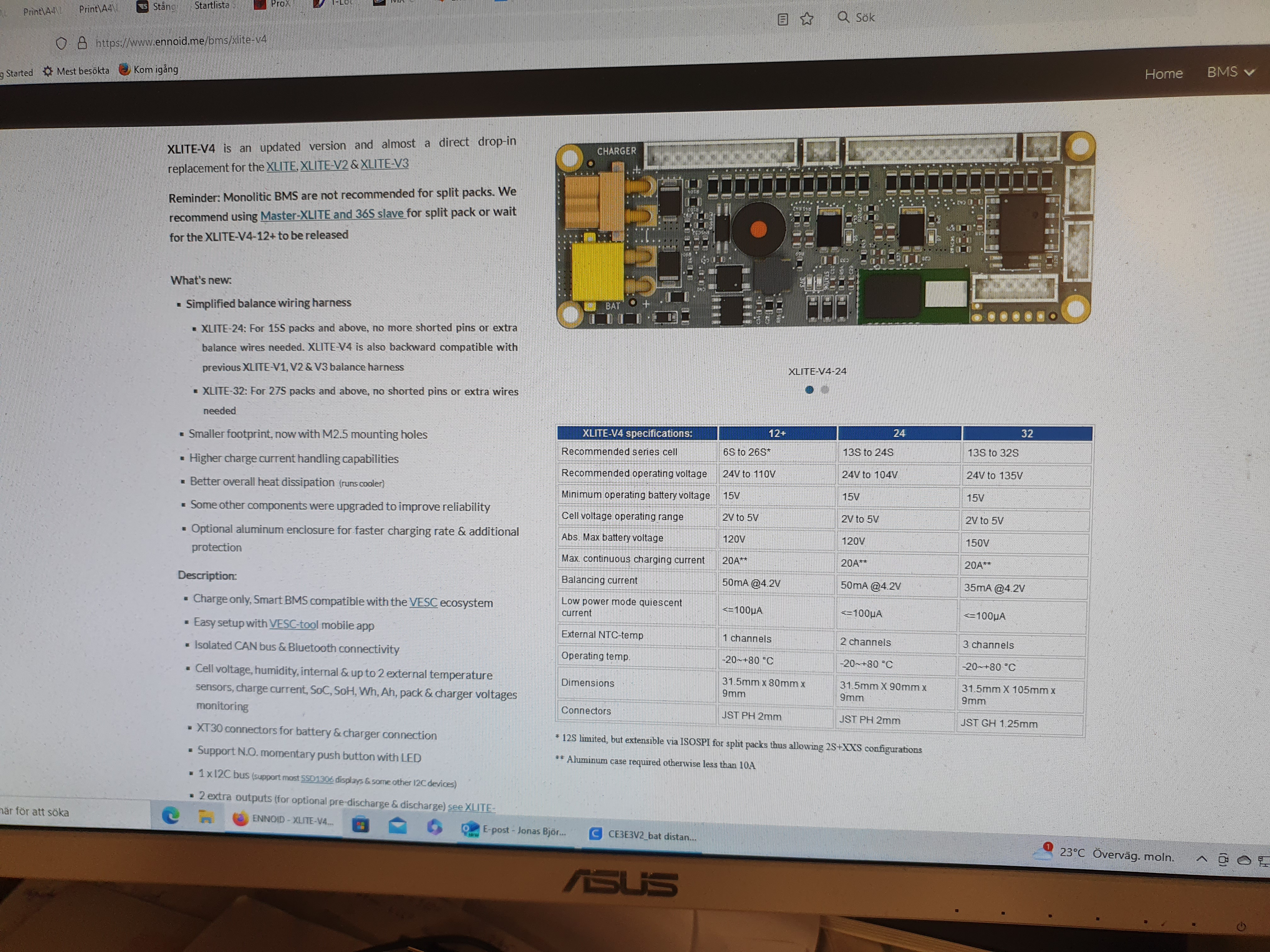

Ennoid XLITE-V4
There is a 32s version, but it says "beta, GH cable set not available yet"
So, beta probably means trouble, not sure what GH cable set means.
Charging 20A with alu cover, didnt see one available on the site.
That is ok for normal charging, but what if I want to charge fast sometimes?
35mA balancing? Lets hope the batteries wont need balancing then, it would take a while..

I would suggest to stay away from Ennoid. So far I have had:
Master bms bricked during first setup
Master bms fried during precharge
Fried 2 slave board.
No I finally have a master and slave that works but it will not allow charging at all.
Using master xlite
Ennoid XLITE-V4
I have one of the V3's (I think) of these and it's...ok. It works just fine, but it doesn't add a ton of value over many other BMS's other than the big, primary advantage that you can bypass power going through a BMS set of mosfets/contactor/etc yet still properly react to parallel group LVC and other common BMS protections. If you have room for a regular BMS that can handle the amp load you want, I'd probably still recommend going that route.

With regards to the SOC, the ennoid LV Master uses the shunt on the negative to measure current. As such it is independent to whether the discharge or charge contactor is open or closed on the positive. If current goes in or out of the battery it is accurately calculated.
Not sure if this is the same as the X-LITE
Thanks, that sounds good. I guess the best is just to ask them if it is the same. I thought it didnt measure discharge and left that to the controller. But then it needs reliable info from the controller, so it is probably better if it has its own shunt.

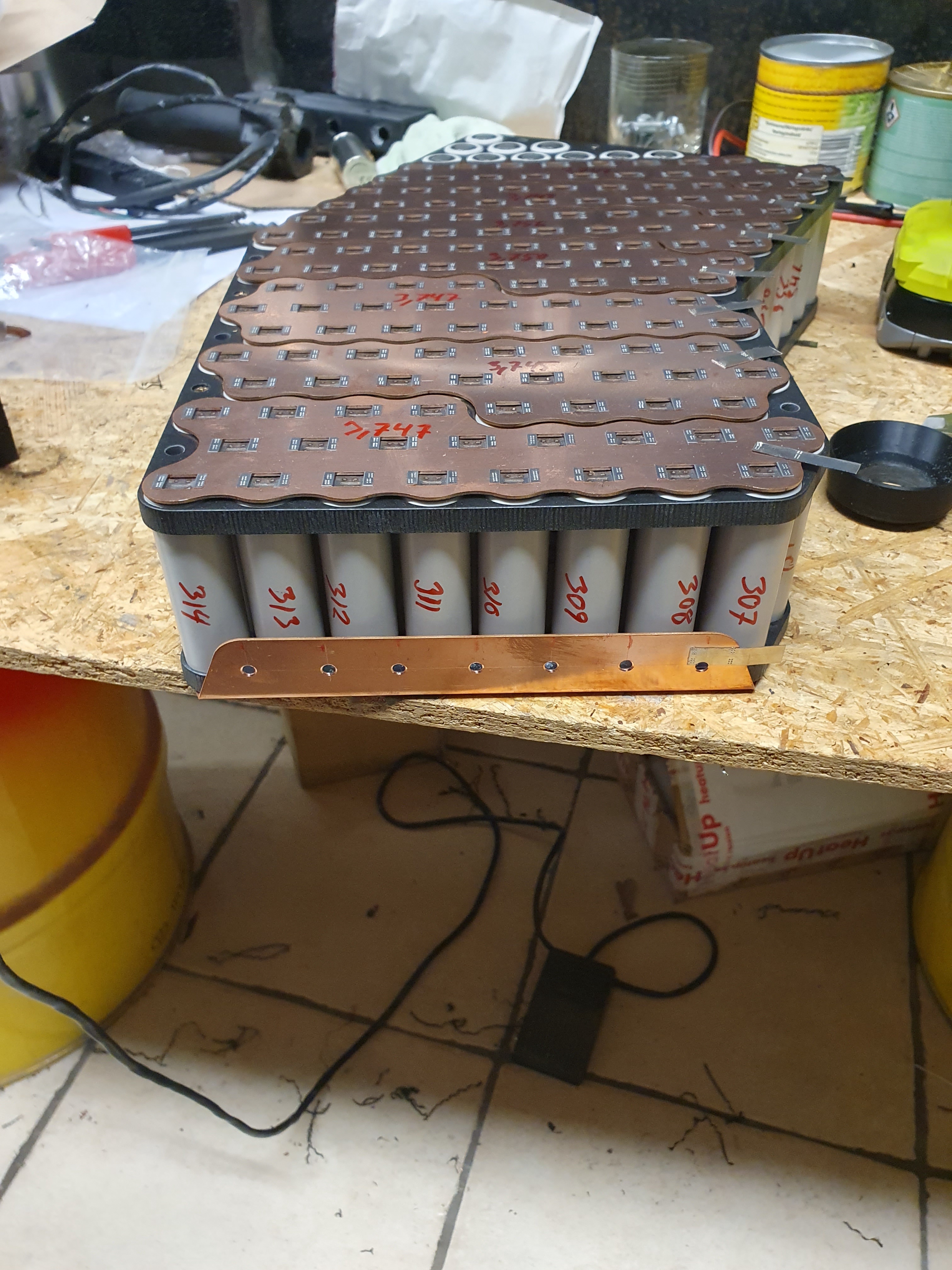

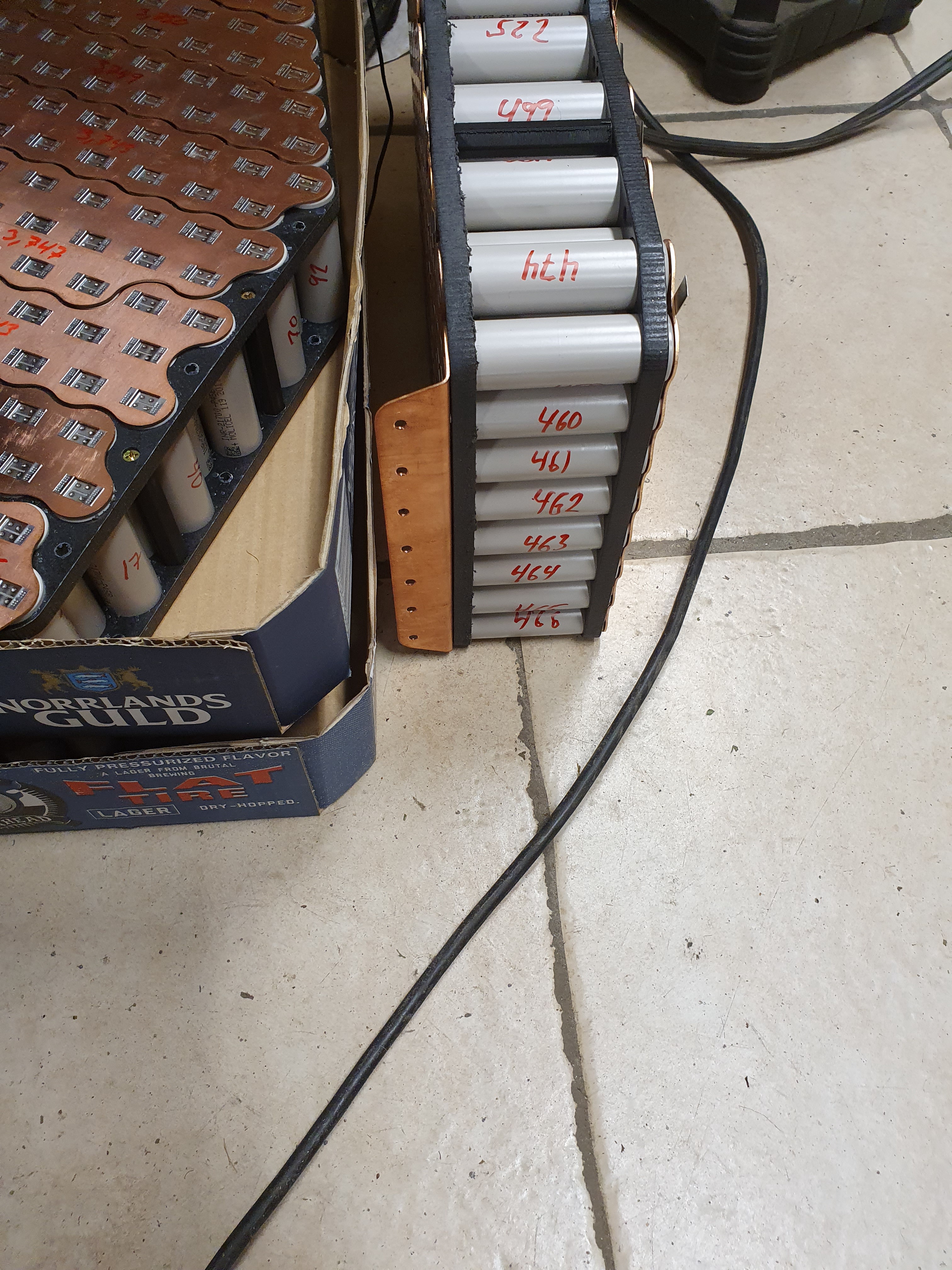

I have been working on the batteries:
I made some separators to mount between the cell holders.
Has done some spotwelding.

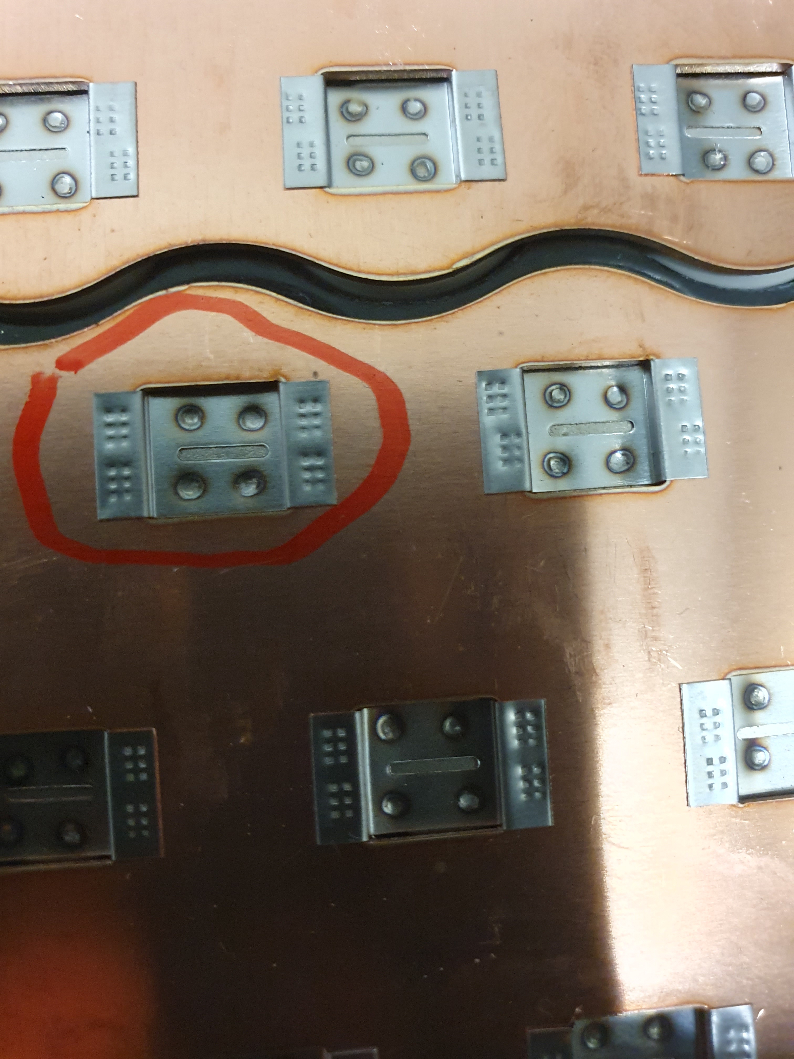

But this worries me. When I did the first weld on this cell i heard a little "hiss" sound. I guess it can be something else, but my first thought was that I punctured the cell. I cant see anything wrong, no moisture or anything. I also went back and did the second weld, I didnt notice anything strange or any sound then.
I have one more just like it in the other battery half I have done so far..
I am welding at 45J with k-weld
I can't see anything from the picture, so it's up to you if you want to disassemble to check. It is possible for a puncture to not leak. For what it's worth, I've found that puncturing the cell is more likely to happen on the negative end rather than the positive end.
Have you ever smelled Li-ion electrolyte? it has a VERY distinctive smell.
Try sniffing closely around the weld, you'll know.
If you want to read more about the Ennoid you need to look on the many electric skate and one wheels forum. I have used the master lv and the master xlite. Also the xlite need to have amp going through it to stay on and keep the charge Port on. If there is no voltage/amp it will shut down the charging.
I tried sniffing around the cells, but couldnt smell anything. I also tried a cell that has been punctured a long time after removing spotwelds, but couldnt really smell anything there either. I suppose it has to be when there is a gas or something getting out.
Anyway, I dripped on some thin glue. Hoping it would seal small leaks if there were any, then measured and noted all the cell group voltages.
Hopefully I can then see if there is a problem before I finish mounting the batteries.

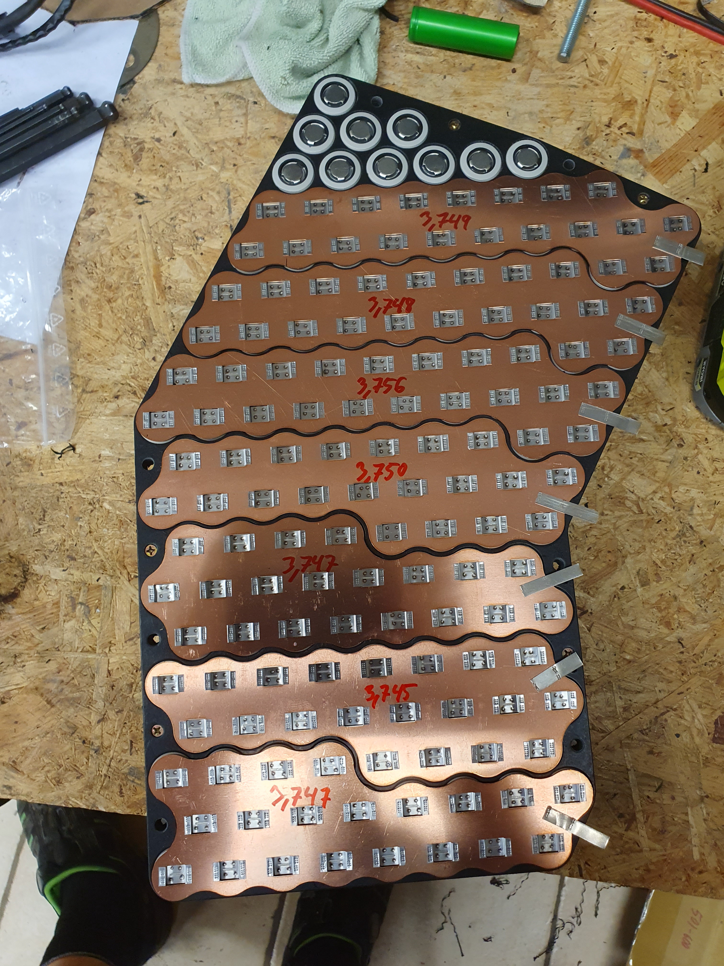

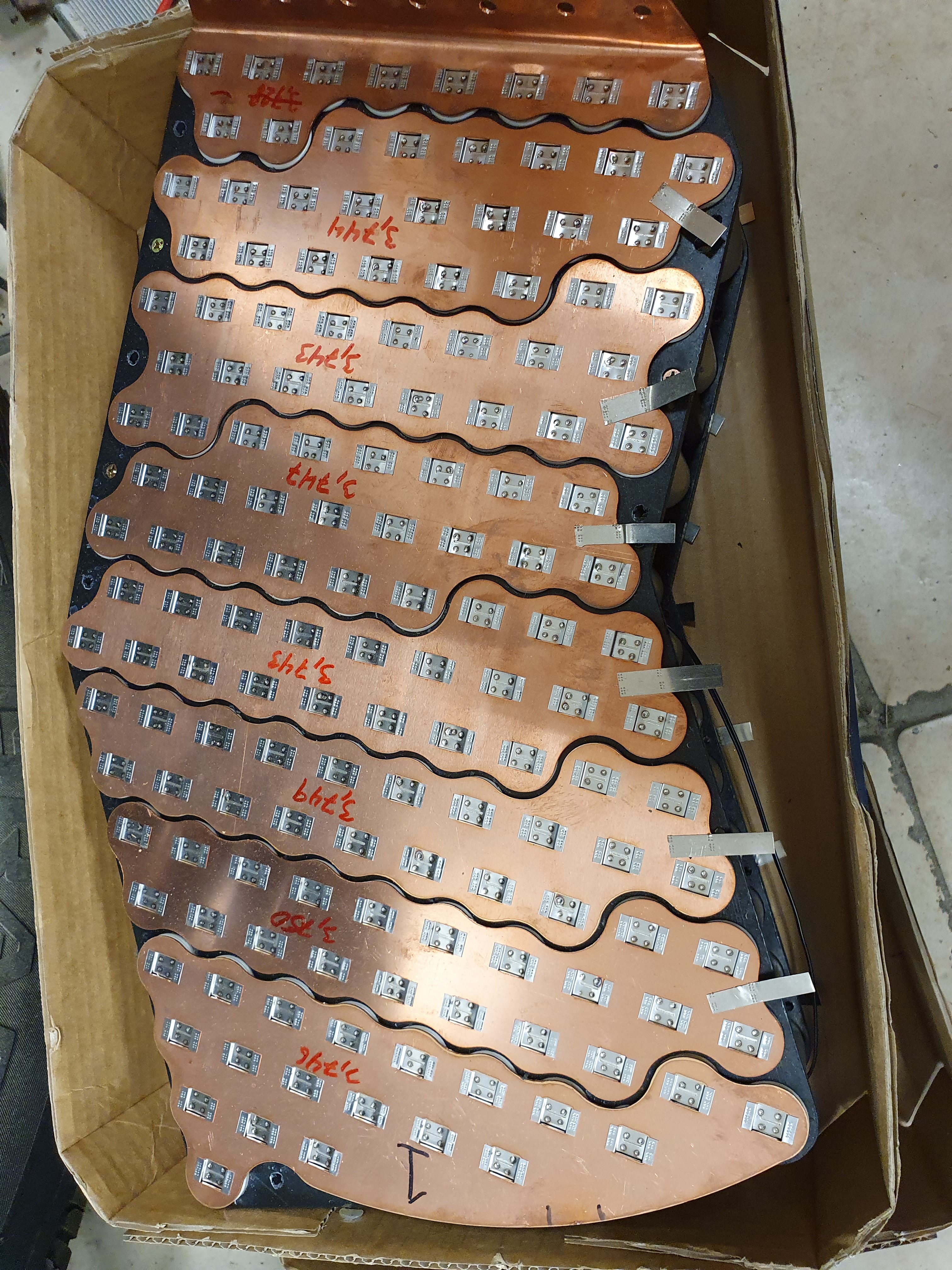

I also finished the other 2 battery half's, but I lowered to 40J
I'm waiting a little with the + and - connections though, I dont know how I want them yet.
Probably just folded 90 degrees and with a few holes, but I can just as well wait a little.

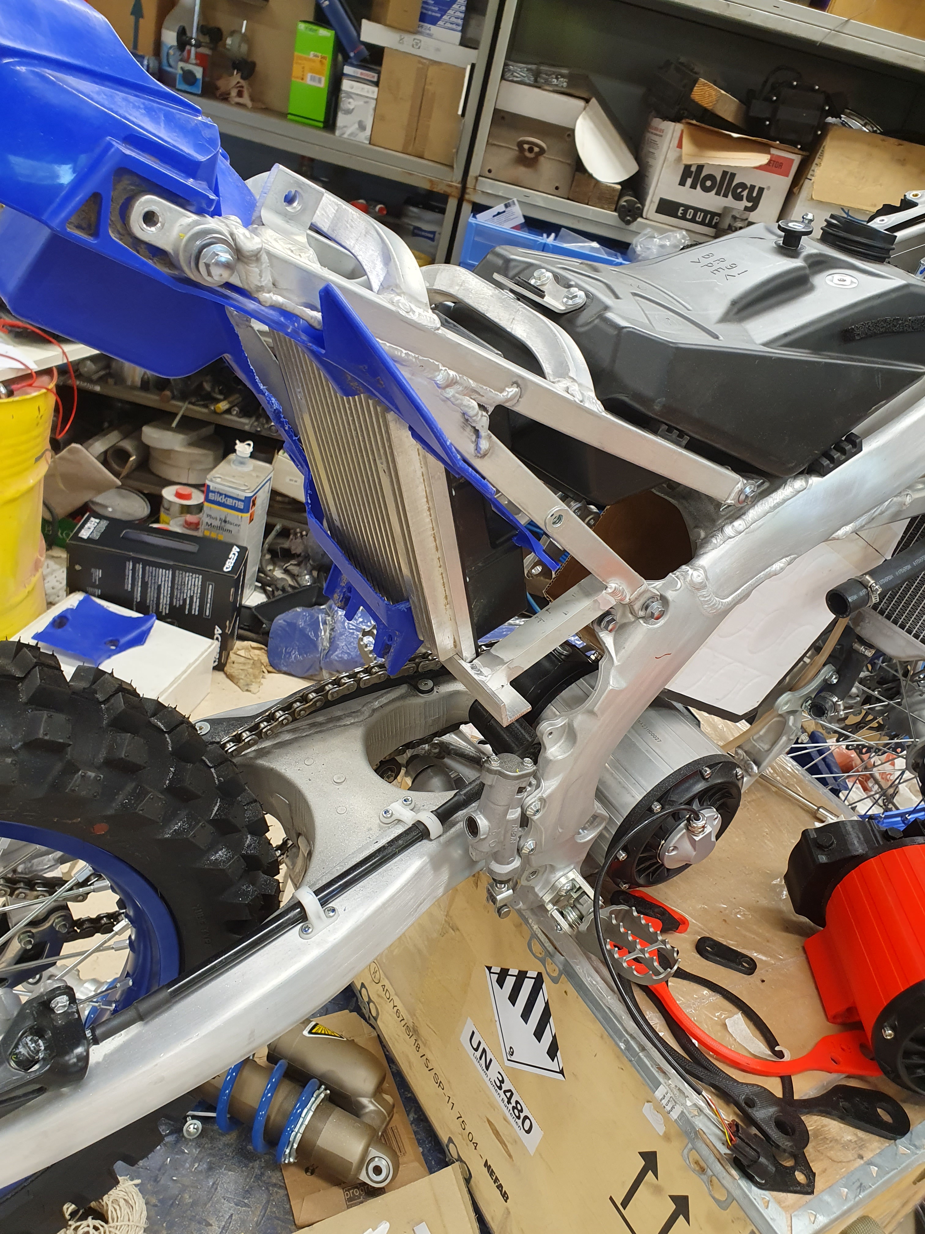

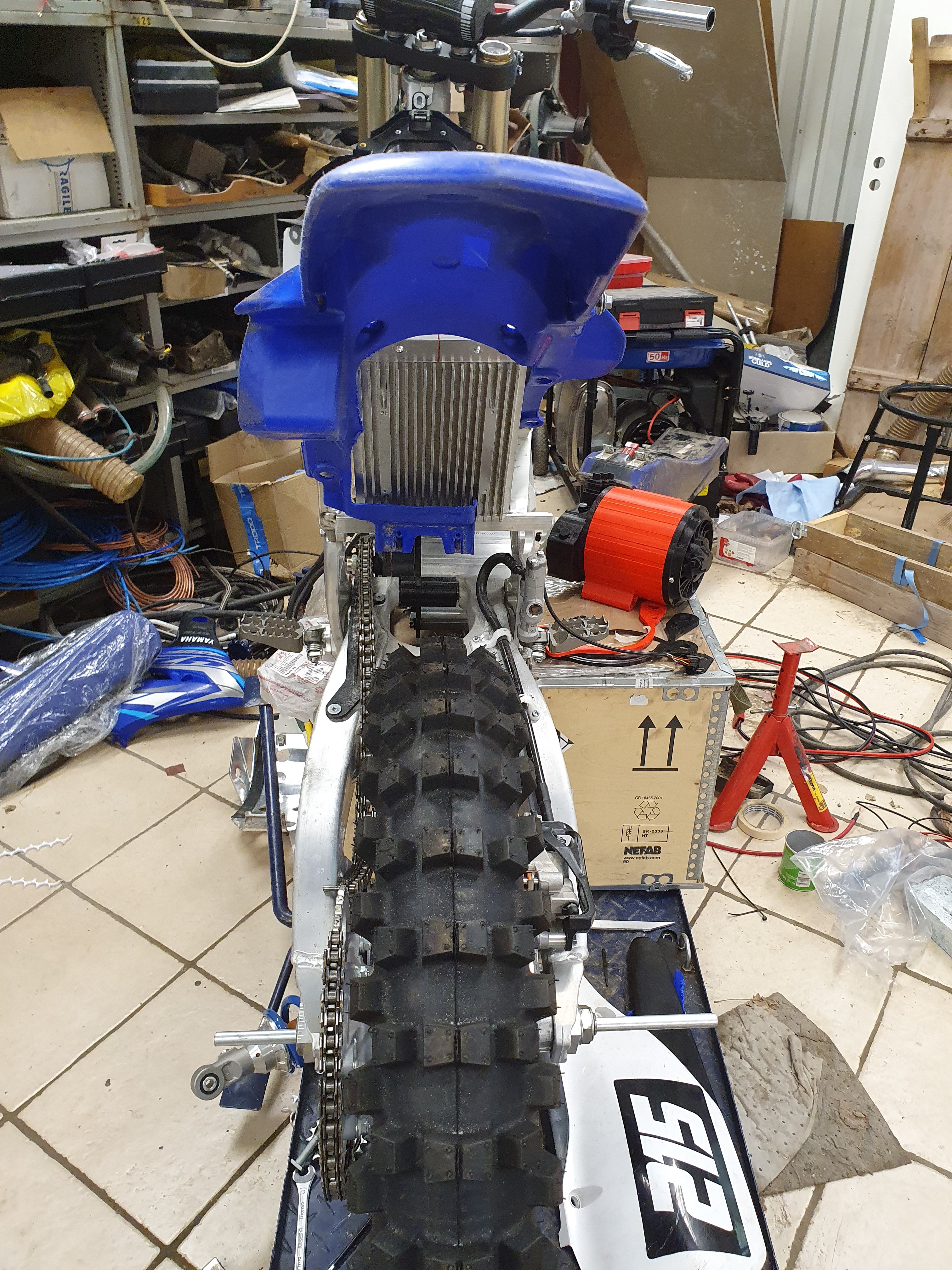

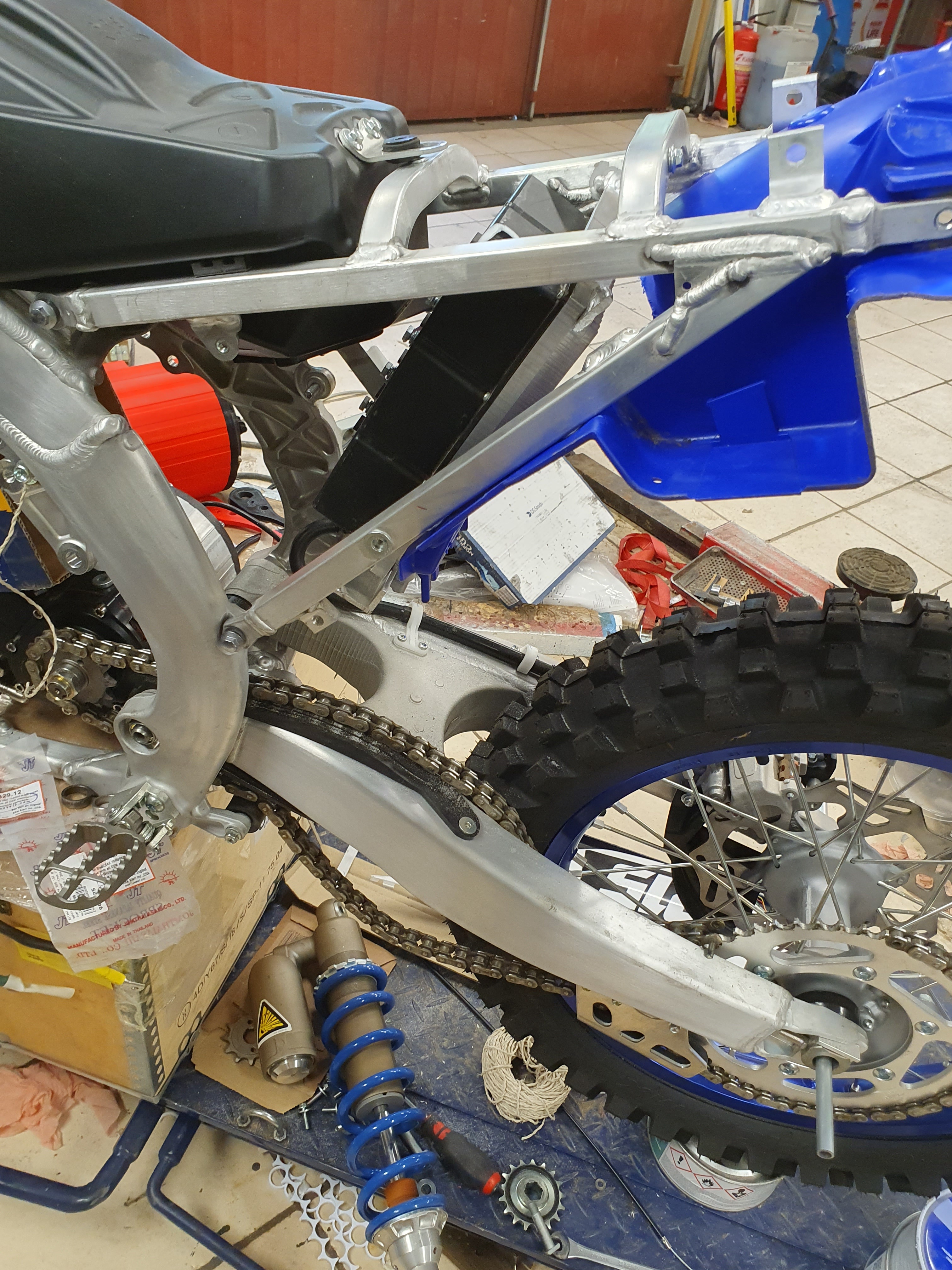

In the meantime I have been looking at controller placement.
This is what I have come up with:
I think i can spare the space when I am going for relatively small batteries.
I think it is a good placement, with centered weight and relatively short wires to the battery and motor.
I hope cooling will be good there, but it will be turbulent so not that easy to say maybe.

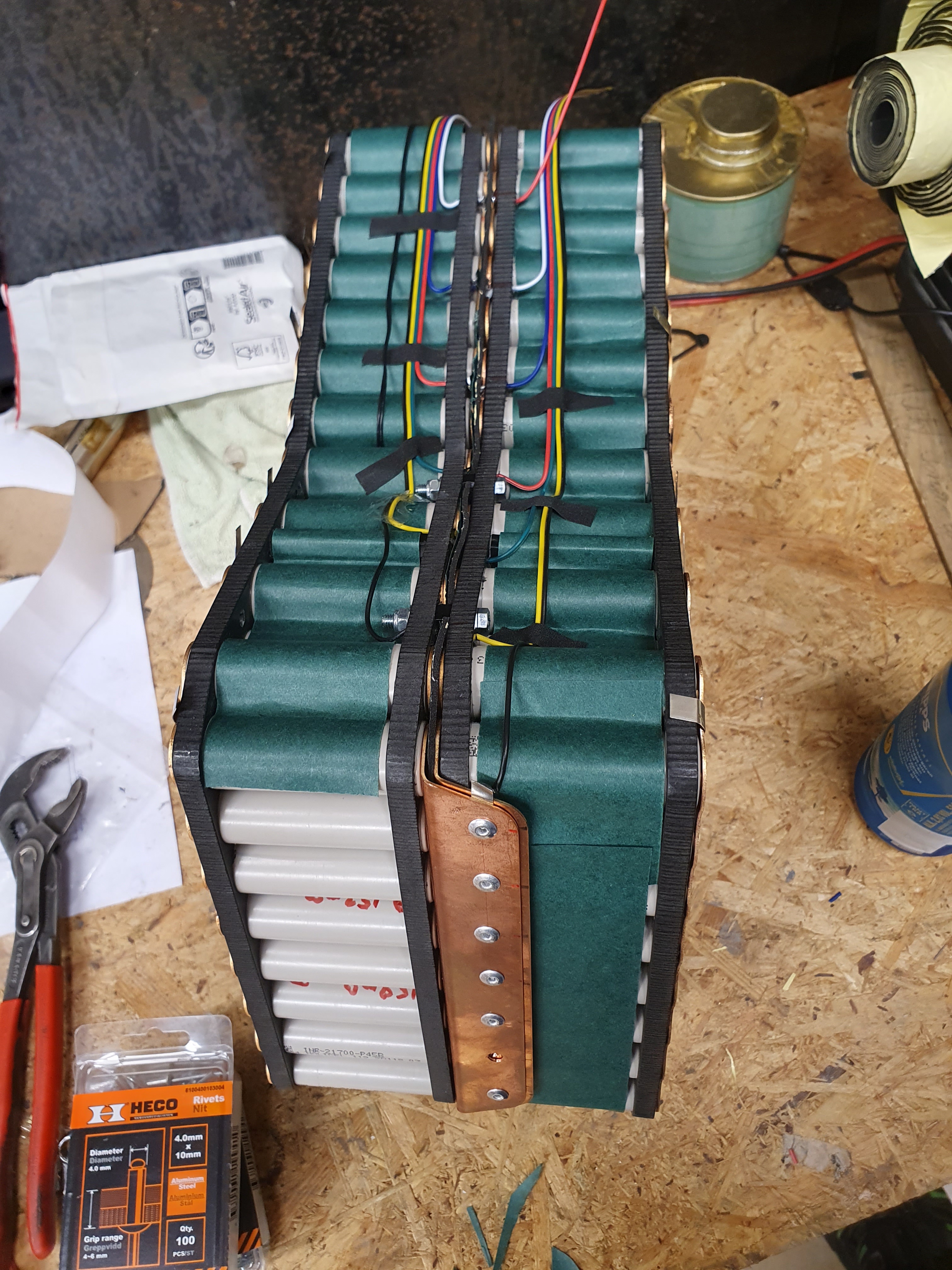

Not much have been done, but some parts have arrived at least:

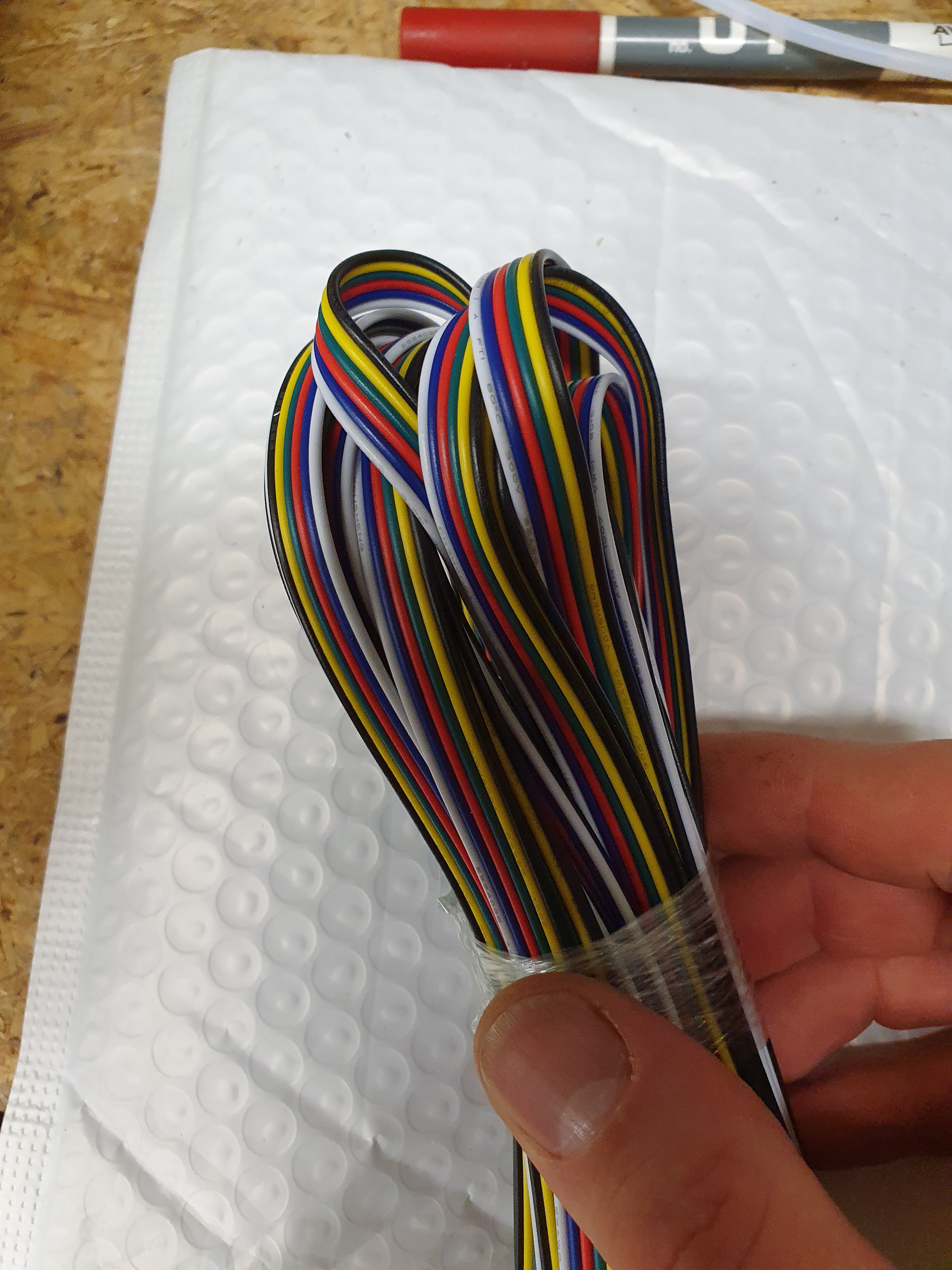

Got some flat wire to use as balance wires.
I havent decided on what bms to use yet, so I might as well solder on wires on the bus bars for now.
Just so I can continue putting the batery halves together.

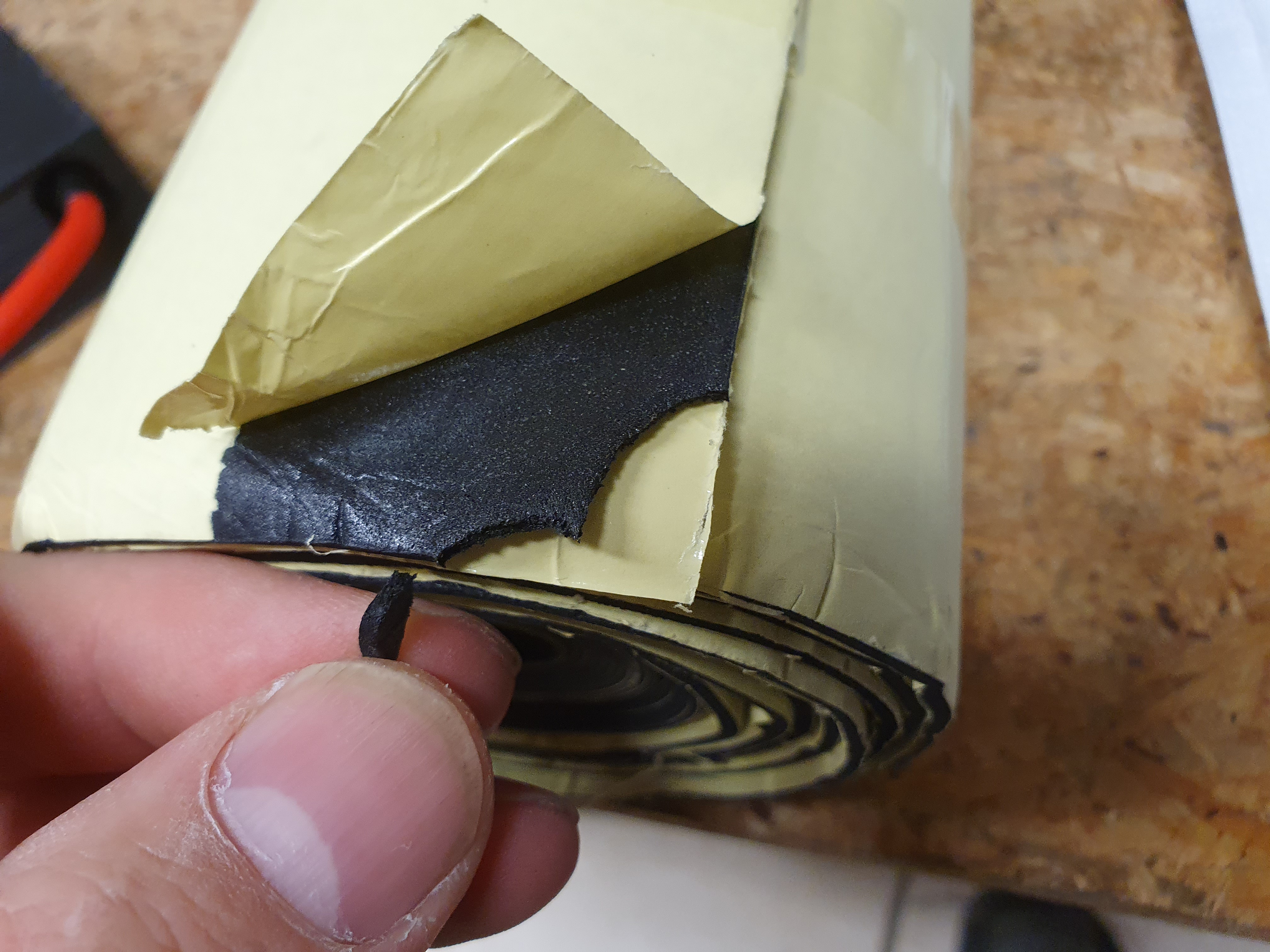

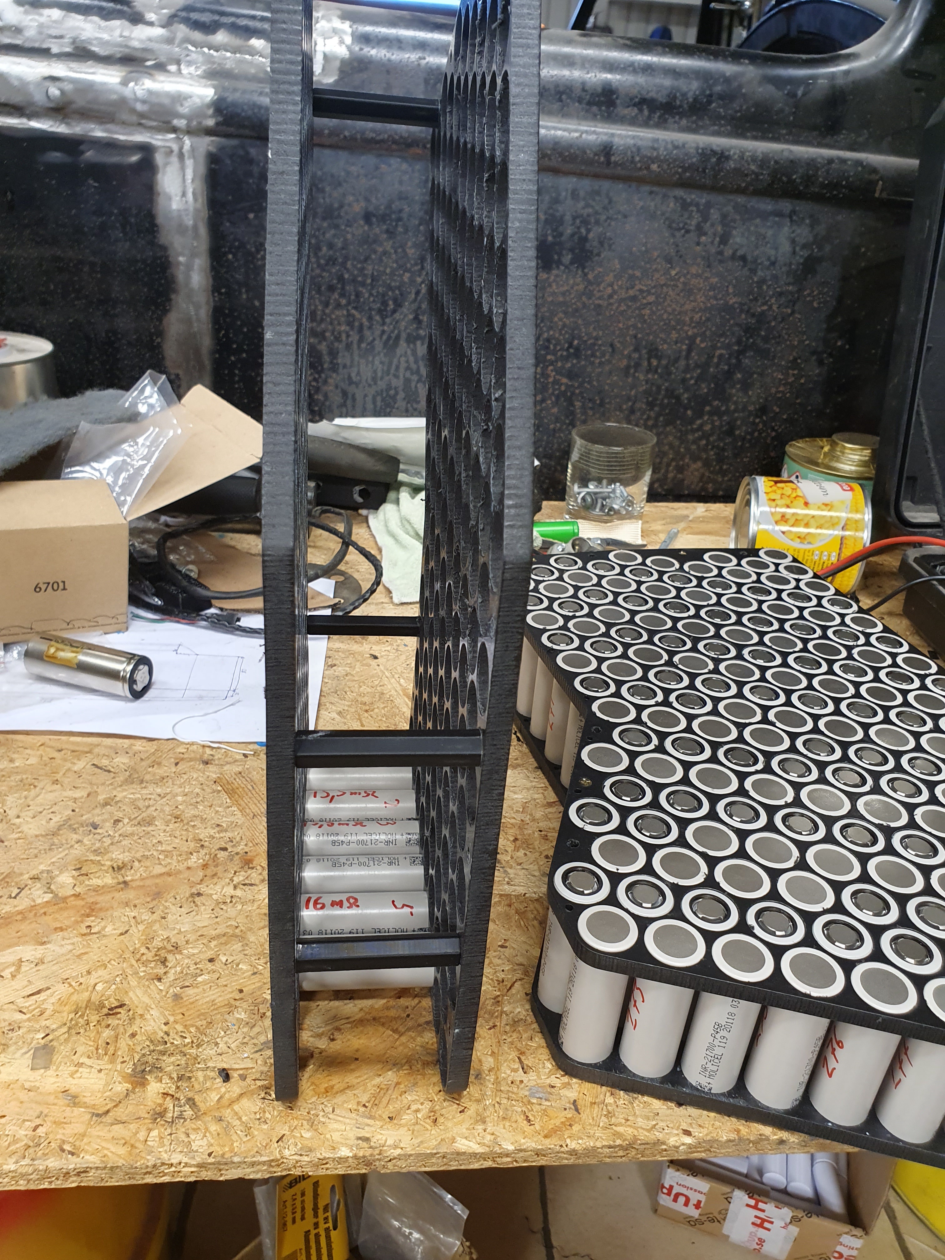

I also got this rubber foam double sided adhesive thing I planned to mount between the battery halves.
It is less rubber and more foam than I hoped, so I am a little hesitant 🤔
It is not very hard to rip off a peace.
The battery halves will be screwed together with spacers between, so it shouldent be that much strain on the foam I suppose.
And there isn't any sharp edges really, that could dig in to the foam.
But still, it would feel safer with something between the cells that would be difficult to penetrate with a screwdriver:rolleyes:
I've used think HDPE before and really liked it. I also see PCB board stuff (FR4, I think it's called?) used a bunch as well. Thin plastic, generally, work pretty great.
I think the best material would be "epoxy fiberglass", in 0.5mm or similar. Its main use is a as a high-voltage insulator and is very puncture resistant precisely for this application. I put it under BMSes in two ebike batteries i built so far and plan to use as padding for the upcoming enduro battery in alu box.

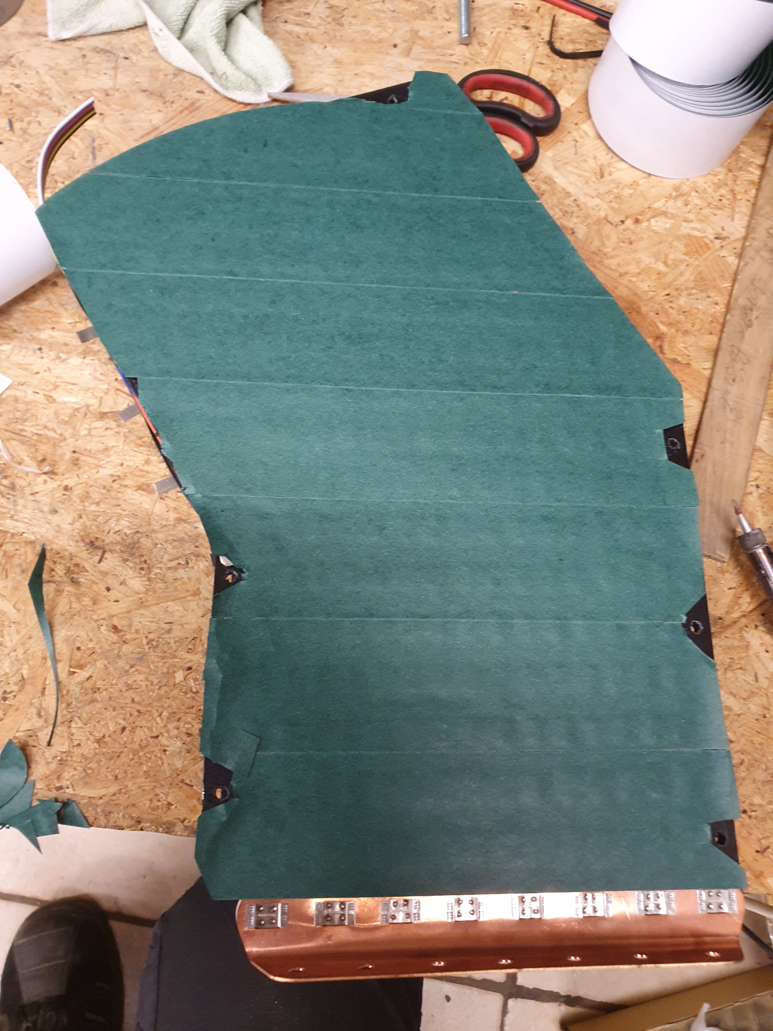

I decided to go for a layer of fish paper and the foam rubber:
I did this a few days ago, and today I got a mail from the cutter saying that my plastic sheets are finished :rolleyes:

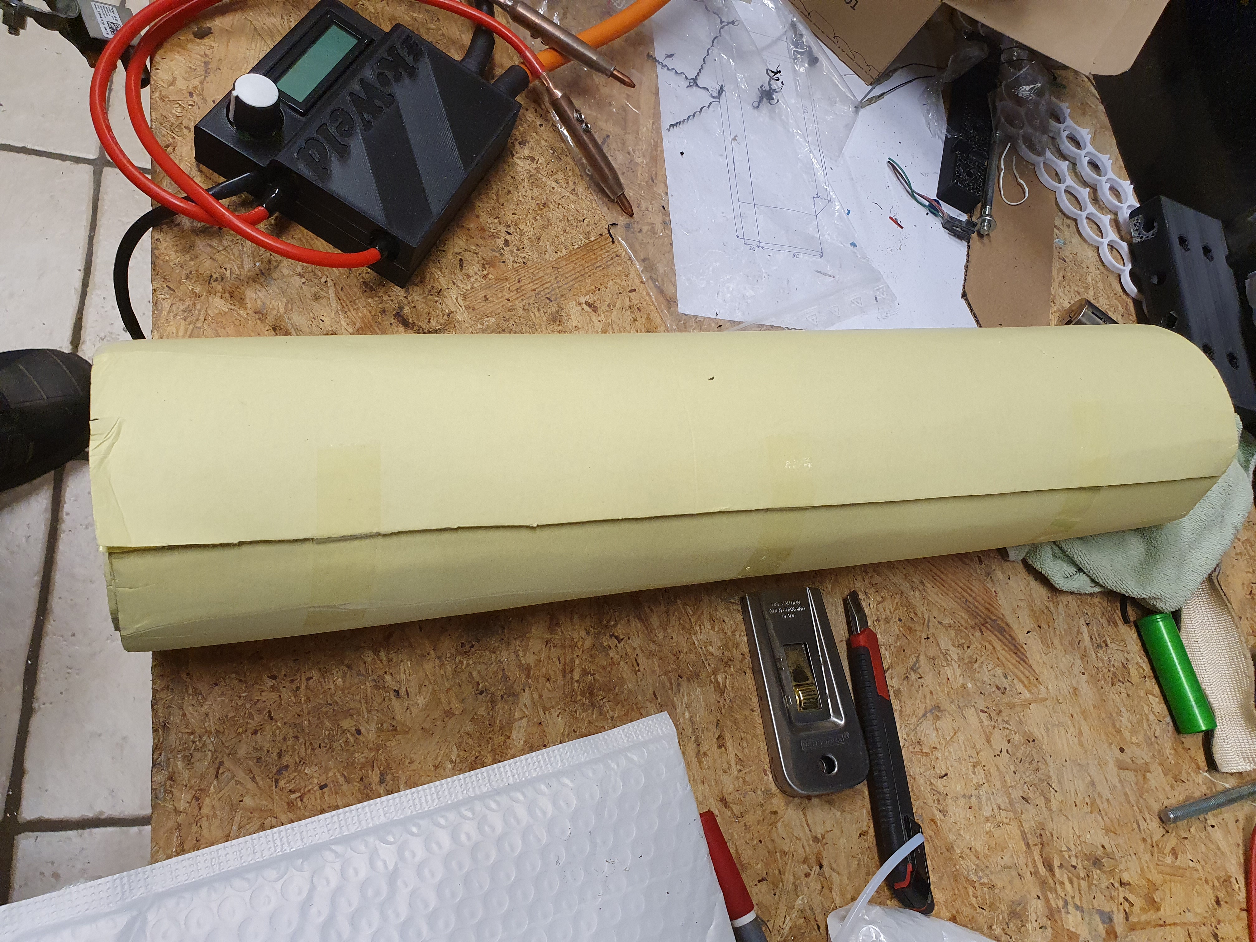

I have started shaping the battery box, I think I will make it in fiberglass.

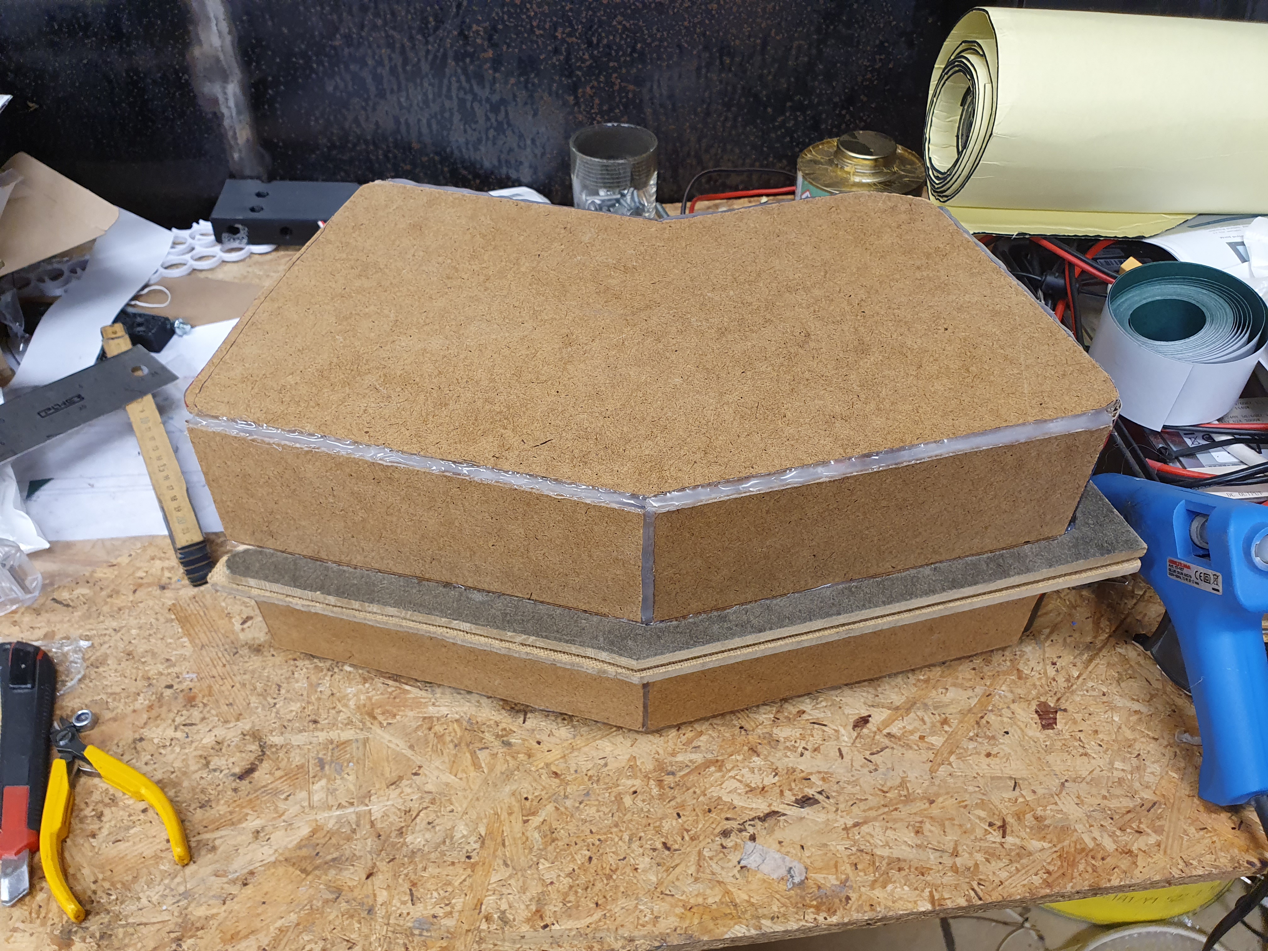

Some kind of start when it comes to battery box model:
