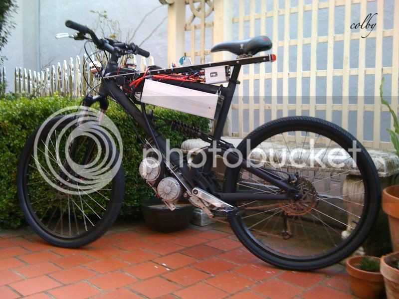

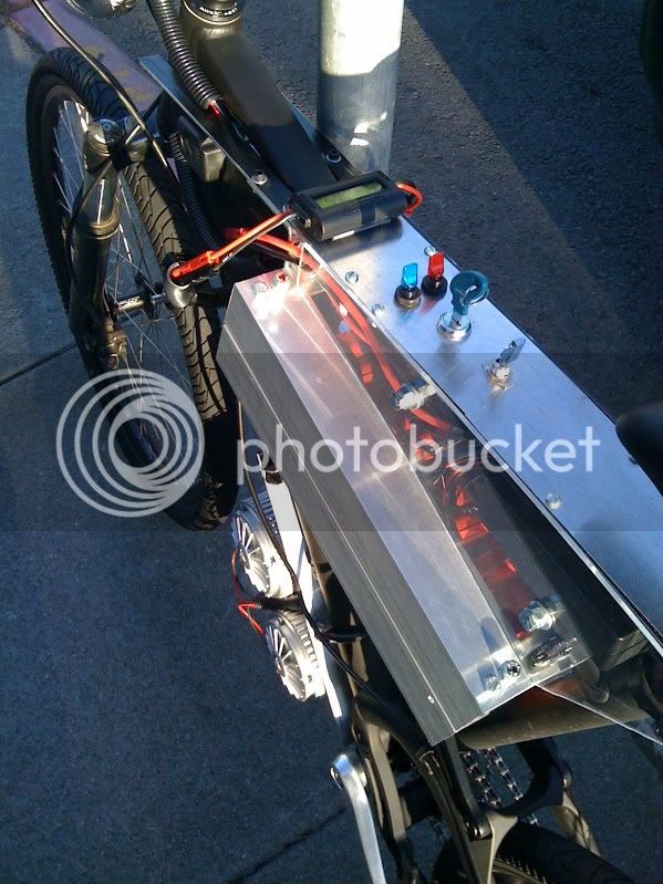

colby said:
thanks guys!
i really appreciate it.
yeah, they turned out well considering my limited tools and space (hacksaw and a power hand drill) the bracket is kind of my signature for my bikes :) it definitely has more purpose on the EB1.
i really liked the EB1, but i built the EB2 because i wanted something safer and lighter at higher speeds and have the ability to shift the motors.
the EB1 was heavy as hell and every time you would hit a pothole you thought you might die :shock:
EB2 is a 2006 giant pistol 1 with aluminum frame. great bike. hayes hydraulic disc brakes, fox rear shock, etc. here's a link about it:
http://www.mtbr.com/cat/older-categories-bikes/older-allmtnbikes/giant/pistol-1/PRD_413304_1576crx.aspx

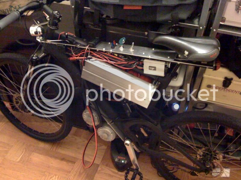

here's a couple more pics.
charging.
controls:
watt meter
blue=headlight
red=taillight
key=controllers on/off
silver=battery on/off
changes to come:
24" rims with 2.5 hookworms
new custom bracket/battery box and home made seat (kind of like a dirtbike seat)
kelly 100 amp controller...and if the motors die after proper cooling and gearing. maybe a etek/mars or possibly rc. the motors should be fine though (short 4kw bursts with very low gearing) will see though :|
2 more bosch fat packs (in the mail right now)
thanks for looking :)
think I'll start a separate thread for this :wink:
Very interesting way of making room for the batteries!
I think I might just have to STEAL that idea :mrgreen: , I've been trying to figure out where to put 4 more batteries, was already thinking I needed a way to put them on top of the top tube, and your design looks like just the trick, just no trail use right? Hate to see what happens to the family jewels if you side forward off the seat! :shock: :shock: :shock:
