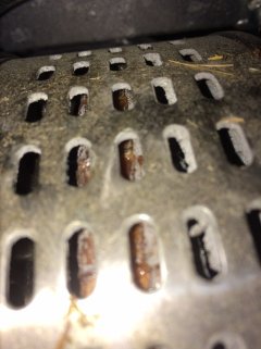

Hello
i begin to check up the bike and found following thing at the agnis Motor
that seems to be alloy shavings
Is there an need to be worried?
Could this be the problem of the lower distance?

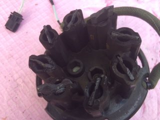

so - the next problem
My agnis Motor at the zero is dead.......
This about 1000km.... that not funny.
What do you think - make it sense to repair the motor - or should i replace the motor.
I have no experience with the agni motor and could not say how much the repair would cost.
Otherwise i would sell the controller and Motor and build up an brushless bike....
Wow, the brush holder and brushes look pretty bad! You can get replacements for those from places like Jozztek in the UK and picoamps in Germany, etc.
Is the motor insulation and windings still OK?
What volts / amps were you running through it?

Perhaps the motor was damaged allready out of factory - but its not nice to replace the brushes after such a short time - because - agni wants to have some money for that, and i think over if it would perhaps better to replace the motor to an brushless.

I would try and get the motor refurbished. Those motors are good and it looks that something went wrong. I dont know if comutator is still good at 7 and 9 o'clock and could be cleaned with the stone, fuzzy pic. Brushes could be replaced. I would contact Jozzer on forums here, watch couple of vids on ytube from jozztek on Agni's.
Some of the early Agni motors were not assembled correctly.
Like agniusm said, there is good info on servicing this motor. Here are some links to get you started:
http://endless-sphere.com/forums/viewtopic.php?f=30&t=29711 Jozzer's post on Agni motor tuning, with links to service manual and his web site, which has videos on servicing the motor. http://www.jozztek.com/shop/
http://endless-sphere.com/forums/viewtopic.php?f=30&t=27795 Chris' post on replacing and axle with great photos and detailed instructions
http://electricmotorcycleforum.com/boards/index.php?board=6.0 this section is dedicated to 2012 and earlier Zeros
