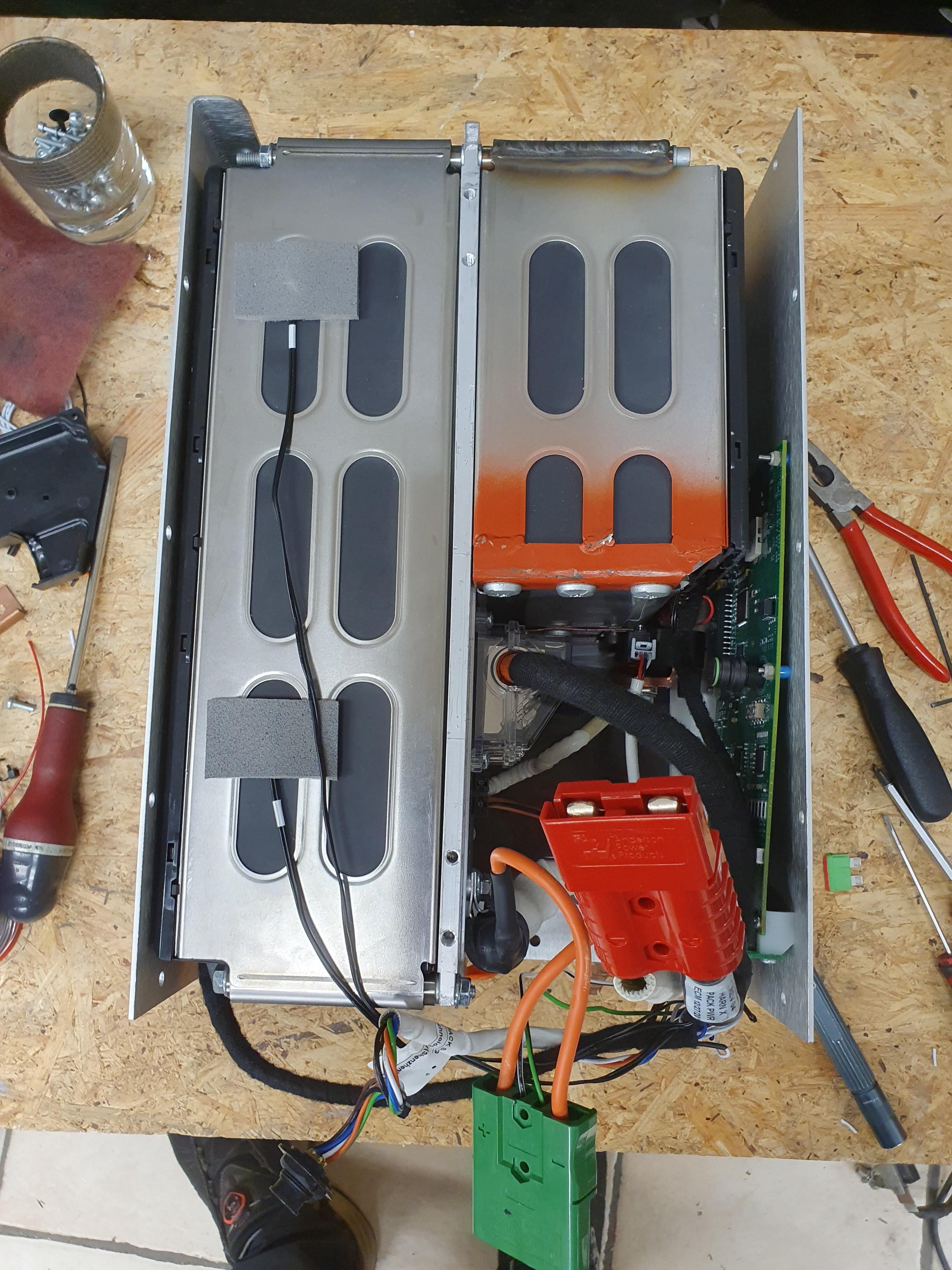

I have opened them up, the ds with dc motor has a big 14s battery:
The XU has a 18s battery:
At the moment I am trying to decide what to do..
The XU seems to have a sevcon controller, I think they are 48 or 80v.
My guess is 80v then, so it should be no problem running 24s if I could reprogram it.
Like this, but it would be pretty crowded in the box.
But if I build a 18s, I should be able to run the standard bms and everything should work right?
There is a connector that you would normally reach trough a hole in the case, is that needed?
There are also some leds that you can see trough a glass in the case, what are those for?
The interior of the battery would be a bit different on mine so the bms wouldnt fit were it normally were mounted;)
I decided to build a 18s battery for the xu, and try to get it to work with the bms.

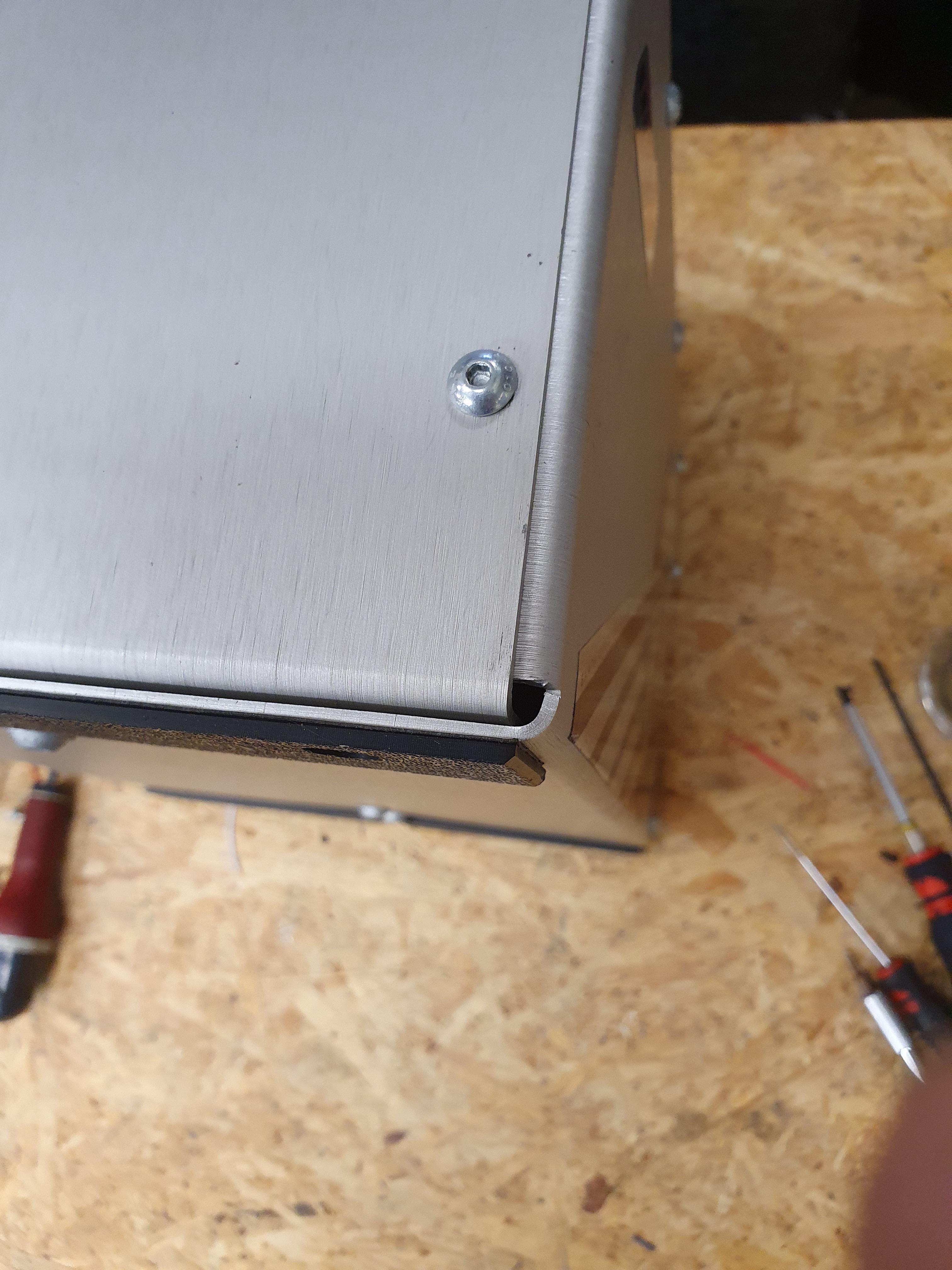

The batteries were pretty well built except for one thing.
They are not even close to watertight.
I have heard the saying "it never rains in southern California", but come on:
And the sides is on top of the top plate, so water flowing on the top will get in..
In a way it is a god thing that there are gaps in the bottom, so the water can get out again :rolleyes:
What if the owner thinks it is a good idea to wash the bike with a hose or pressure washer?

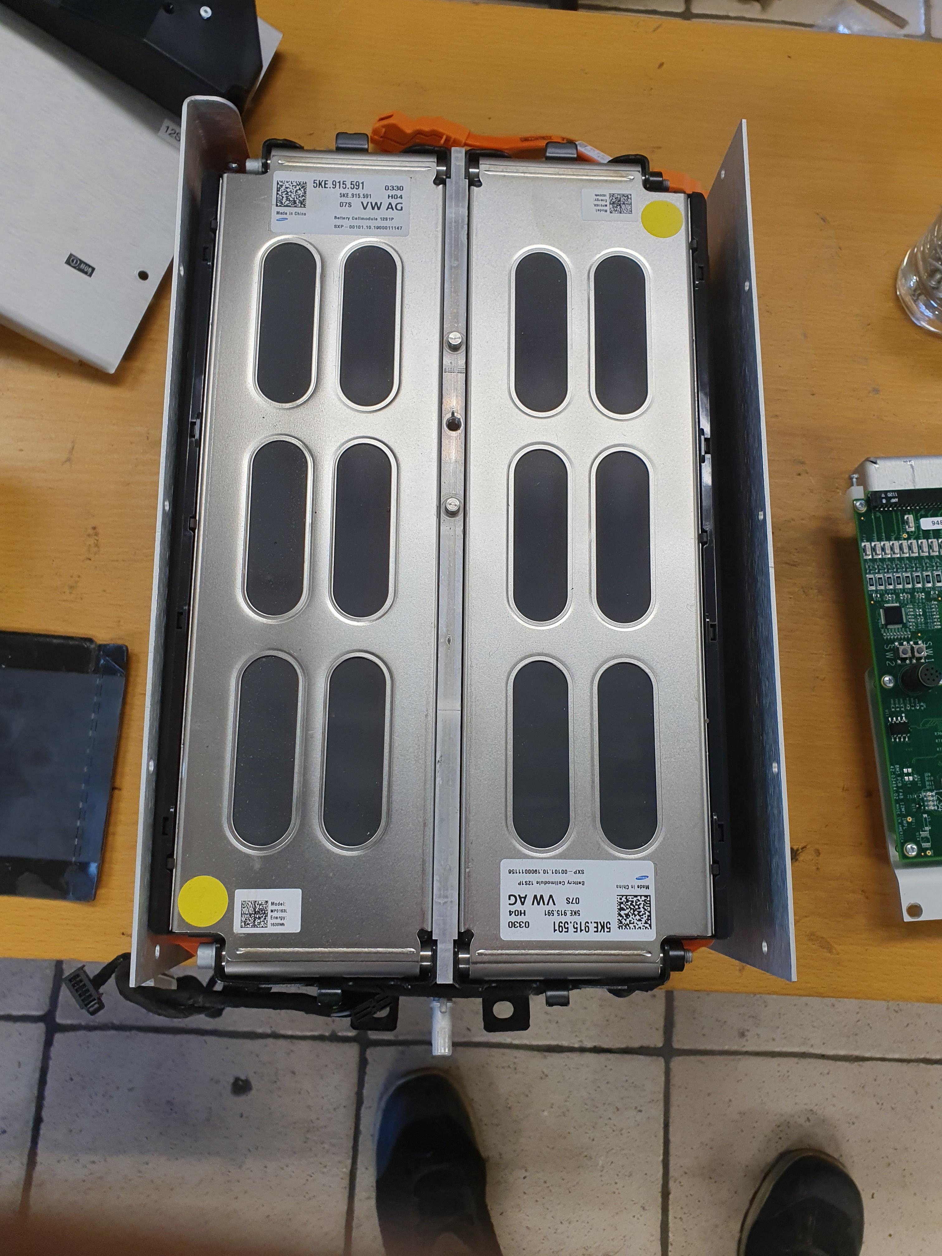

It would be easy to make a 24s2p battery, then I could just stack the modules 2 in the bottom and 2 on top of them and bolt them all together.
But then I probably have to change most of the electrical system, so I decided to go for 14s3p anyway.
I will use 3 of the 12s1p modules and parallel them, and build a 2s3p module.

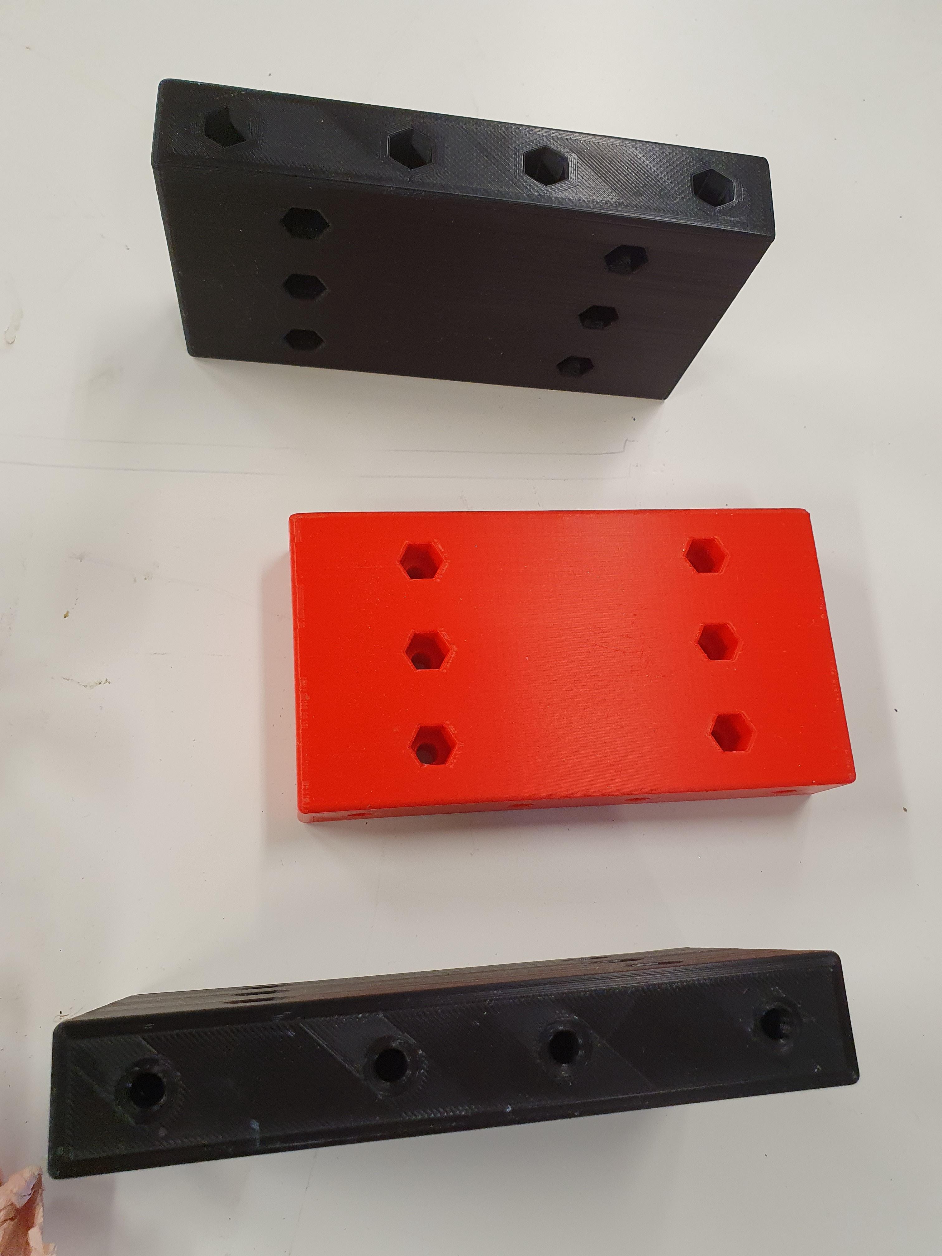

I cut up a module and made 3 of these 2s blocks.
I 3d printed these separation blocks:
But these are pla, that seems not to be very suitable so I later made new ones in abs.
It will look something like this:
I had to move the top 2 modules forward, to have room for the bms (that seems to be cast on the back plate of the battery housing)
and make room for the wiring.

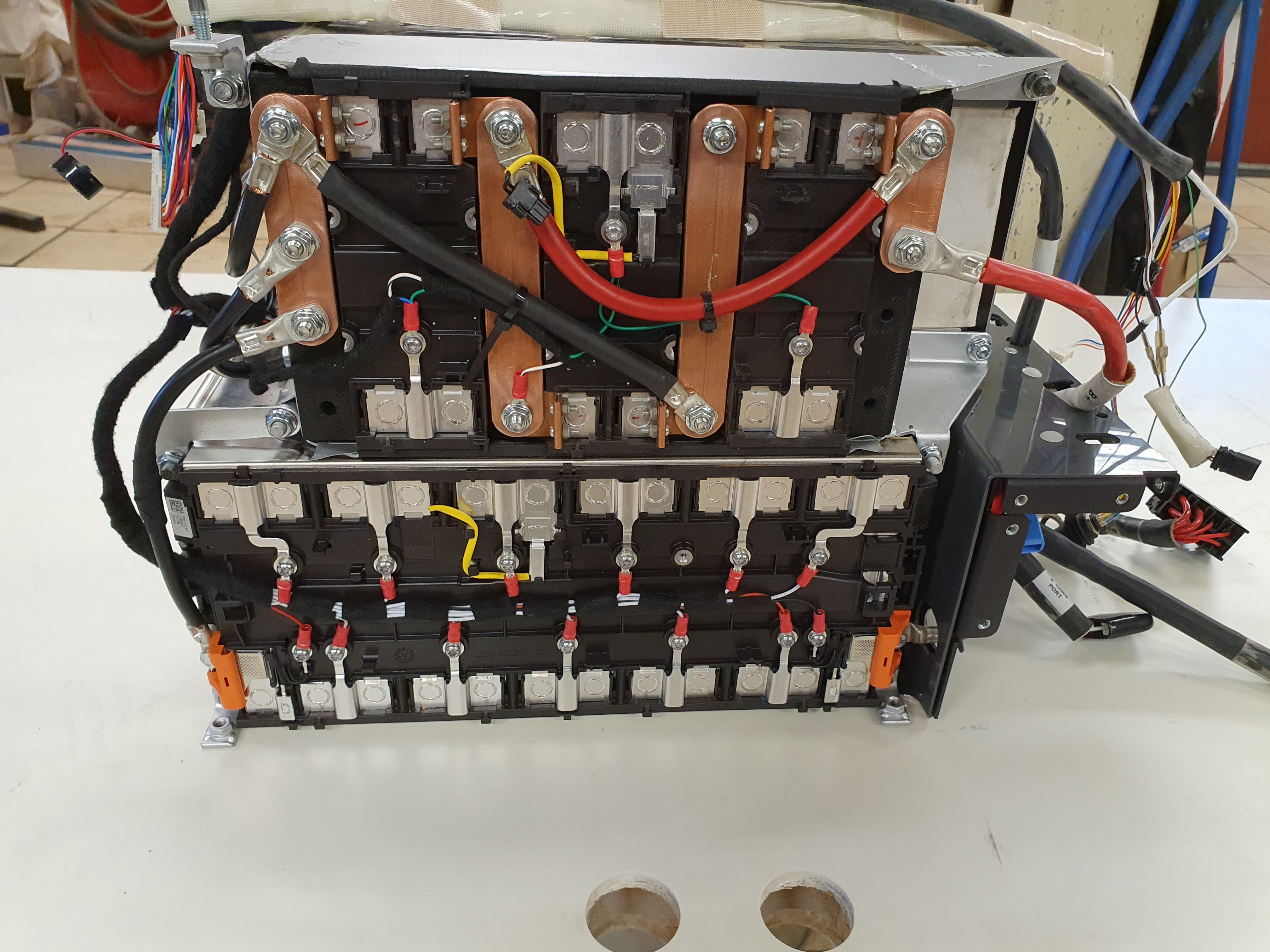

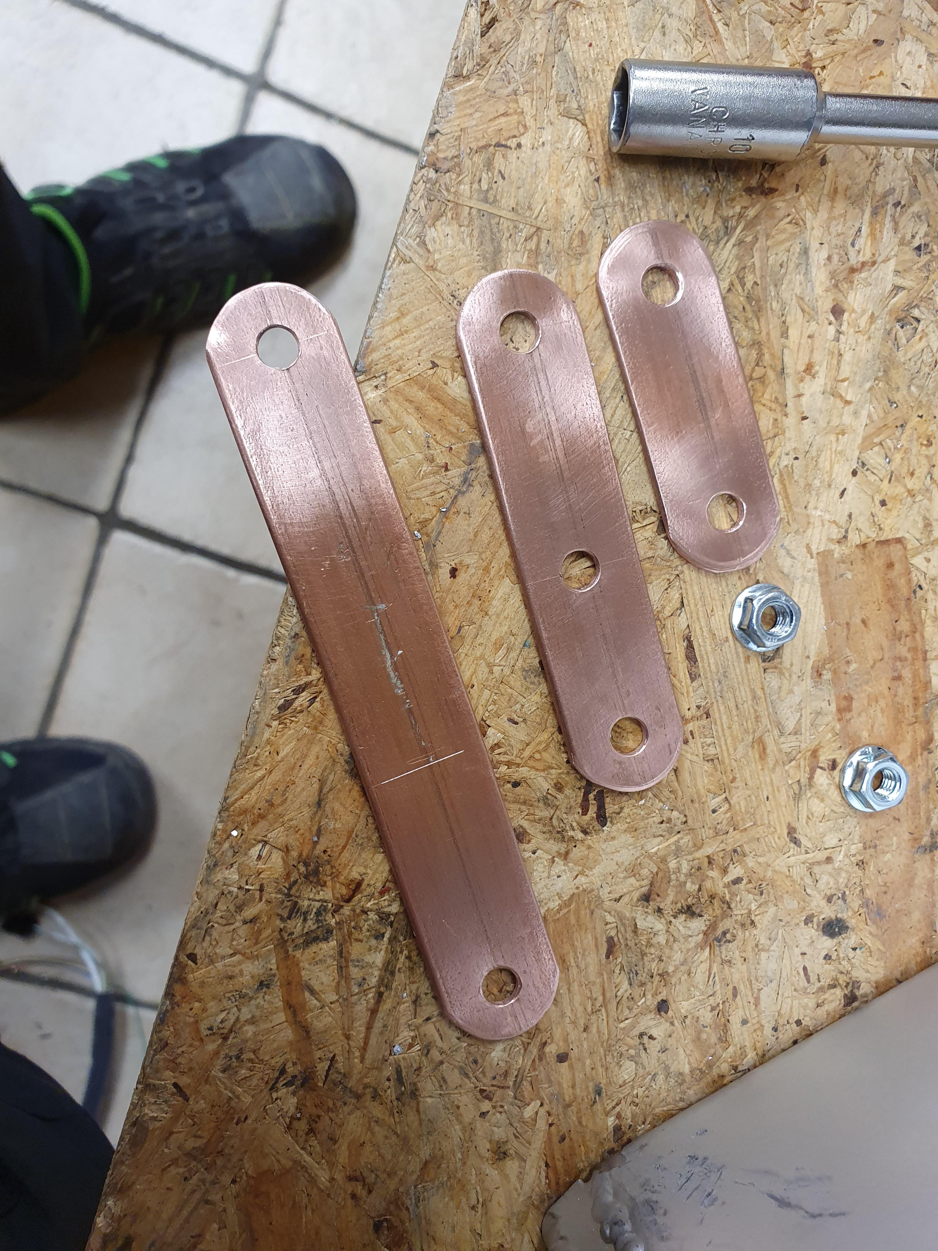

I made some busbars:
I think they turned out really well, I wouldent have thought they came from copper pipe if I didnt know they did..
Made some fasteners, so I can mount the modules in both the top and bottom of the box:
How it looks when mounted together:

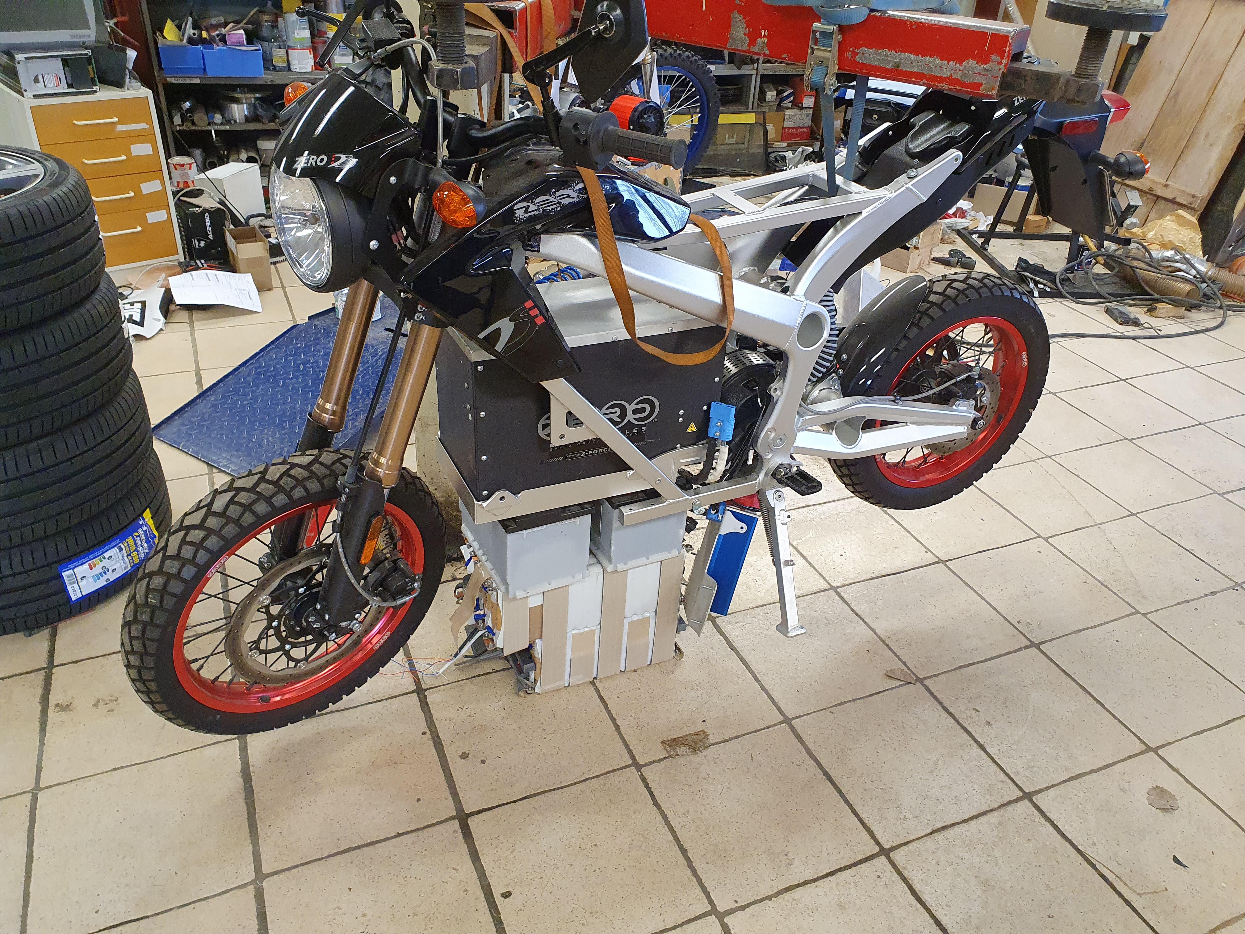

Getting the big lump in there was no joke..
It took some more work from there to the final position :rolleyes:
Finally its alive :D

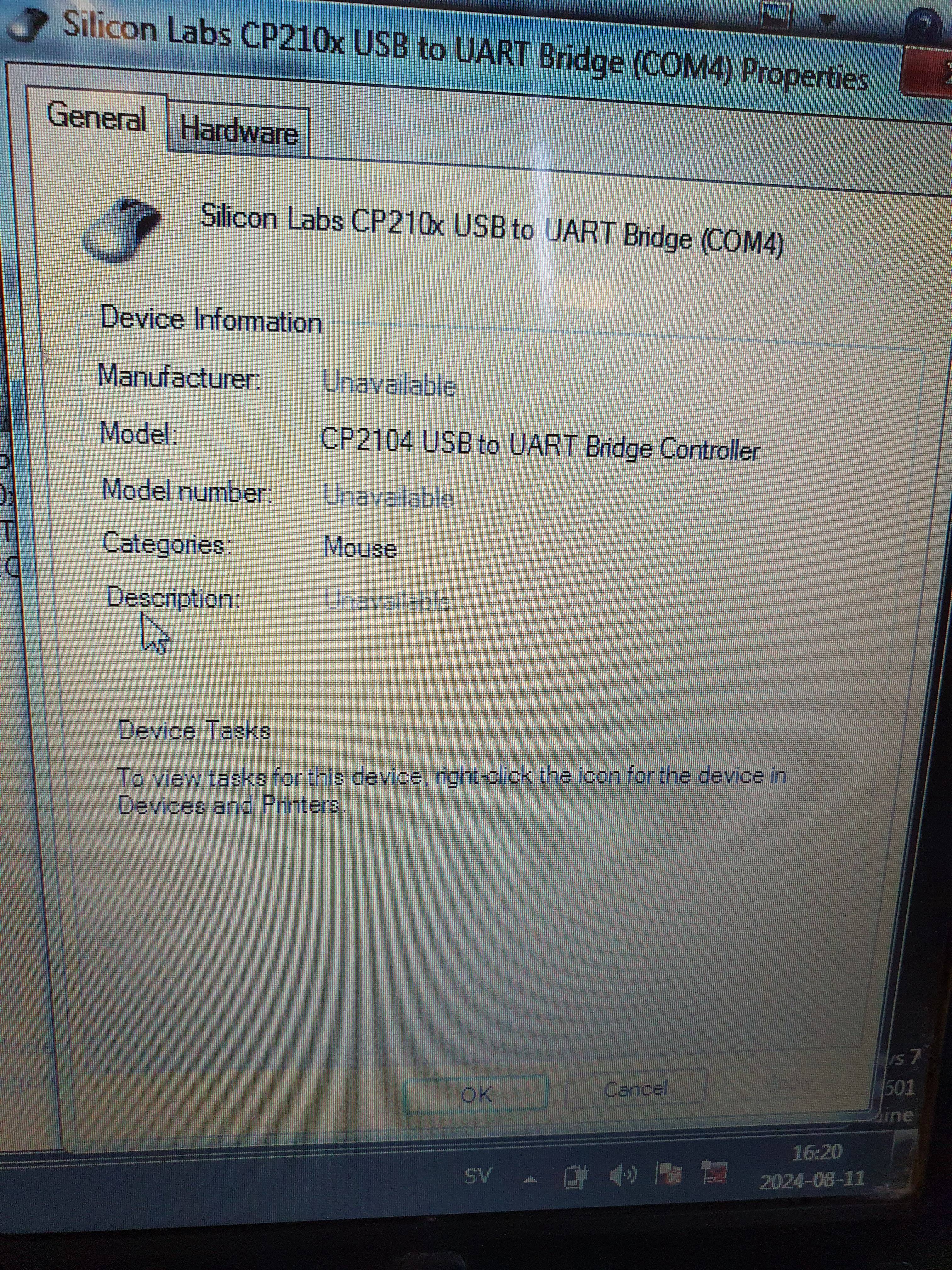

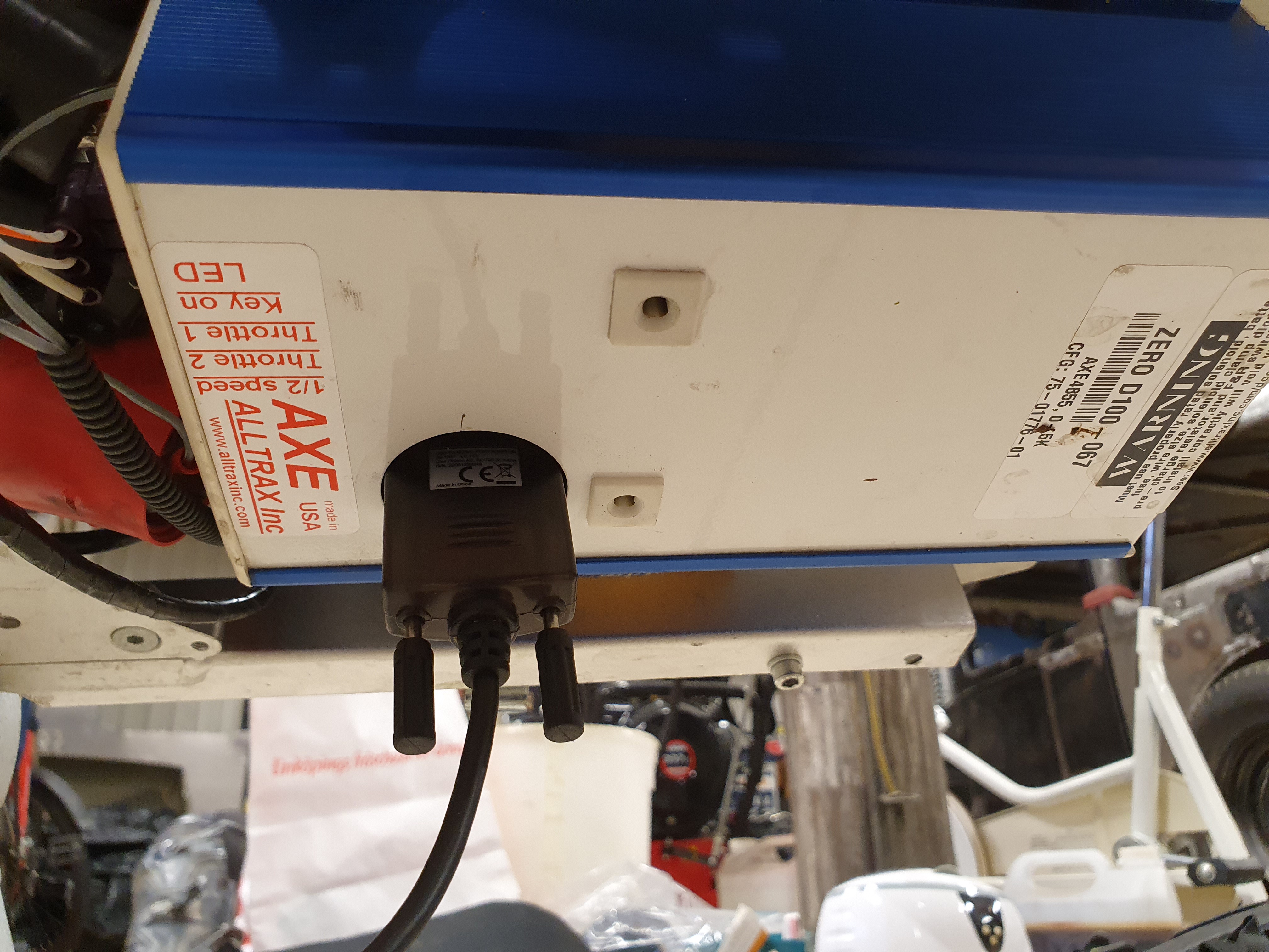

I tried to program the alltrax axe dc controller in the DS today, but I cant get the program to connect to the controller.
I couldent find a usb to db9 adapter, or a db9 wire at home.
But I did find a CP2104 usb to rx/tx adapter that I connected to pin 2 & 3 on a db9 connector, and also ground to pin 5.
The computer connects to the adapter:
It seems to think it is a mouse, but it has worked to connect to a fardriver before.
There dosent seem to be possible to choose com port on the program.
The program is supposed to be for 2006 and newer controllers, maybe a bit odd with copyright 2002-2008? 🤔
Anyone with experience programming these?
Maybe I should just get a rs232 adapters, and it will just work?
Eventually I was able to connect.
There was several problems I think, one was that when the bike is on the sidestand the controller is off..
I did buy a usb to serial cable, not sure if it was necessary.
I also installed the program on three computers, one windows XP, one with 7 and one with 10. It was the one with 10 that ended up working.

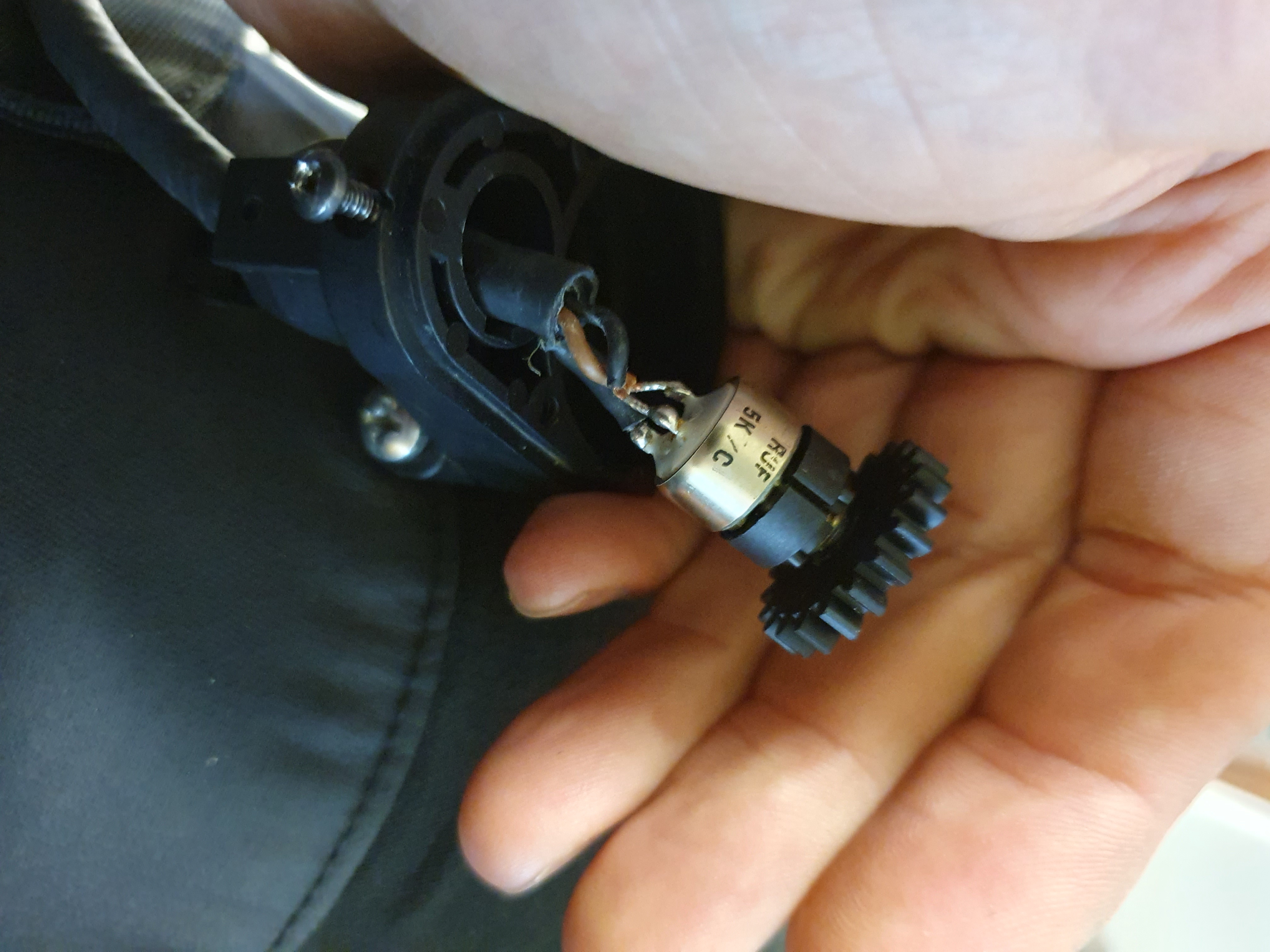

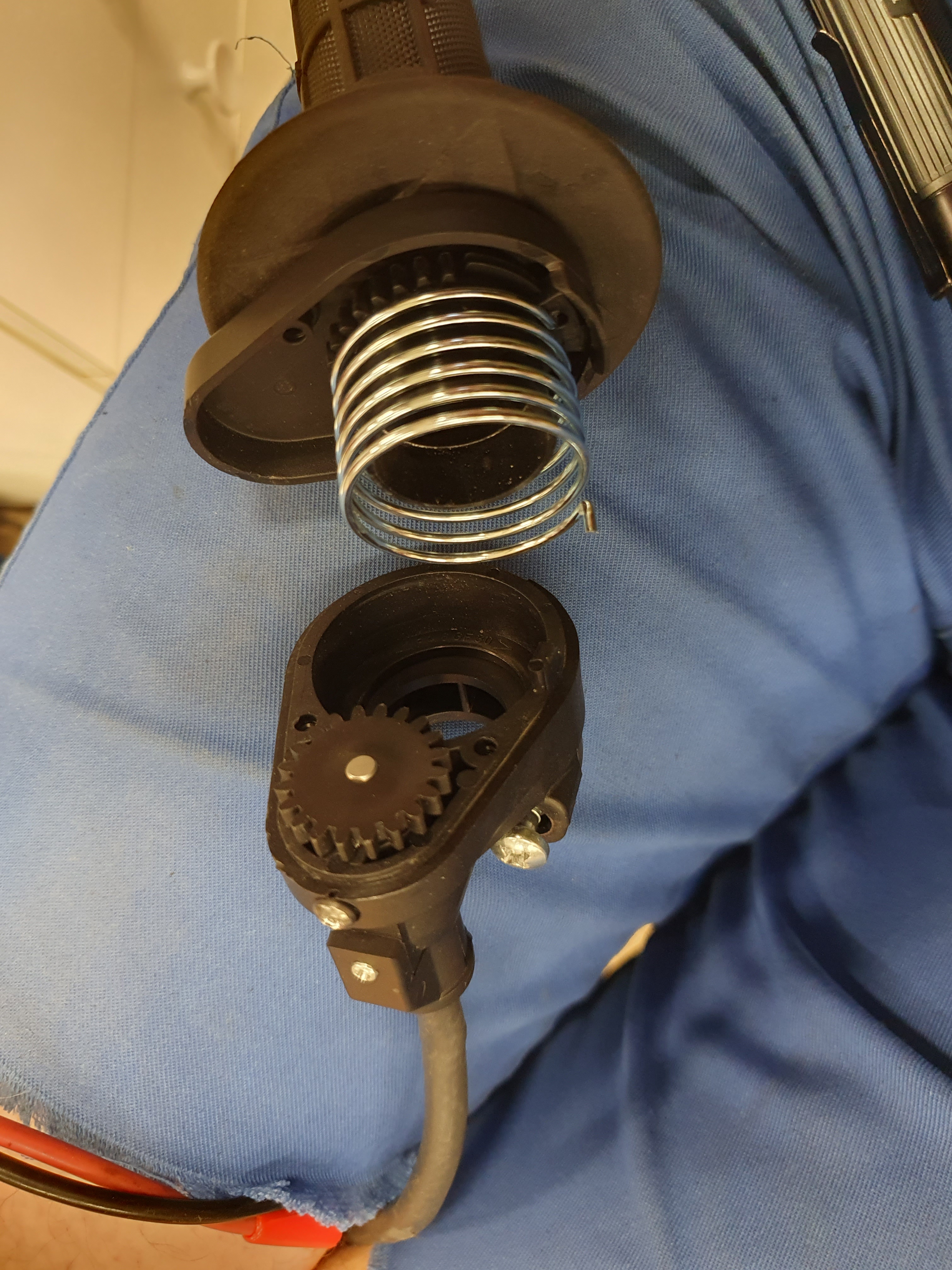

It turned out to mean "throttle high" or something like that. I got about 140ohm with released throttle, and I tried a 100ohm resistor instead of the throttle. Then it would turn on, so I suppose the throttle should go lower.
Got hold of another throttle, that had more like 10ohm released.
Tried to fix mine:
It seems like I cant take the pot apart further than this.
Does anyone know if these potentiometers can be bought somewhere, or repaired somehow?
The bike has done like 20km, so it is a bit strange if the throttle is worn out 🤔

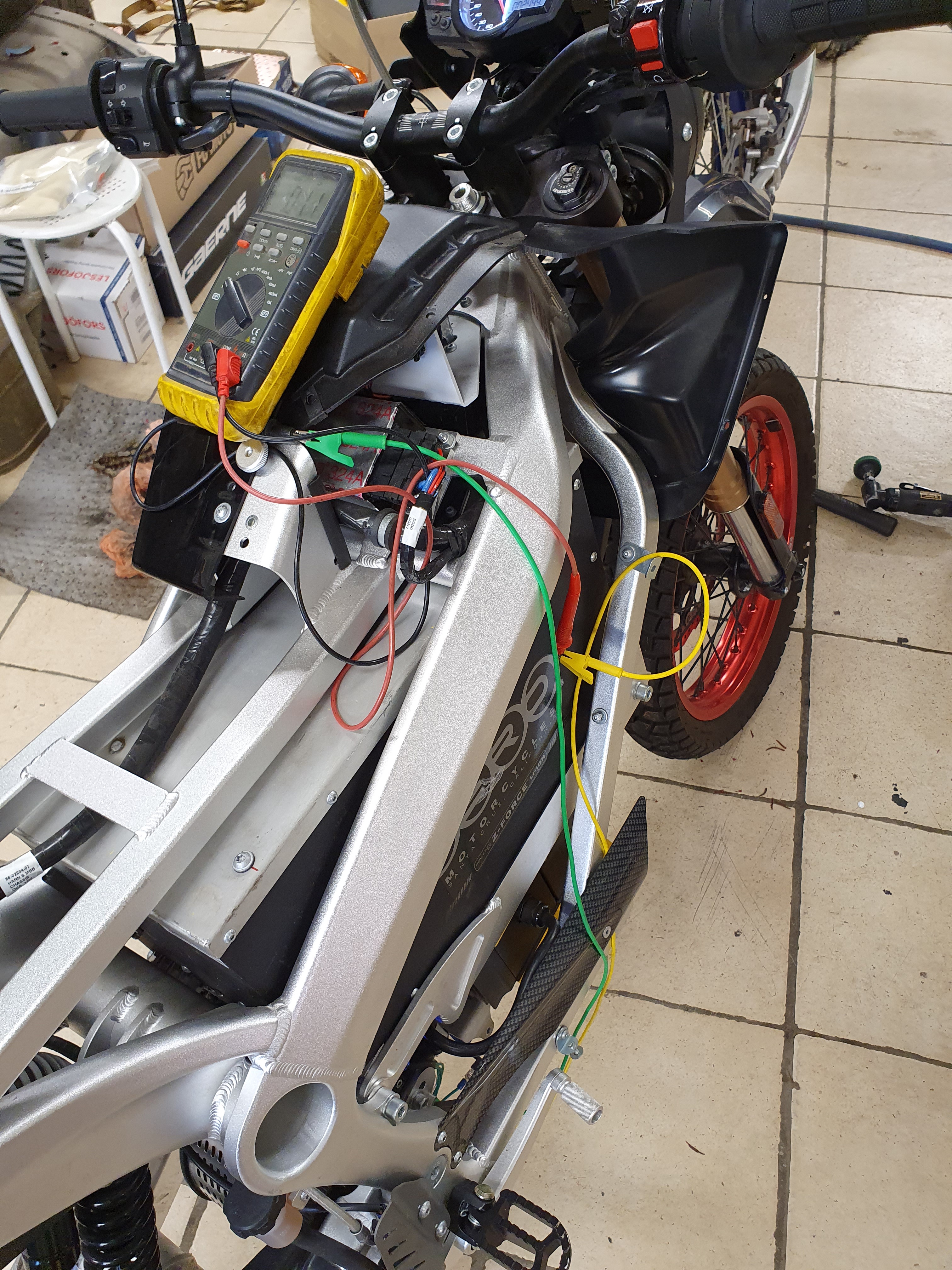

Anyway, I realized that the throttle goes to the central computer and is forwarded from there to the controller.
I made a perfect test set up and went out testing:
Ahum, it was a little difficult driving without a seat, and trying to hold on to the meter and wiring..
But I for sure could see that there was some serious throttle taming going on.
I changed the wiring and wired the throttle directly to the controller, what a difference :D
I got throttle response, I can make burnouts (on gravel or clinker😬)

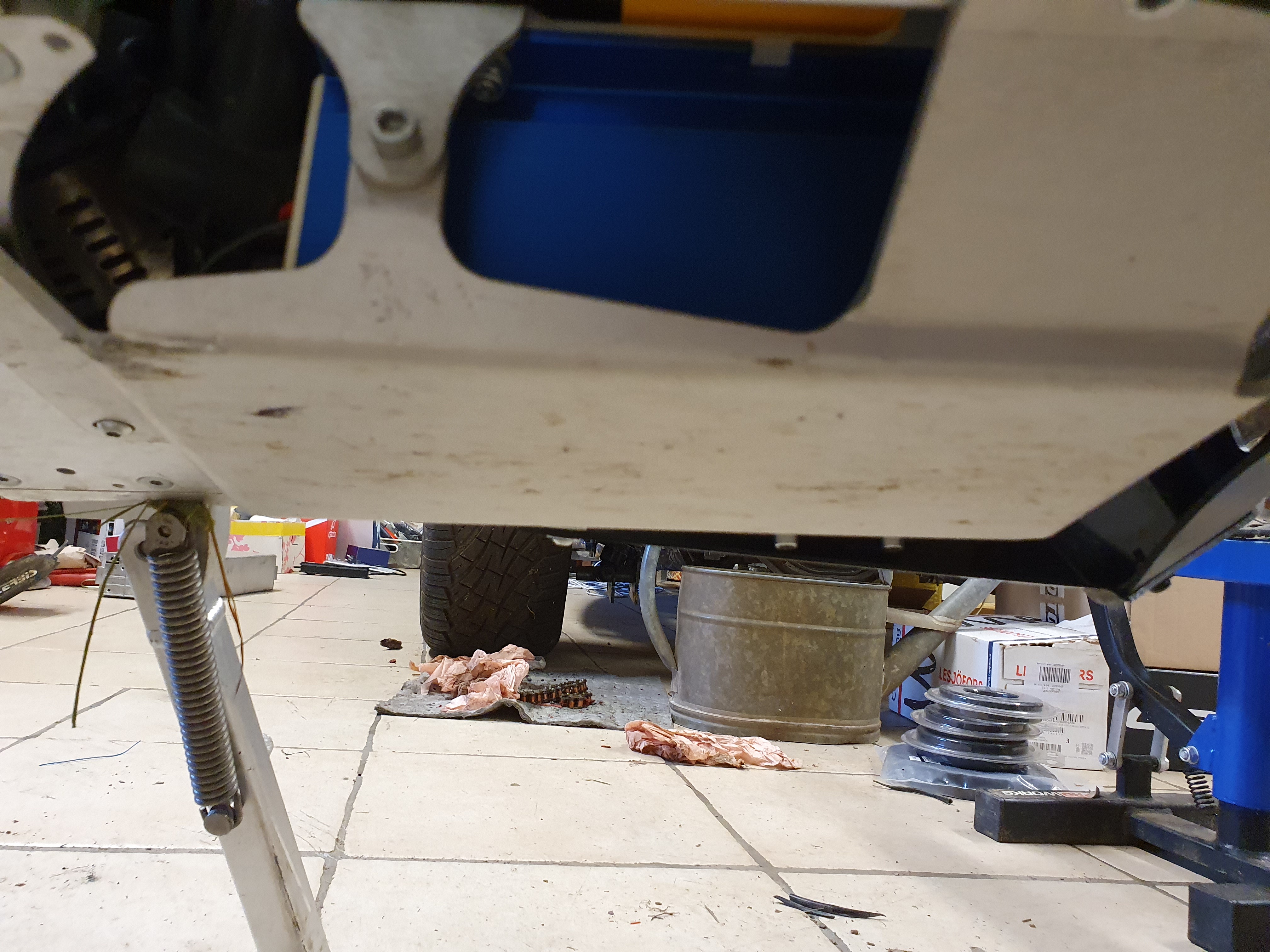

Anyway, after I had mounted everything together again I noticed that there is another problem now, it is terrible to drive at part throttle. Maybe I should try to lower the throttle response a little, and see if it helps. But then I have to take off the skid plate again 🙁
Maybe you can cobble something together and leave a programming wire hanging out so you don't have to go through all that hassle every time you want to change some setting.
It is pretty tight between the skid plate and controller, and the connector for programming is facing down.
I kind of thought it didnt matter, once set up I probably wont touch it any more.

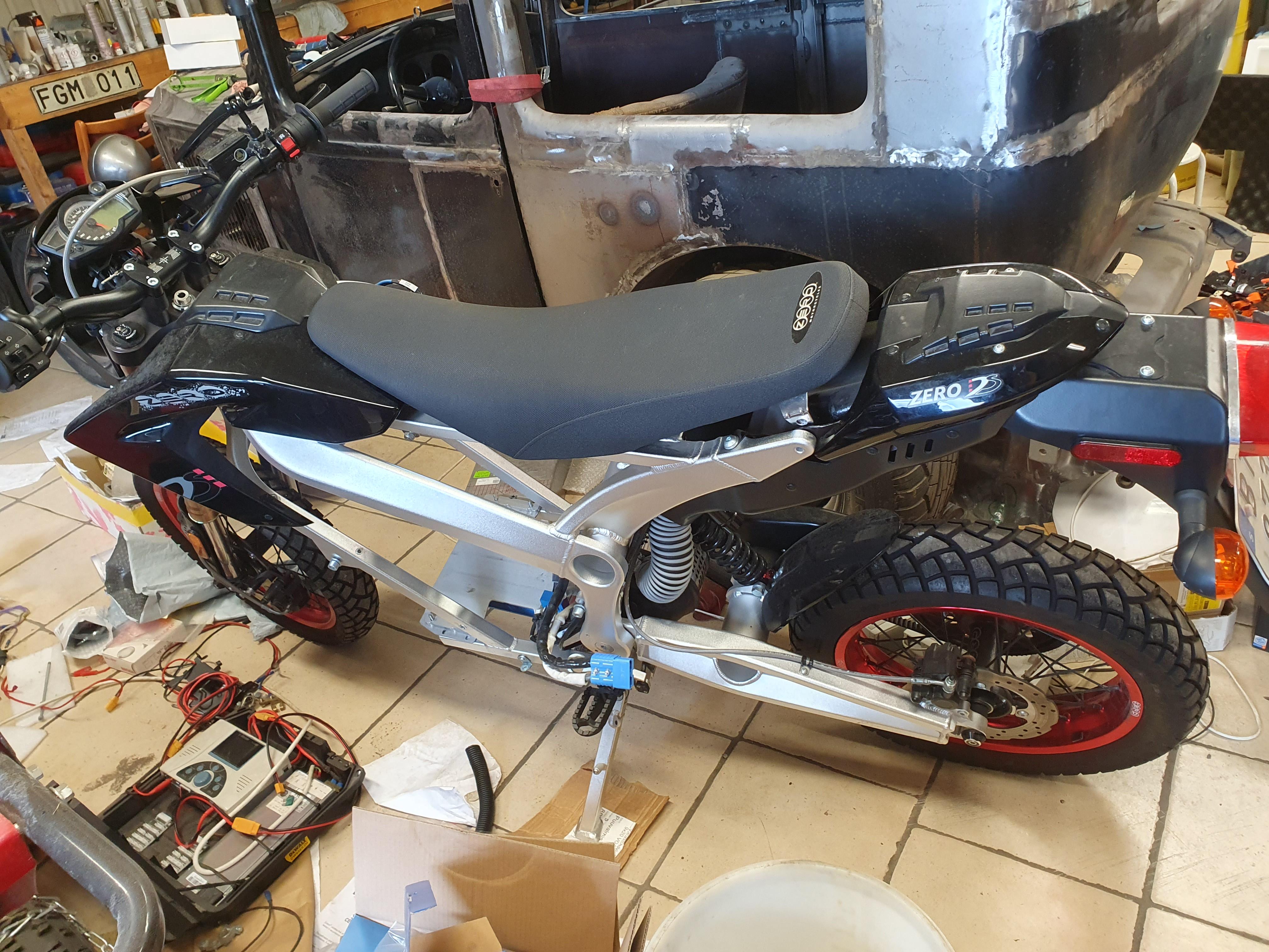

I have been moving things in the garage, the zero ds included.
Thought I might as well charge it and see what happens, it has more or less just been standing there beeping once in a while for more or less 2 years.
I left it on the charger for a long time, (20hours or so) to let it balance if it wanted.
It didn't beep while it was on the charger, and hasn't since :confused:
I tried to take it for a spin, but it would cut out more or less as soon as I touched the throttle.
I connected to the motor controller, and saw that it would show 100% throttle when it cut.
Even if I only had like 25% throttle or so when it happened.
I decided to rearrange the throttle so it connects to the central control module just as it was before i messed with it, and set the controller back as it was too.
( I had the throttle connected directly to the motor controller to get better throttle response and power)
Now it works again :)
I had a vague memory that it had poor range, so I took it out for a little test.
I forgot to check the voltage before i started though:rolleyes:
Anyway, after about 28-29km I was down to two lines and flashing on the fuel gauge. I still had a little over 52V then according to the voltmeter, so that is over 3,7v/cell.
Maybe 2km later one line, then one or two more km no lines and only the fuel up symbol flashing.
I kept going for over 10km more, and stopped after 46km, (the bike still ran just fine) then I still had 50v, over 5,7v/cell.
I will have to try another time how much longer I can go.
