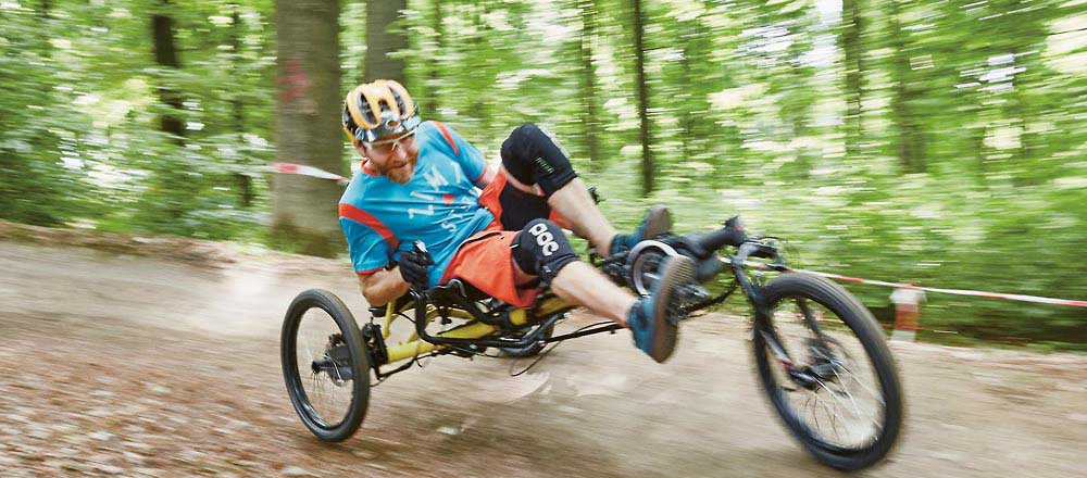

I am leaning towards the Hase manufacturer. Their line of .....
Configurator for mountain-trikes with sporty chassis
or just the standard kettwiesel. I do prefer a higher seat like my current Hase Lepus Comfort but it is no longer made.

The Kettwiesel Kross sure looks good with it's full suspension.
