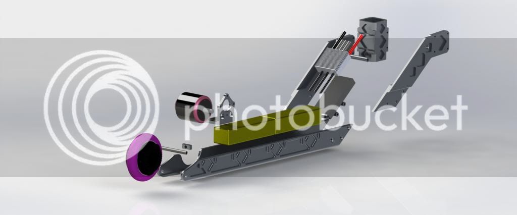

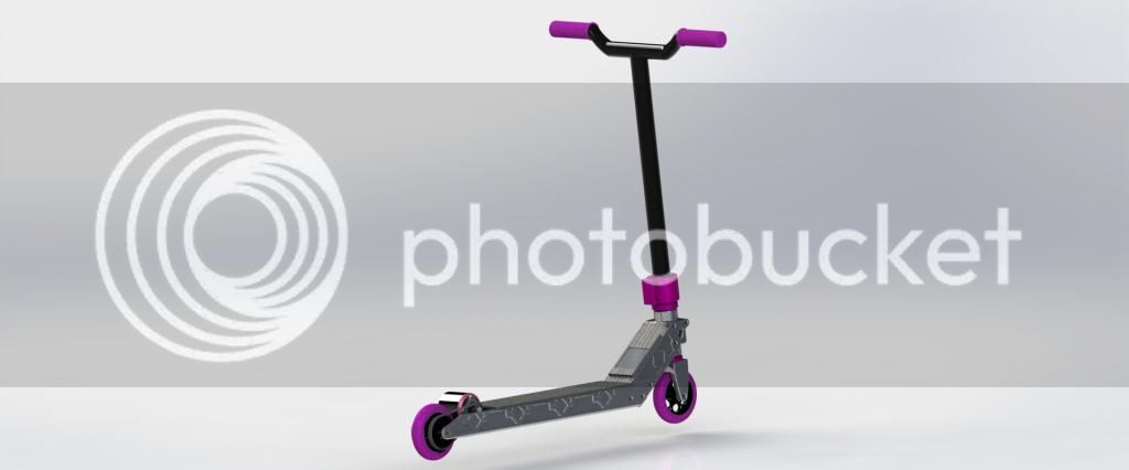

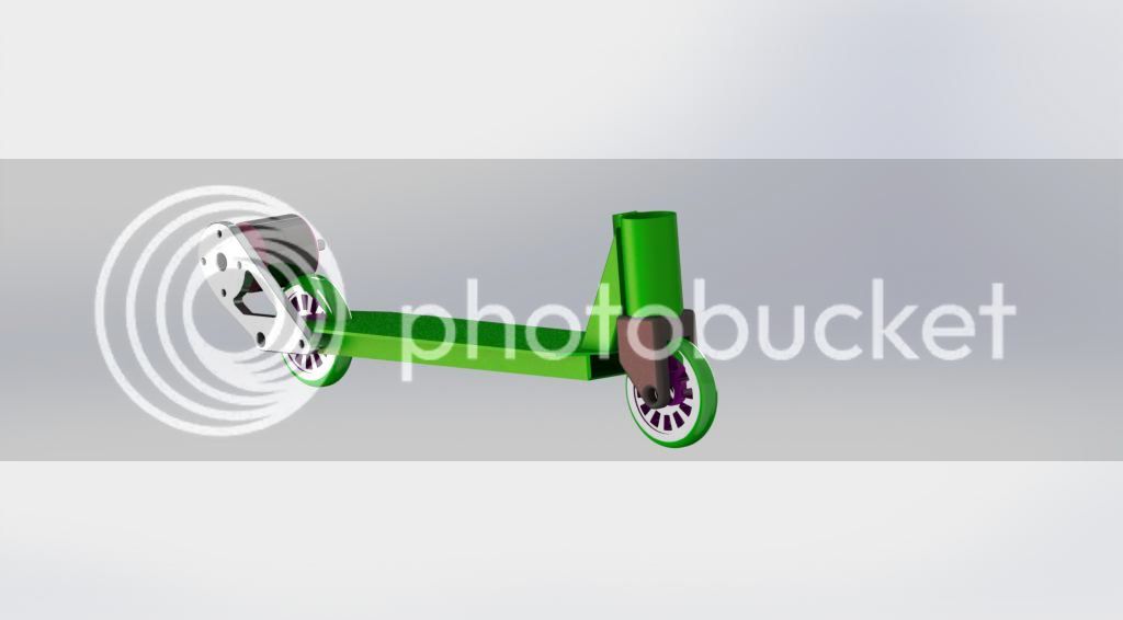

i've been wanting to do a stunt scooter for quite a while now but have not been able to find a donor deck that will fit all the batteries and ESC in etc..so I've designed it from scratch with all bolt together pieces..no welding..and pneumatic tyres for a bit of suspension...
design stage- so i considered an adaption of an existing scooter- but it looked ugly and had no storage space..
then i designed form scratch..with standard 110mm wheels
in silver-
exploded-

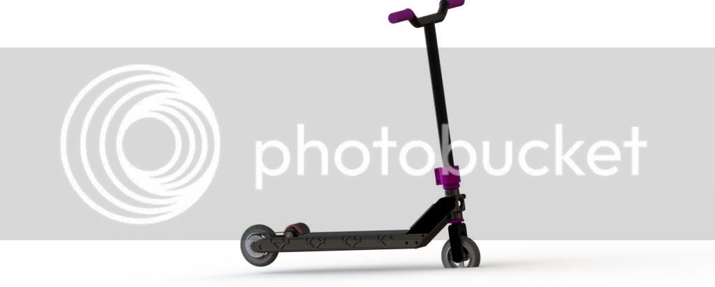

with pneumatic tyres.
Most parts finished just the wheels and forks to do..and some anodising.. then even if it doesn't work -ill have the toughest stunt scooter in town!!!

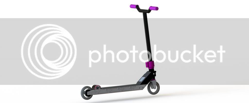

how it will hopefully look

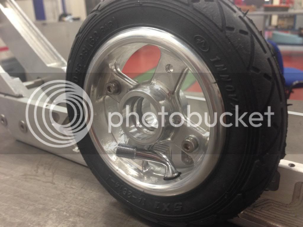

well i call it a stunt scooter but it will probably be in name only!! ha ..i will be lining the base with foam etc..and it will have pneumatic tyres..and if need be i'm looking at incorporating a MTB suspension in the front fork assembly.. i need to test ride it first on the tyres..

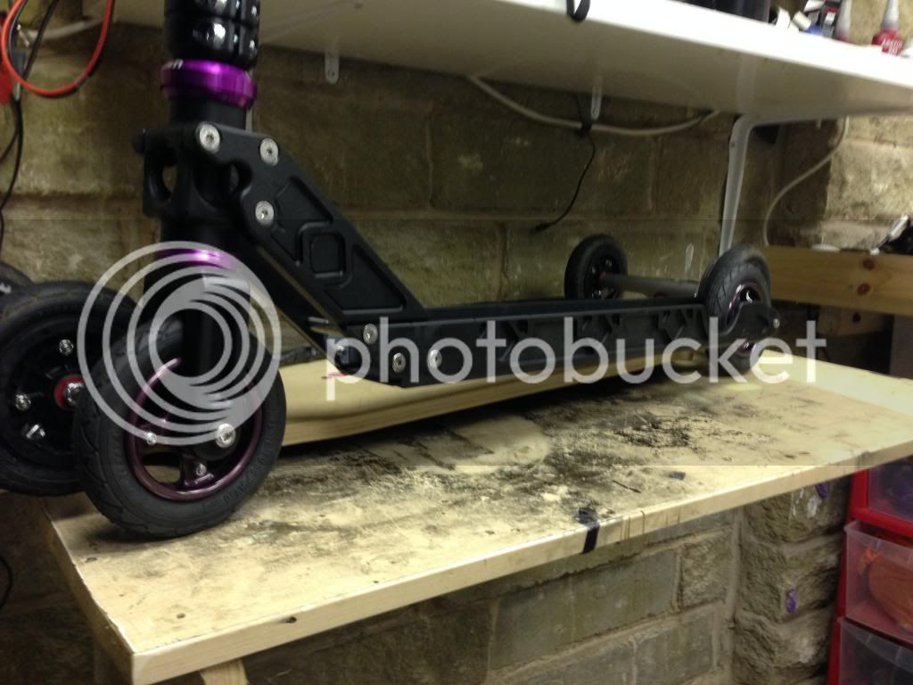

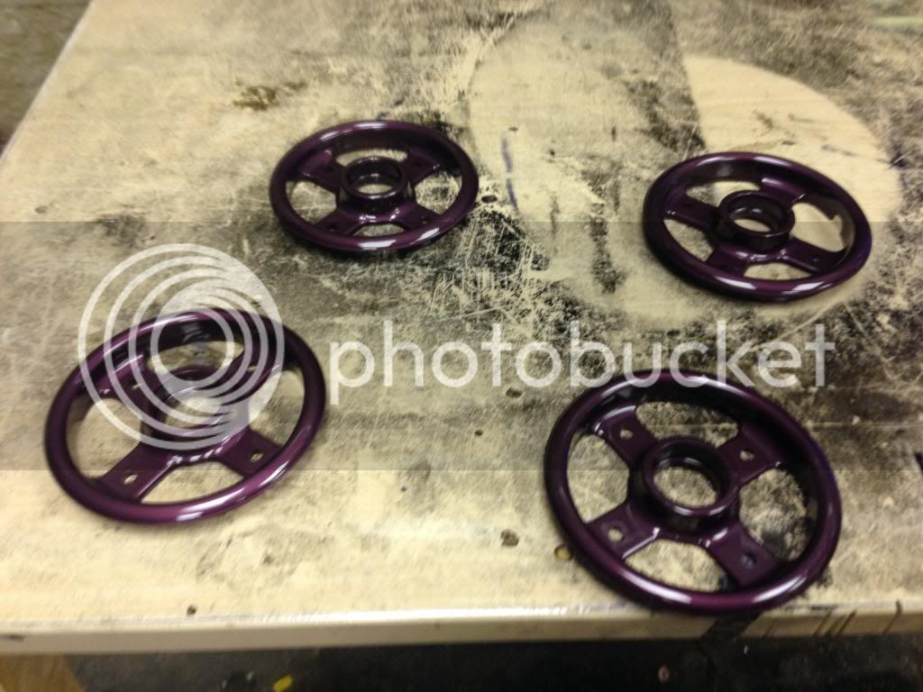

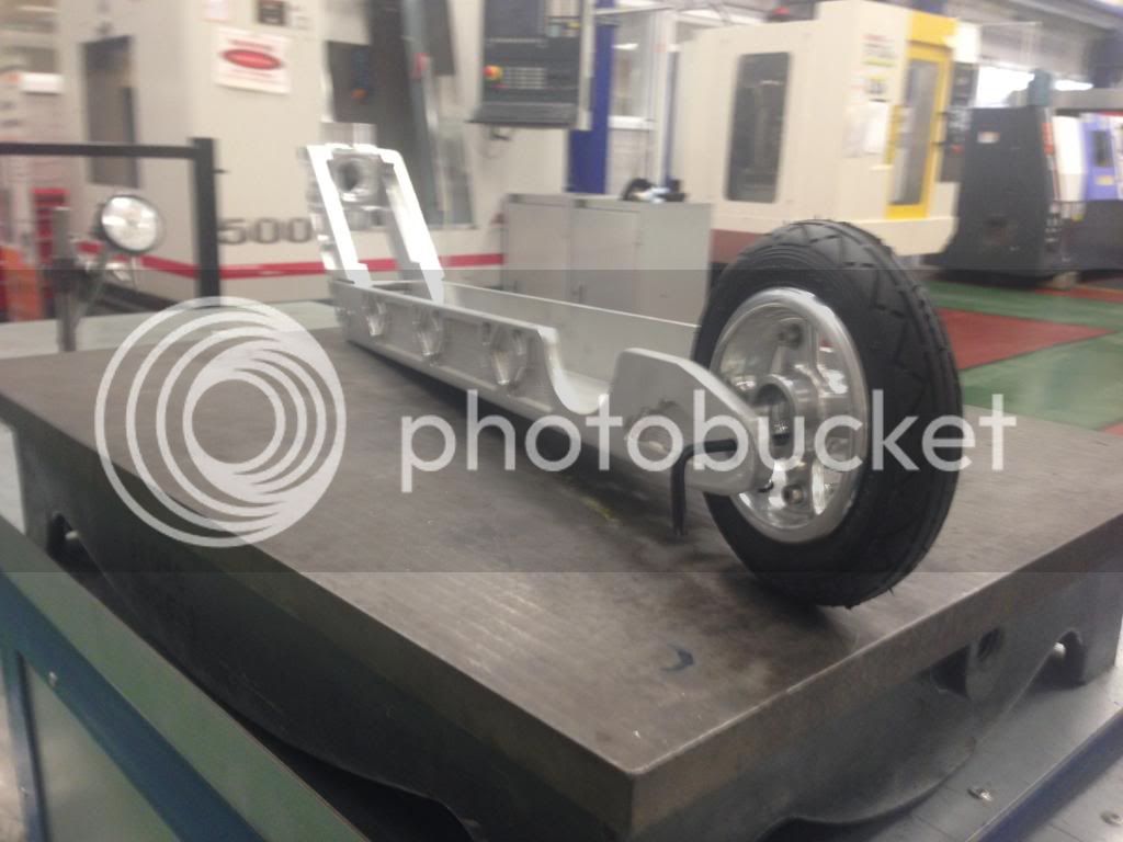

The scooter is coming together- wheels done,body finished..just some bars to buy and i can actually ride it ( pushing only)
Just waiting for my electronics to arrive from Bruno ( who else!!)
Nicely anodised and top coat lacquer!!
coming together!!

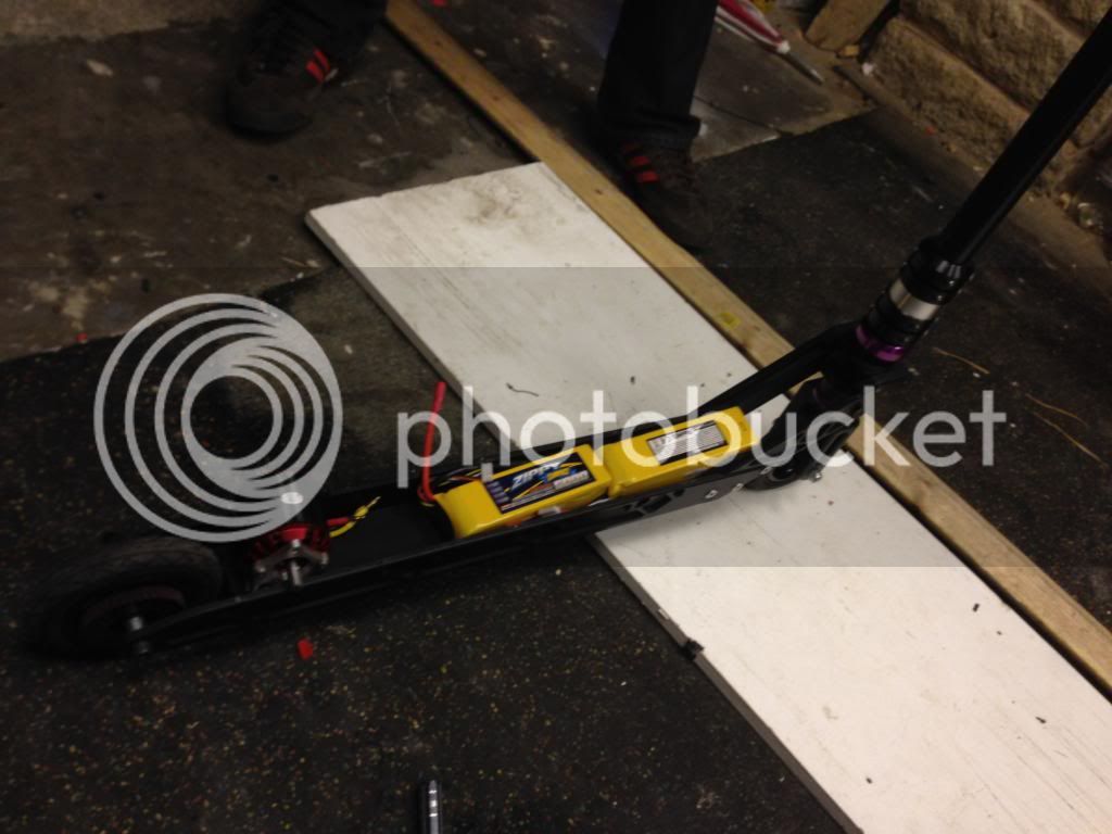

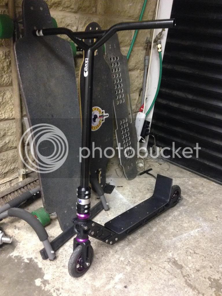

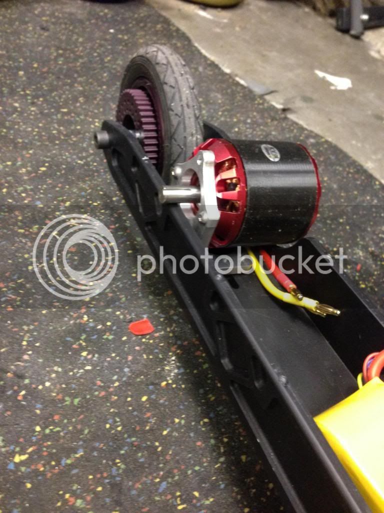

its a fully rideable stunt scooter with tyres now!! it super smooth just like the boards and rock solid ..Batteries and motors have arrived and i'm just waiting on the ESC - then its back to the build!!
(that's juts a temporary foot plate)

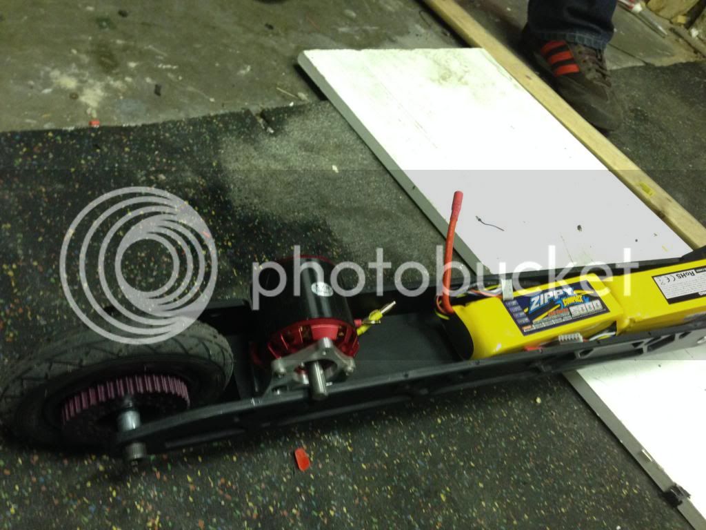

Ready for the ESC
motor and batteries are fitted- just waiting for the ESC,hand controller and drive belt to arrive! then were off!!

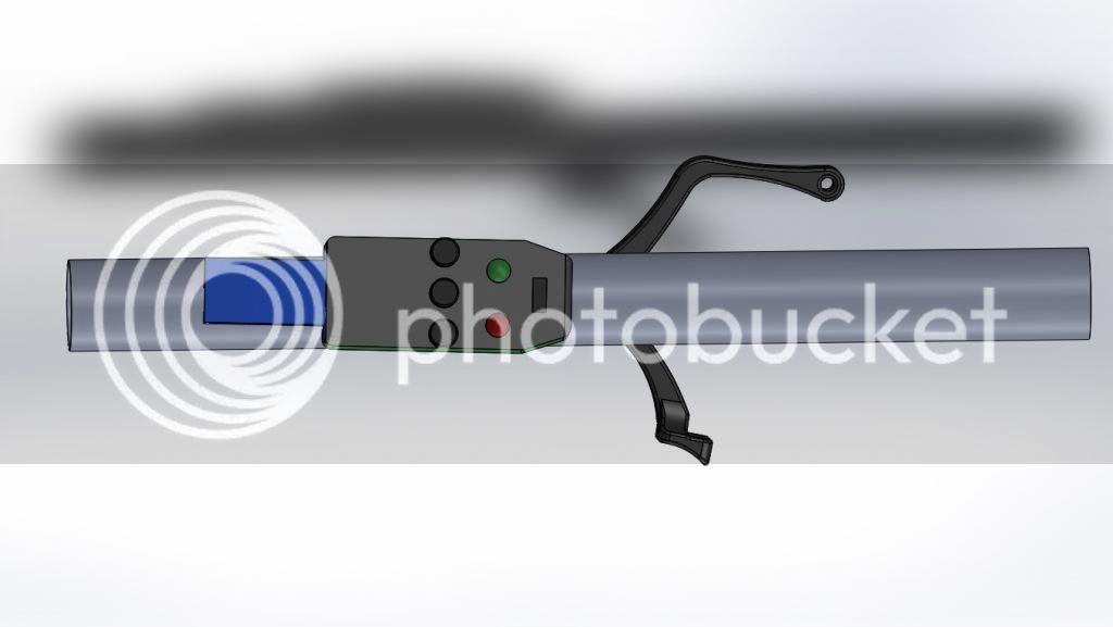

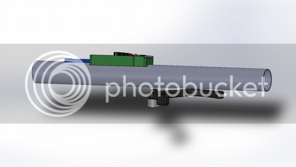

What i'd really like to do is use a wired throttle but i want to be able to use the b rake function,and none of the throttle allow this..so i'm thinking of using an Rc module with an adapted trigger so it would be wireless -so no wires to tangle in the bars and it will have a brake - any one got any other ideas I could try????
This is my thoughts on the hand control.it will be in a nice housing that attaches around the bar..so can be fitted to any bars..

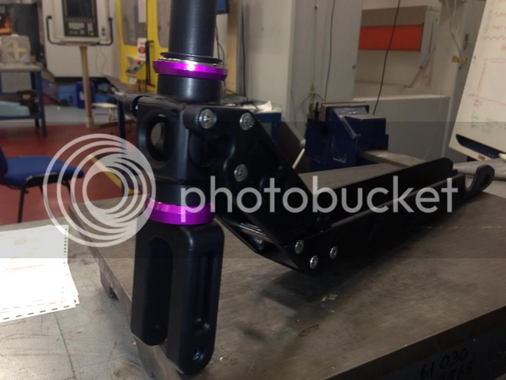

If you don't mind me asking, do you own all the machine tools in the background? Either way, nice shop! And nice scooter!
Also, how did you bend the bar stock around your rear wheel?
Hi thanks
No I'm lucky enough to work as an engineering technician and I get to prototype my parts then get them made in batches by a local Precision engineering company
That is standard c section Alloy stock .. I've tried using standard material to keep costs down .
