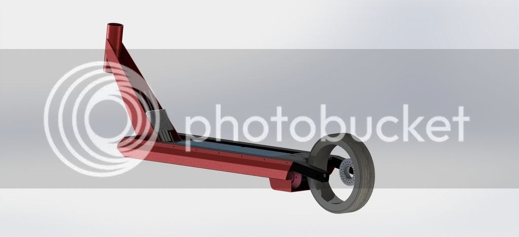

my concept design..
yep- all 3 are bigger on the 3WK model..
8" wheel ( now 5")
500mm x 150mm deck( now 350mmx120mm)
600mm wheel base.(now 400mm)

final design

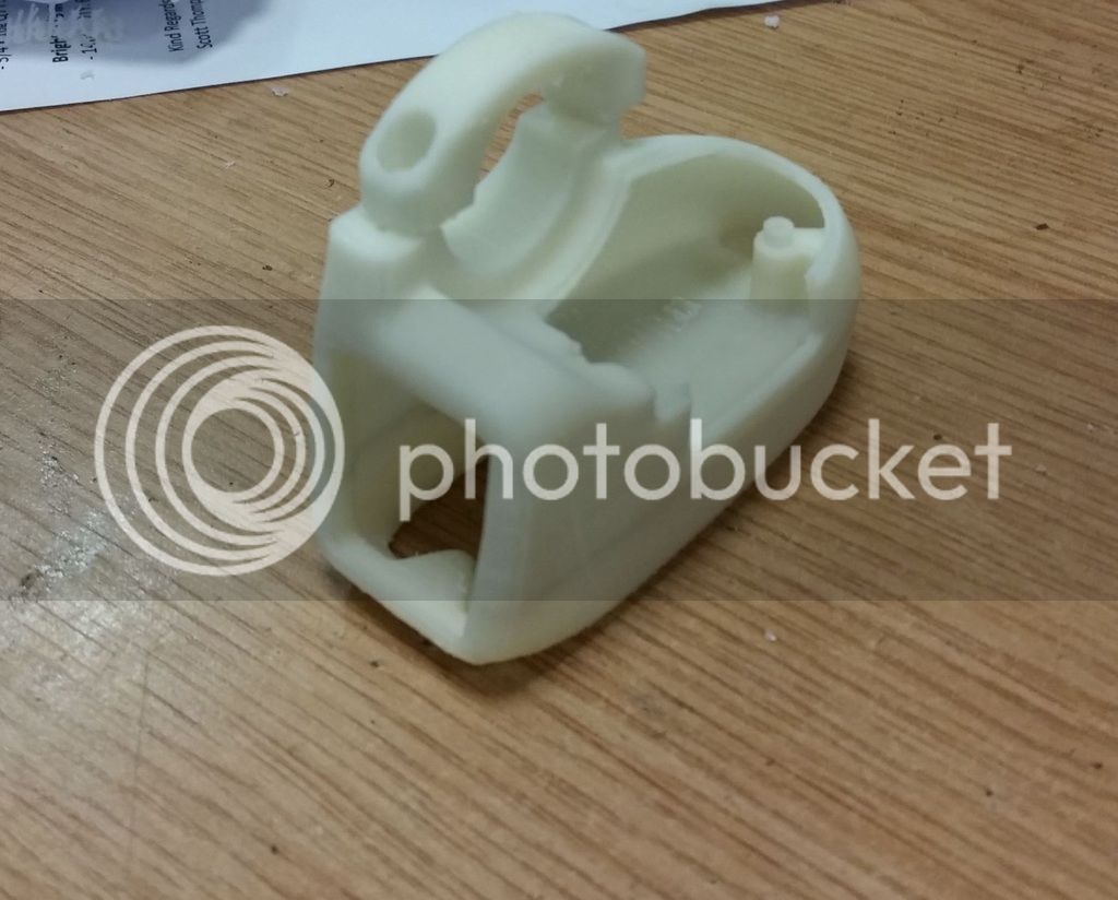

well the new scooter body is well on with being manufactured and i now have a new super sexy throttle control..(thanks to a very talented ex-student of mine..)
Its gone from a usable block to a nice looking piece of kit..
well happy with it..
The electronics fit like a glove and it sits perfectly on any scooter handle bar
We may change the design to a 2 piece split arrangement..but essentially this is the shape..
As soon as the remotes arrive from Bruno i'll make the STL available to download
