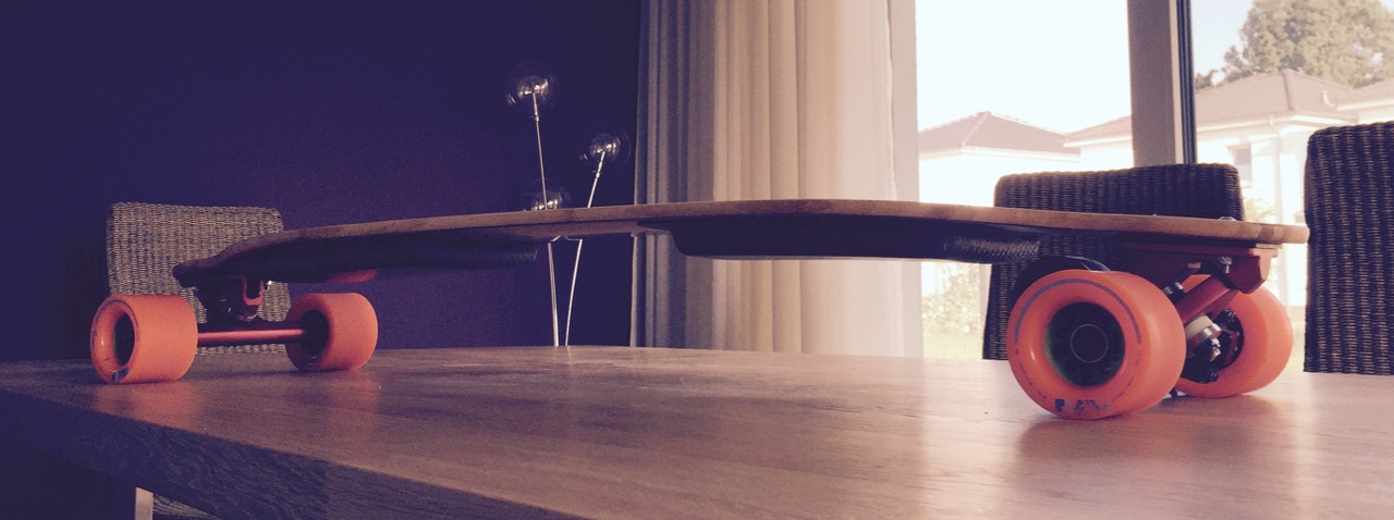

update 08/2016: switched caliber 2s for cast ronins with DIY truck adapters. never been happier with the vanguard, these ronins are insanely good <3
update 10/2016: added a 0.6mm bamboo veneer ontop with vicious griptape and 83mm trampa wheels

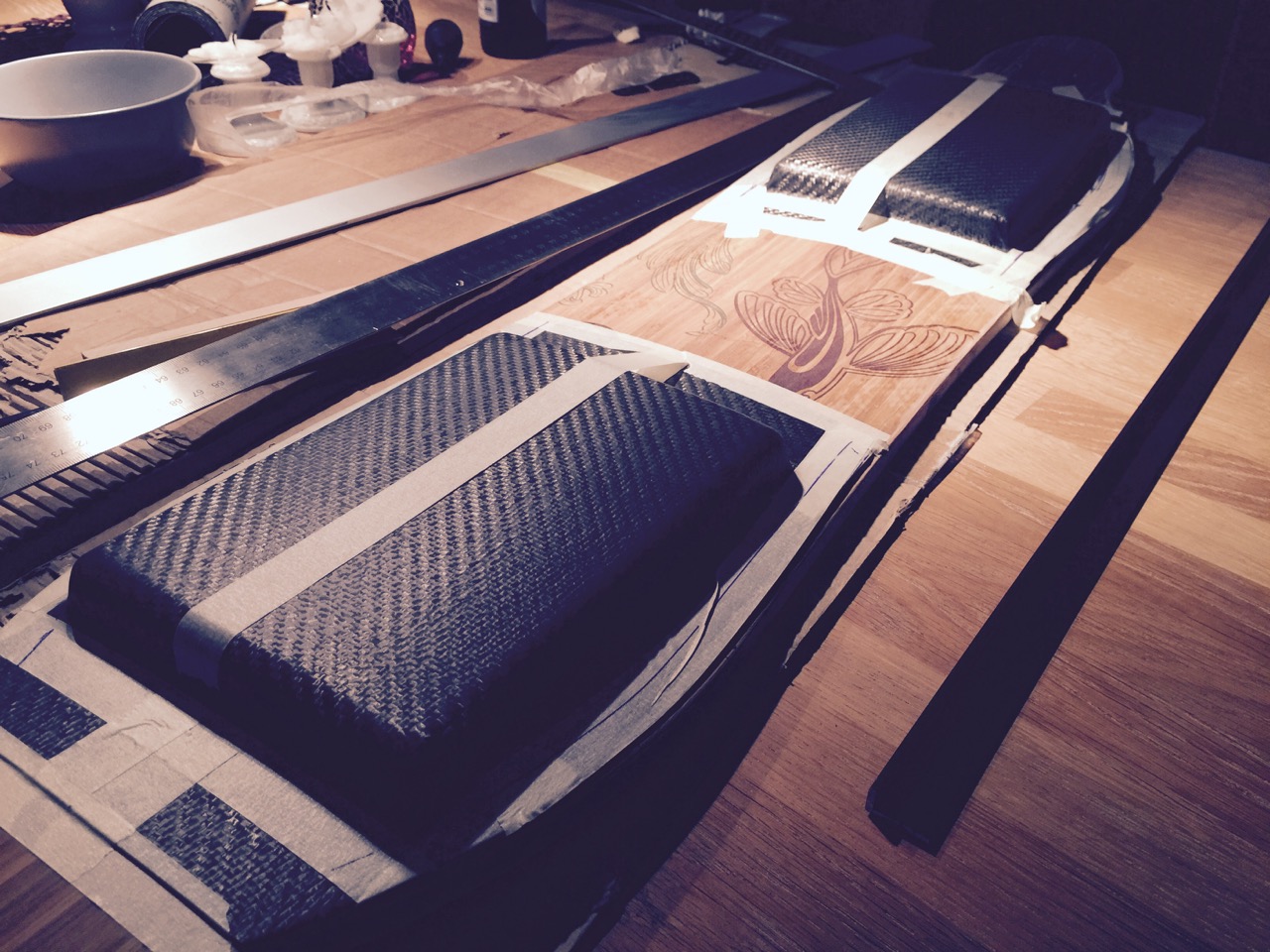

didnt want to dig into this board, so the enclosure mold needed to bend a little around the slight concave. I also wanted to preserve flex, so I went for the double enclosure setup like everyone else. since I already had the LG HG2 cells for my topspeed, even spot welded for the most part, I had to hide away my typical 10S4P setup somehow.
it was pretty straightforward, didnt feel like trying fancy crazy designs:
the space for the vesc can support up to 2 vescs and even 2 new vesc5.0. initially Ill go single motor though, possibly using the 168kV 6374 that I planned to use for my tesseract, which is running quite flawless though after downgearing to 15/36T.

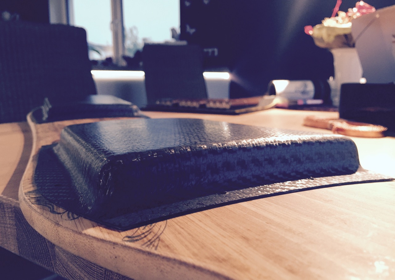

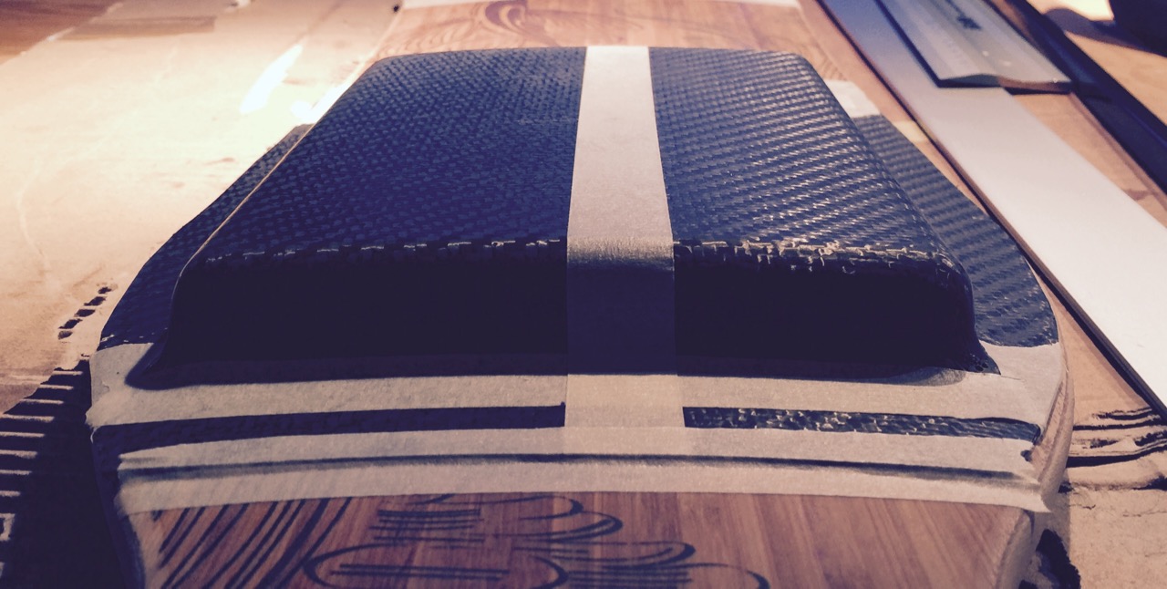

since the mold had to bend a little, I tried hard foam again instead of wood and prayed that it wouldnt deform under pressure like last time:
the enclosures look pretty large, but it will also be really slim compared to the other builds here - and the carbon will blend in better than the white/greenish foam. :p

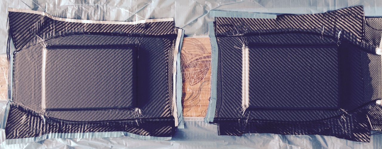

setting up triple layer carbon + 2 layers gfk, curing 24hours et voila. happy I didnt have any serious deformation, just one edge is sliiightly bend, rest is pretty good.
after some rough cutting and sanding, I checked the inner cavity: guess the batteries fit as planned!
first time that I have a bent enclosure, gently following the curvature of the board. thanks brave foam, you kept up this time despite bending!! :D

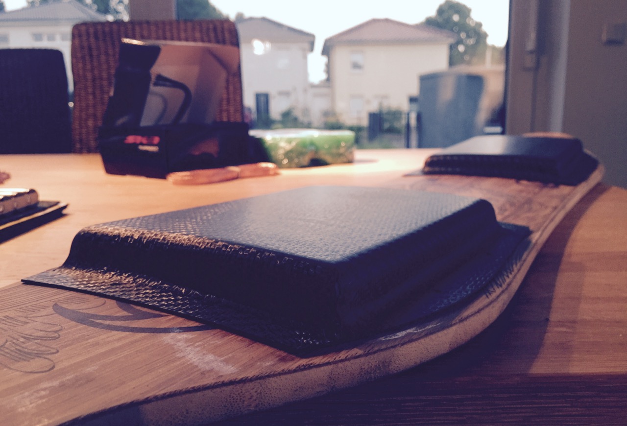

finally aligning the 2 enclosures! the sanded surface looks pretty good! :) want to cut the enclosures now following the curvature of the board with an offset. also Ill have to drill holes and I really need to take my time for that.
Im mostly taking old parts for this build right now, not sure if Ill order anything new. still thinking about how to connect the 2 enclosure and the motors. I actually bought flat copper wire, so I wouldnt have to dig deep. then again, after my excessive topspeed routing, I dont feel like digging at all. :?

cut and sanded the enclosures now - left a lot of meat around the screw holes so the carbon wont tear. additionally, the carbon is reinforced around the mounting lid by 4 layers of gfk in total (I learnt from my tesseract!):
some impressions from the side to get an idea how slim it is - cant get slimmer with 18650 cells:
love the vacuum bagging, its a super snug fit directly on the boards surface and I havent even put in any screws :)

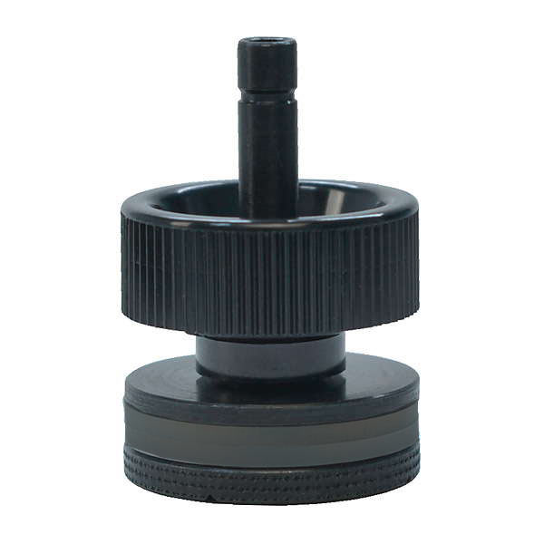

What's your vacuum setup for this? A membrane and simple valve - leave it in vacuum for the full 24 hours or how long? I want to do this and have some of the gear, so need to practice and refine the process.
Thx!
Thx!
yea, Im running a diaphragm pump with a manometer and a valve attached (best vacuum I had was -930mbar):
-> into this:
which makes it very easy to connect to just about any sort of vacuum bag/membrane! cure time depends on heat and resin, but the resins Im using usually cures 24h at room temperature.
the vacuum bagging gear is the best stuff I bought in a long time! :)

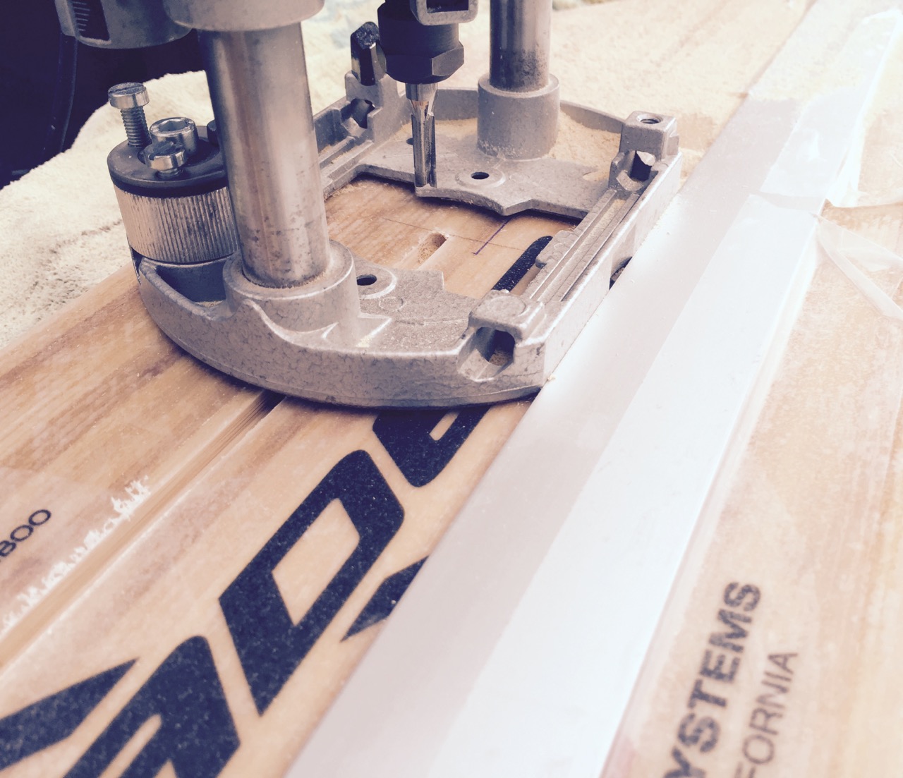

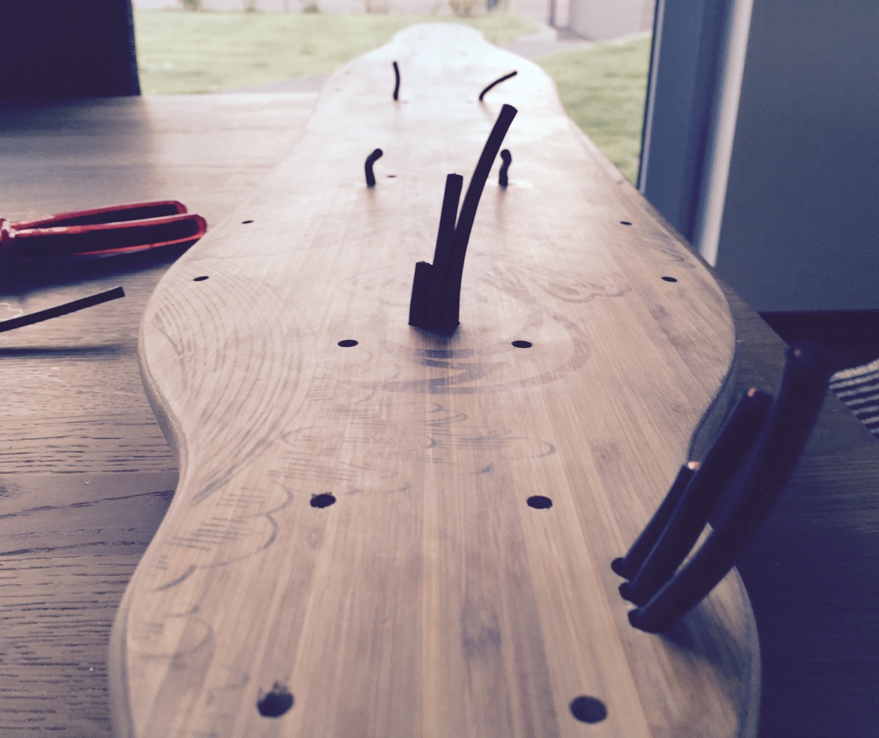

i kept thinking about motor and battery wires - had to connect the enclosures somehow and after sinking in my wires on my tesseract AND topspeed, I couldnt really go back to visible wires anymore. only forward, never back! :p
this time I was more careful with the routing and used some flexible aluminum profile taped to the board as router guide. my colleague will never see his router again ha haa! :lol:
I managed a really pro looking 10AWG channel and drilled the exit holes:
I then did the same for the motor wires, but couldnt really work that well with the aluminum profile, so the cuts are less awesome, but still nice that I wasnt ashamed to post it:

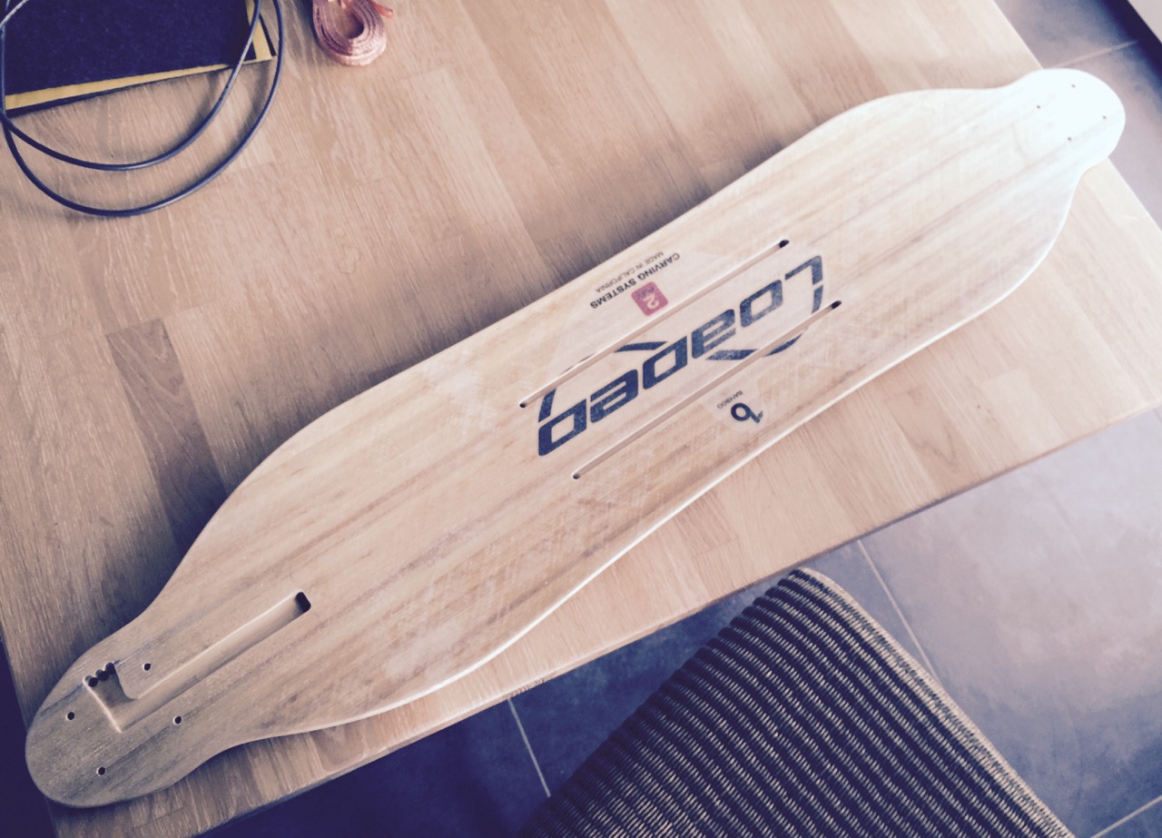

whole board:
and backside with all the holes for enclosures in as well. still waiting for the threaded nuts that I used in my other builds:
just because its a beautiful picture :)
I rounded the transition to each drilled hole so that the cable wont be stressed and easily bends around the corner:
10AWG wires inserted:
and the same 10AWG for the motor wires. decided to go 10AWG instead of 12, because I planned to use a 6374 with max 80A vesc settings. its probably slightly overkill though, couldve saved 3mm channel width and 1mm depth, but somehow Im not too worried about destroying the board. if it will turn out a little too flexy, Ill just add one layer of carbon on roadside.
finally all exit wires! Ill glue in the exits at the motor with female gold connectors longhairedboy-style - but thats not done yet, didnt want to fixate the cables before Im sure everything is perfect. if the board is too flexy and I have to add a layer of carbon, it would suck with fixated wires sticking out at roadside! 8)

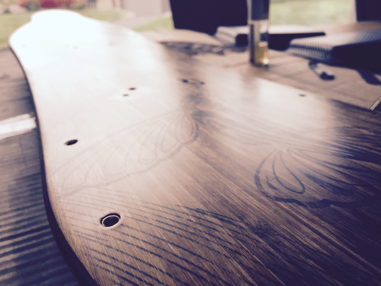

today I didnt have much time, so I just added the stainless steel threaded inserts to the board - 8 in total! also I sanded the board and oiled it. why you ask? hehe, well, admittedly I screwed up a little bit when I made the enclosures - at 2 points some resin made it onto the board and covered an area of about 16-20cm^2 even though I thoroughly taped it - probably stupid capillary effect. I felt pretty down cause everything was supposed to work out perfectly for once ... but yea, of course it never does. I tried to fix my mistake by supercarefully sanding these parts and OF COURSE I went just a liiiiitle too far and scratched the glossy surface. knew it in advance, had to happen, happened! :p
in the end I gave up of the idea of an untouched perfect board and started sanding all the glossy parts down and suddenly the board started to get this really weird look, like my 20yo worn down strat. everything smelled like wood, the "made in california" was partly sanded off on the roadside print, and I felt like the board would actually look really cool oiled with aged artwork, so i actually went a little further and partially sanding off the art and really, I started to love it. came a long way from "doh :evil: " to "hey, thats actually pretty cool! :eek: "
but judge by yourselves :wink:

Are those thread inserts pushed in from the top or from the bottom? Also, and recommendations on how to drill those holes accurately at an angle? Cheers!
they are drilled from the bottom, about 1cm into the wood. Im using the old drill press of my granddad which is the only reason I have a halfway decent accuracy. this time I have been more accurate than ever, not a single hole is more than a millimeter off! one big part of the success was my new flexible steel ruler though - 10€ and one of the best items to work on 3D mold surfaces. :)

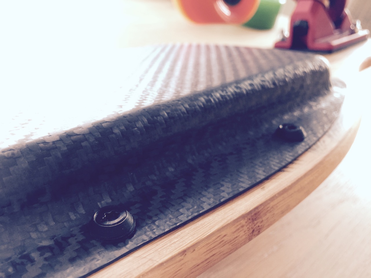

I got the hard stuff done and Im really proud of my results this time - the board looks great, does not rattle, no airgap even without foam/rubber between enclosure and board - just a perfect fit. I can even exchange the enclosures mounting positions, thats how accurate I have managed to do it this time (dont ask about earlier builds really). :p
I fixated trucks and enclosures, the latter with 8 screws each with a wide countersunk washer and a rubber washer below that. it adapts to the small irregularities of the carbon surface and really nails down the enclosure to the board (very slim double sided adhesive tape between board and enclosure), so it wont move and tear out screw holes when the board flexes.
