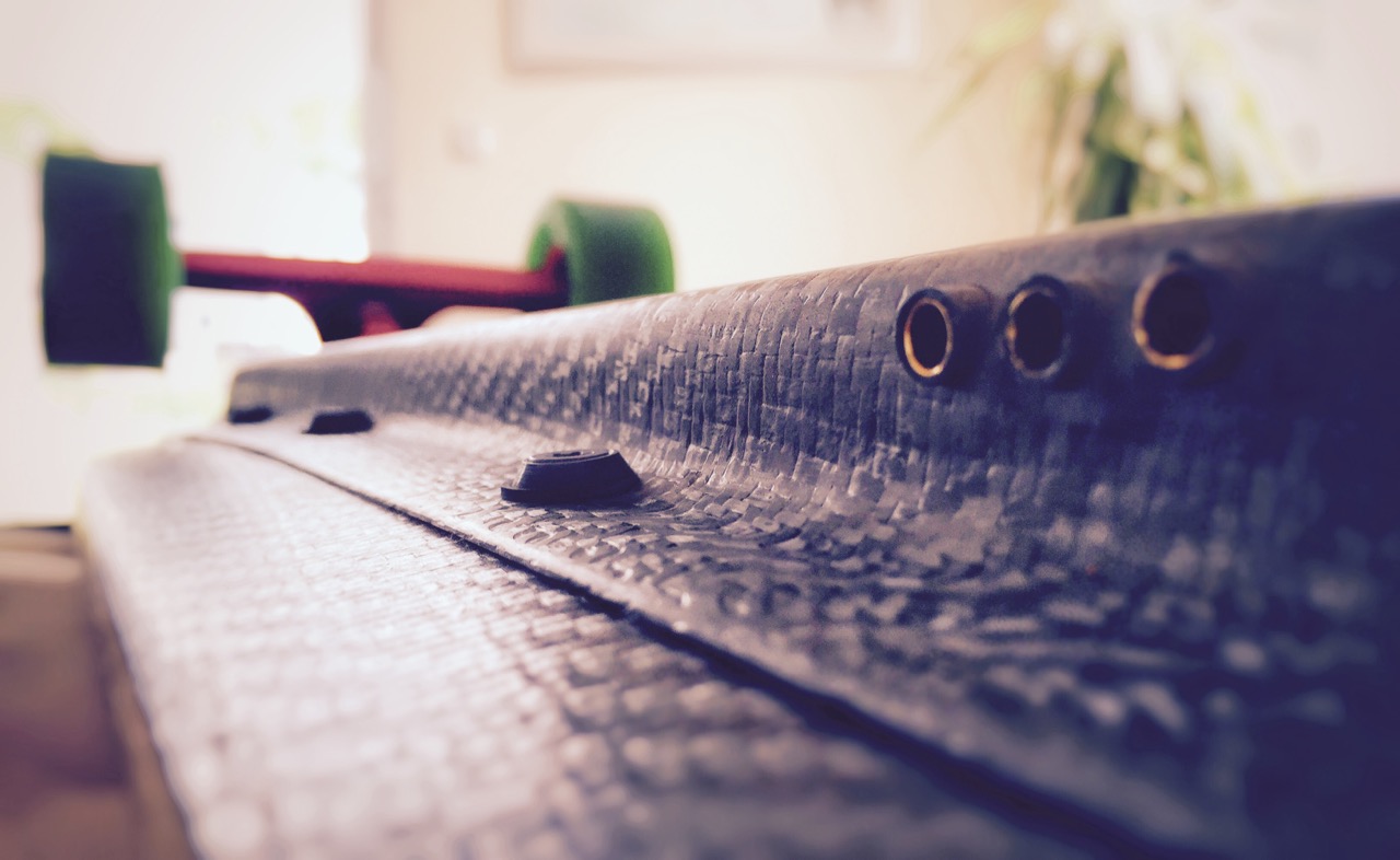

Can't figure out what kinds bolt your using on the enclosure, is that a rubber washer ?, maybe that is helping the flex?
I think i will also try the 6374 for comparisons on my next board (192 or 168 KV ??),...looking forward to seeing how yours will perform !
yea, I think most of us gear for too high speeds, Ill try to have max speed closer to what I ride on average, so probably going for 15/36T with the 168kV sk3 for a 43kph topspeed. if thats too slow, ill go up to 16/36T gearing again and check how it works with the larger lower kv motor - dont think gearing down the motor pulley is generally a good idea for the maximum torque transfer.
on my enclosure, I got 1mm thick rubber washers with these kind of black stainless steel washers ontop:
edelstahl-scheiben-rosetten-nf-e-27-619-14305-rosetten-aus-vollmetall-gedreht-nf-e-27-619-edelstahl-rosetten-aus-vollmetall-gedreht-nf-e-27-619-14305-m-12_b2.png
used that kind of setup to first of all allow quite high pressure on the enclosure without scratching or breaking it. between board and enclosure is strong double adhesive tape and the rubber washer ontop is really keeping the enclosure in place perpendicular to the screw. Im 100% sure that the enclosure isnt moving relative to the board at all! 8)
