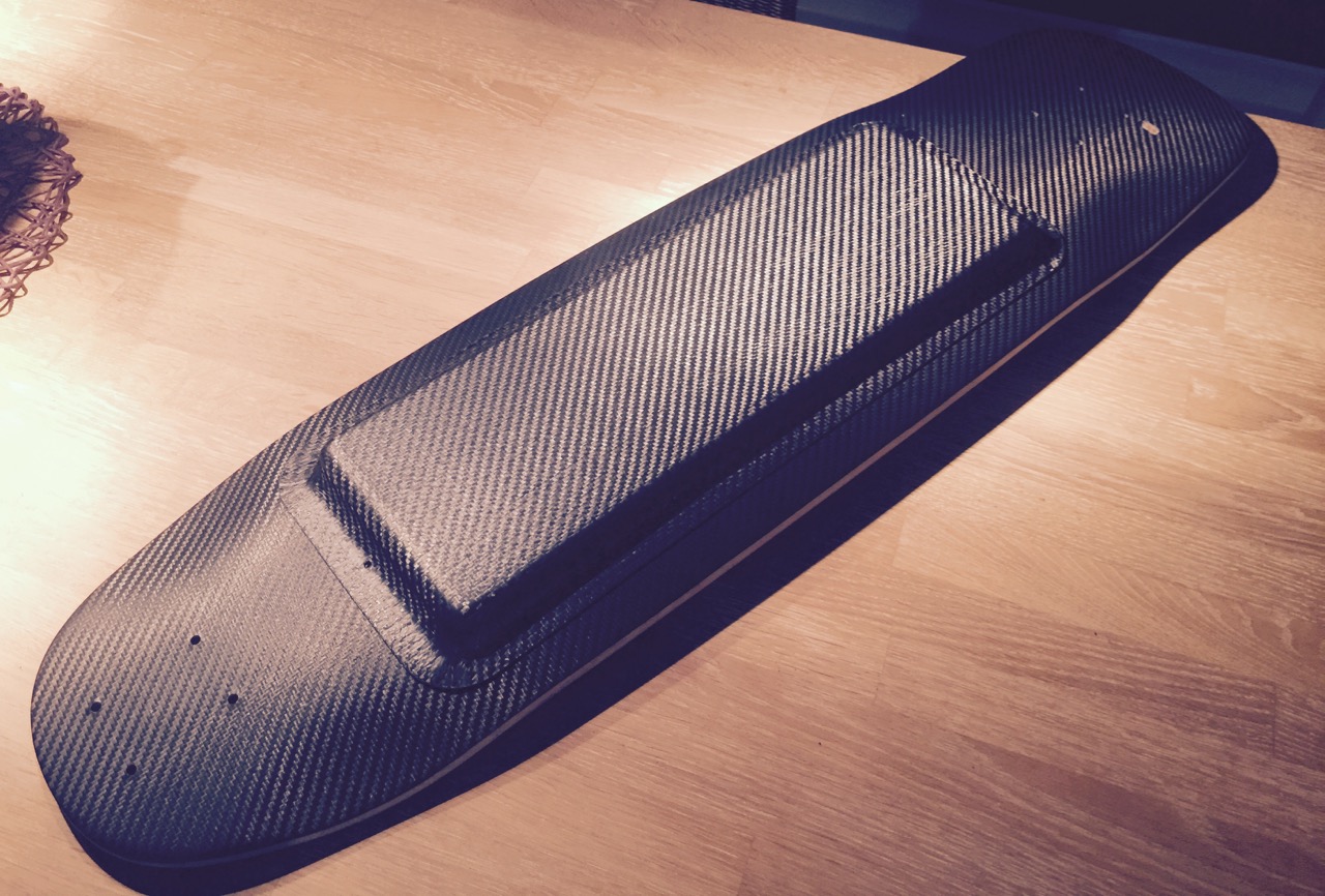

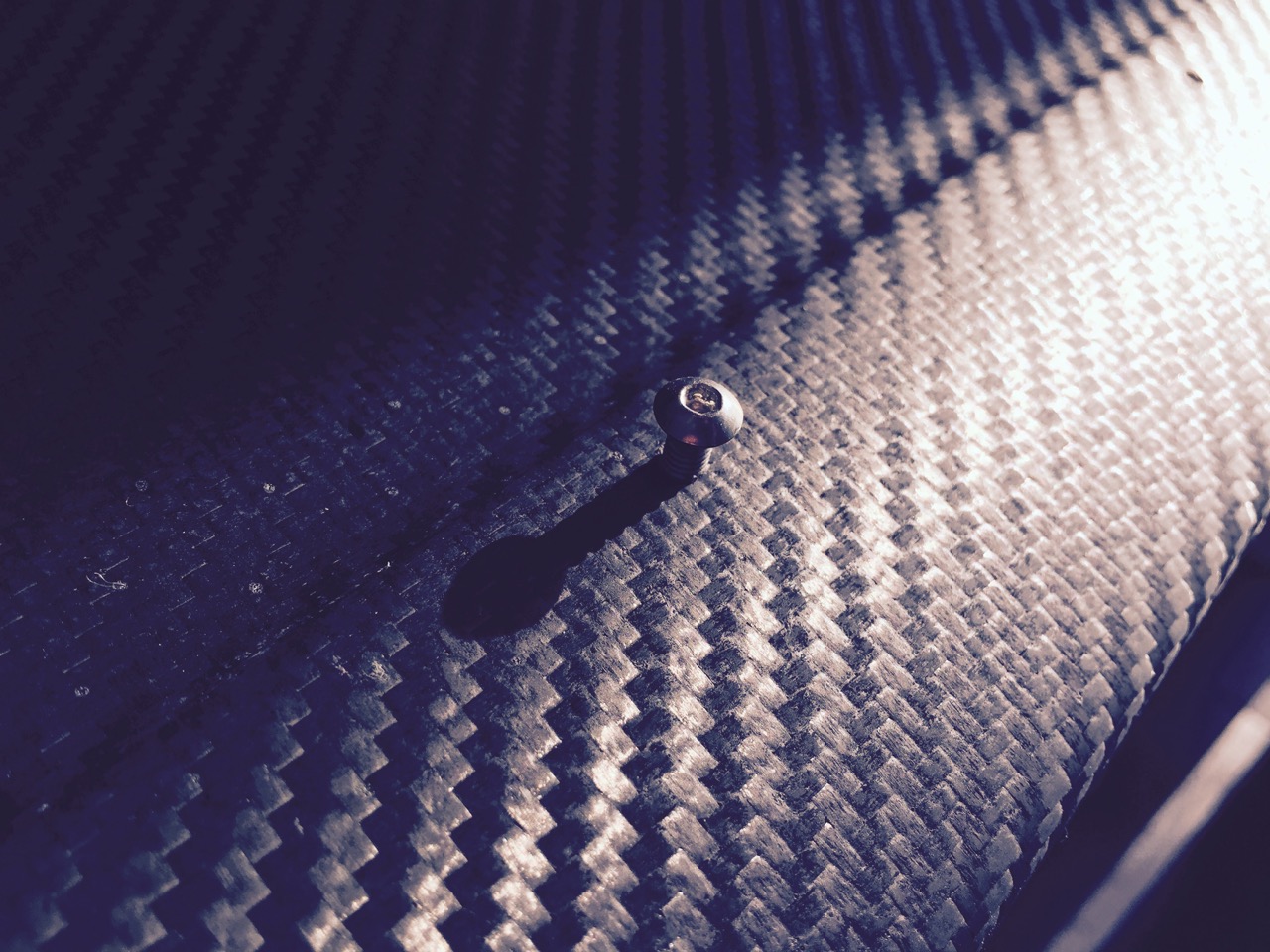

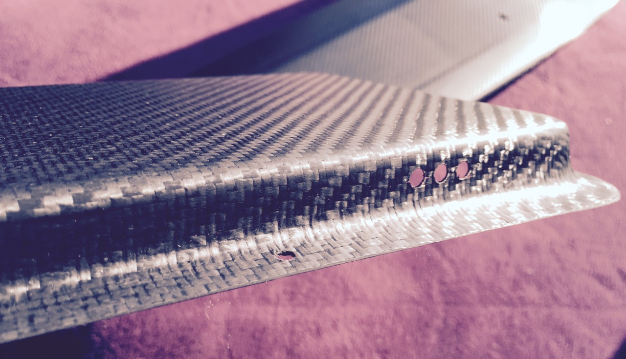

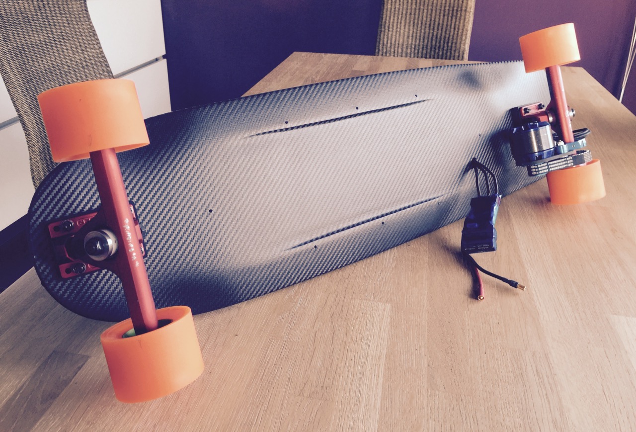

after several fail resin coats I sanded down EVERYTHING and started over. this weekend I finished my work and Im really happy this time. shouldve left the board as it was in the first place, but guess trial and error is what makes life interesting.
what did i do? vacuum laminate board & case once more and then simply 30min sanding by hand with 1000grit paper under water.

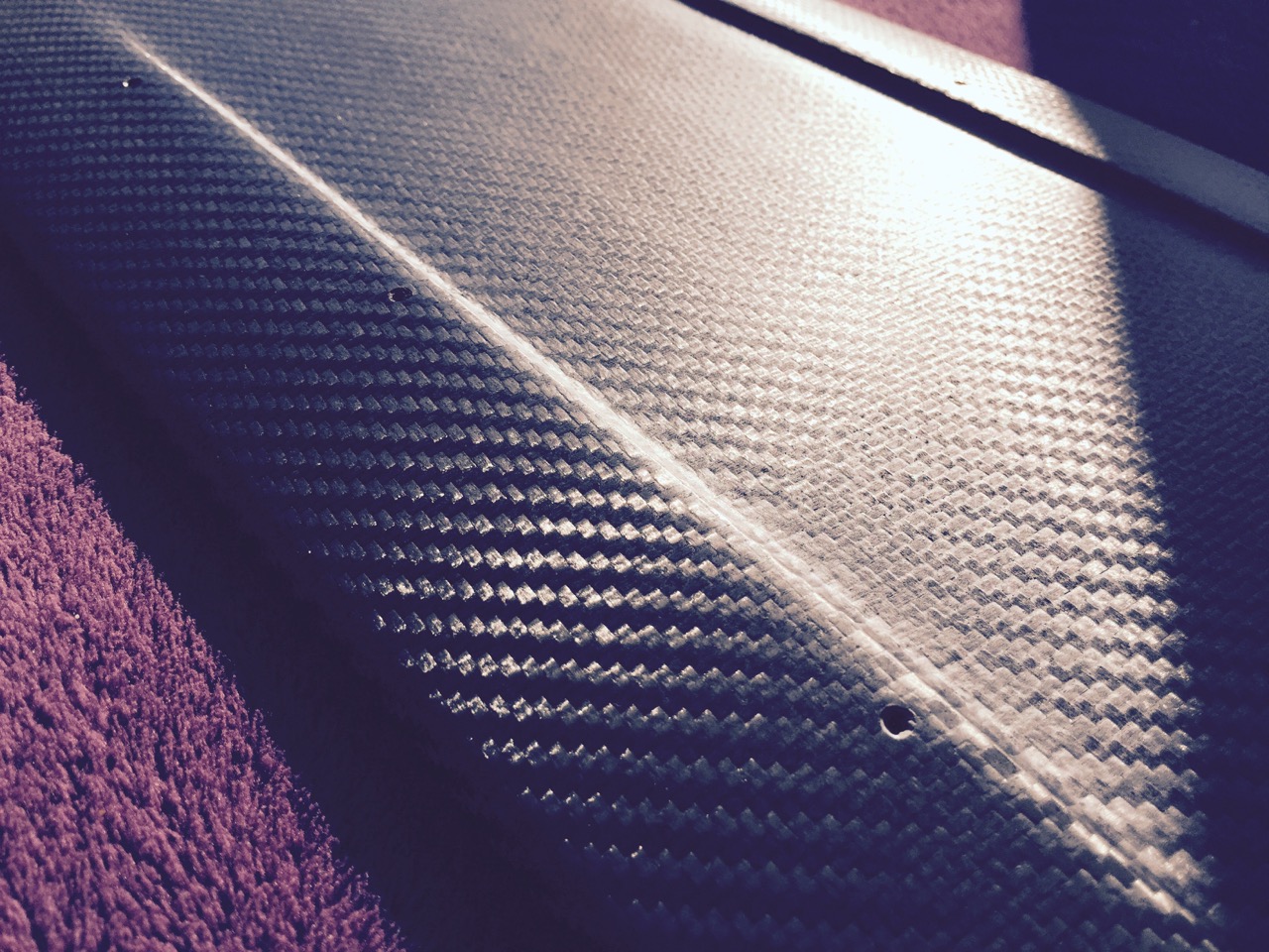

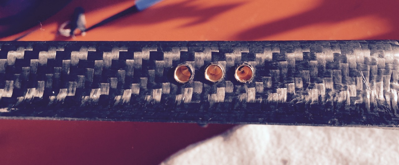

I kept thinking quite some time about what to do with the m4 inserts and what to do with the motor wire channel. finally I used wax/plastilin to cover all holes, laminated over it, carefully examined the surface to find the wholes after the resin had cured and drilled the wholes open again. I gotta say - some of them were BARELY visible, I helped myself with the enclosure a little bit and to my suprise I found ALL inserts on first try, so it looks extremely clean now!
gorgeous surface with the neatly hidden M4 inserts under the 2nd carbon layer:

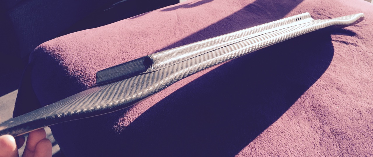

motor wire channel - its still sliiiightly bent, but a lot less than on my first try:
*gasp*

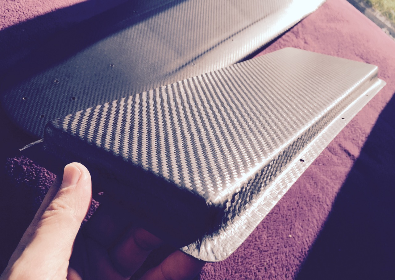

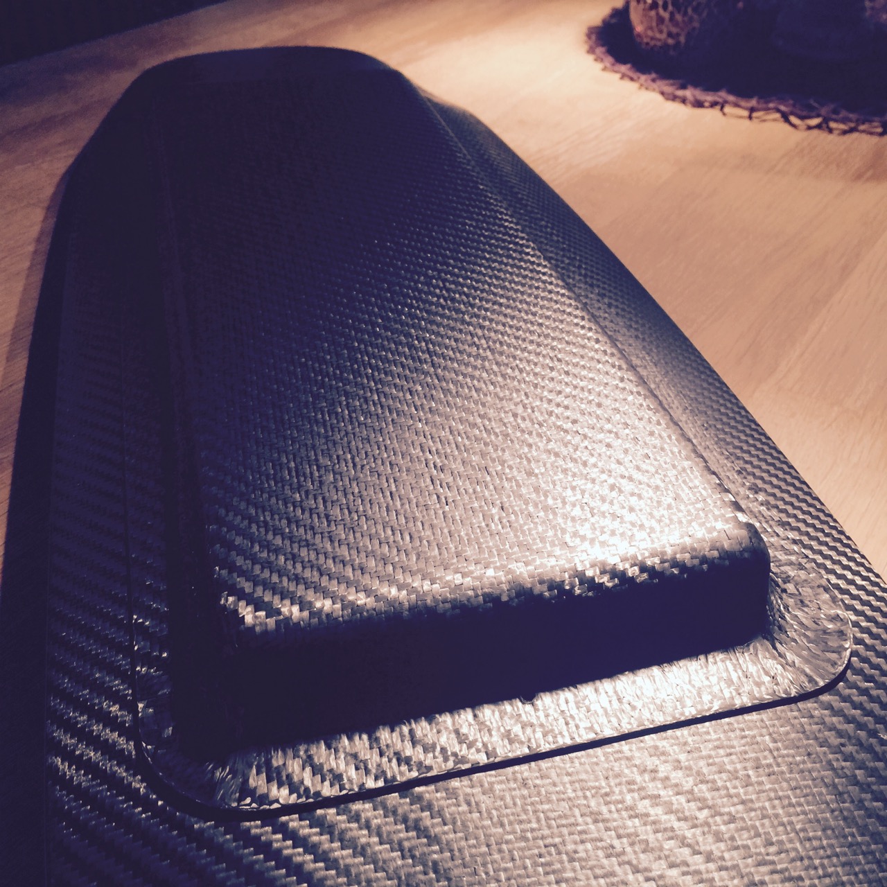

the enclosure:
with the 3 holes for my loop key & charger:
extremely flat, I think you cannot go further really unless you go mad with routing on the board:
the hidden inserts are really beautiful.
same hole without a screw:

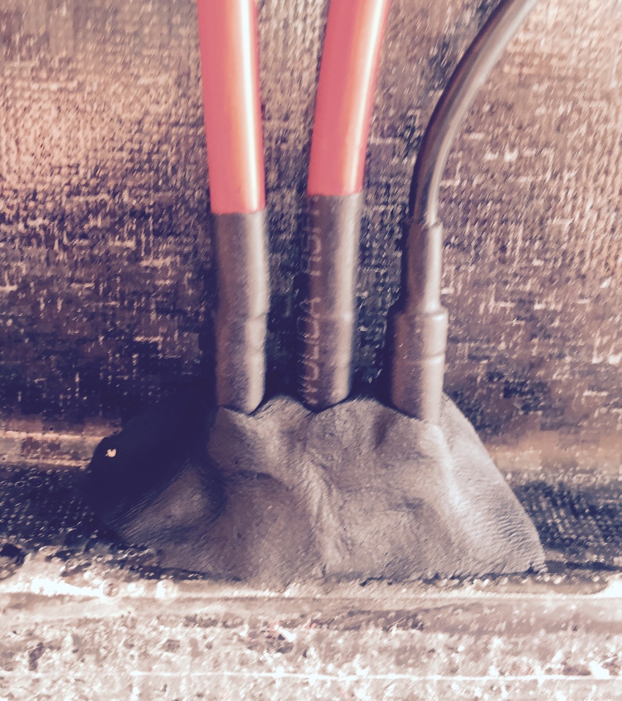

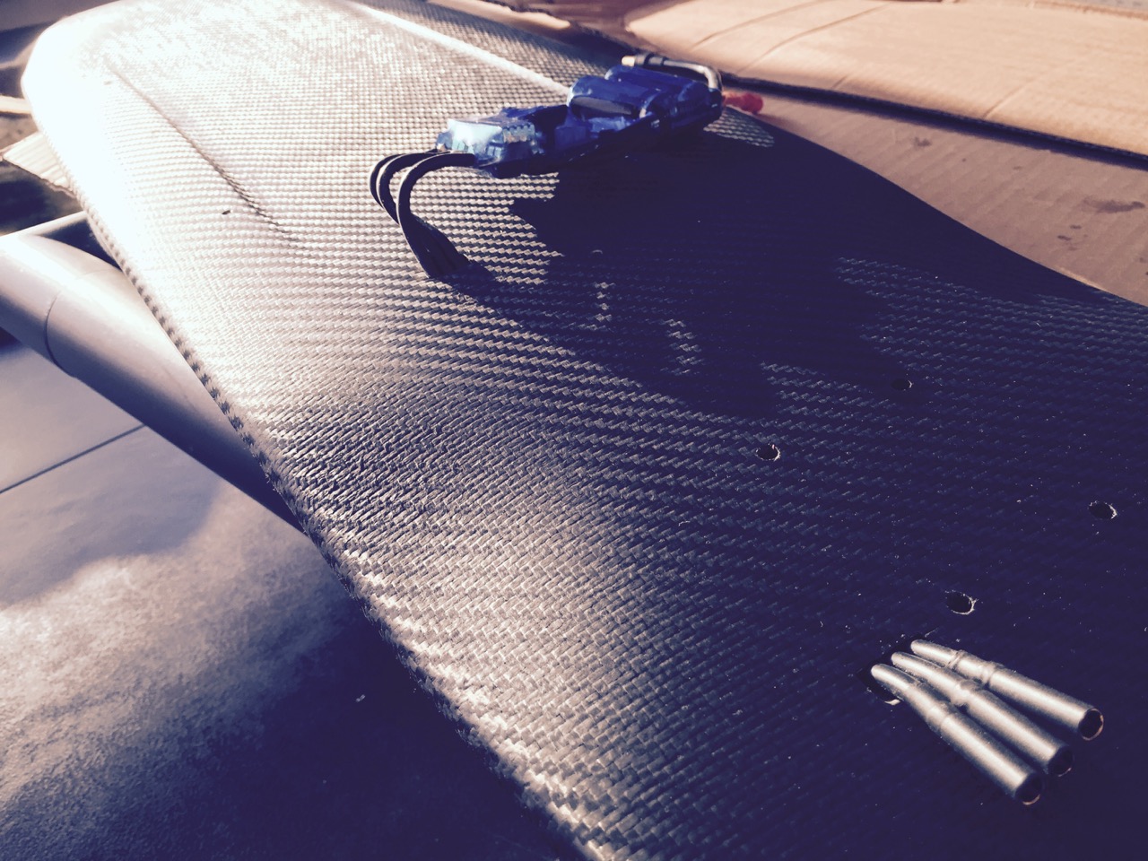

the enclosure 4mm gold connectors are fixated with something new I wanted to try since months: sugru! -> https://sugru.com its like clay and dries up to become some semi-hard flexible connection. tomorrow ill know more :eek:
there we go - same connections like in version 1:

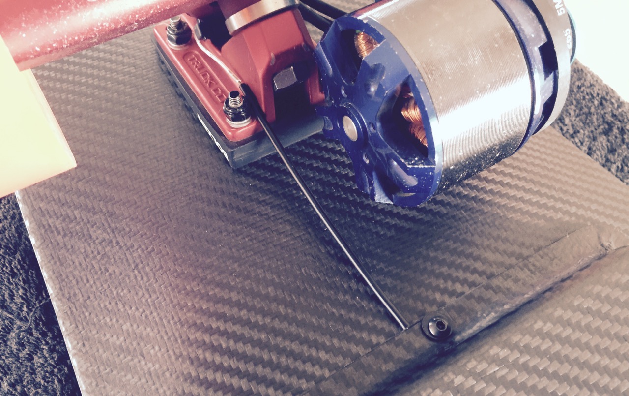

motor wires inserted into the channel and vesc simply soldered onto the wires. I needed a flexible connection - with gold connectors I wouldve had too many stiff elements in the chain.

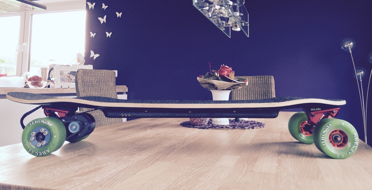

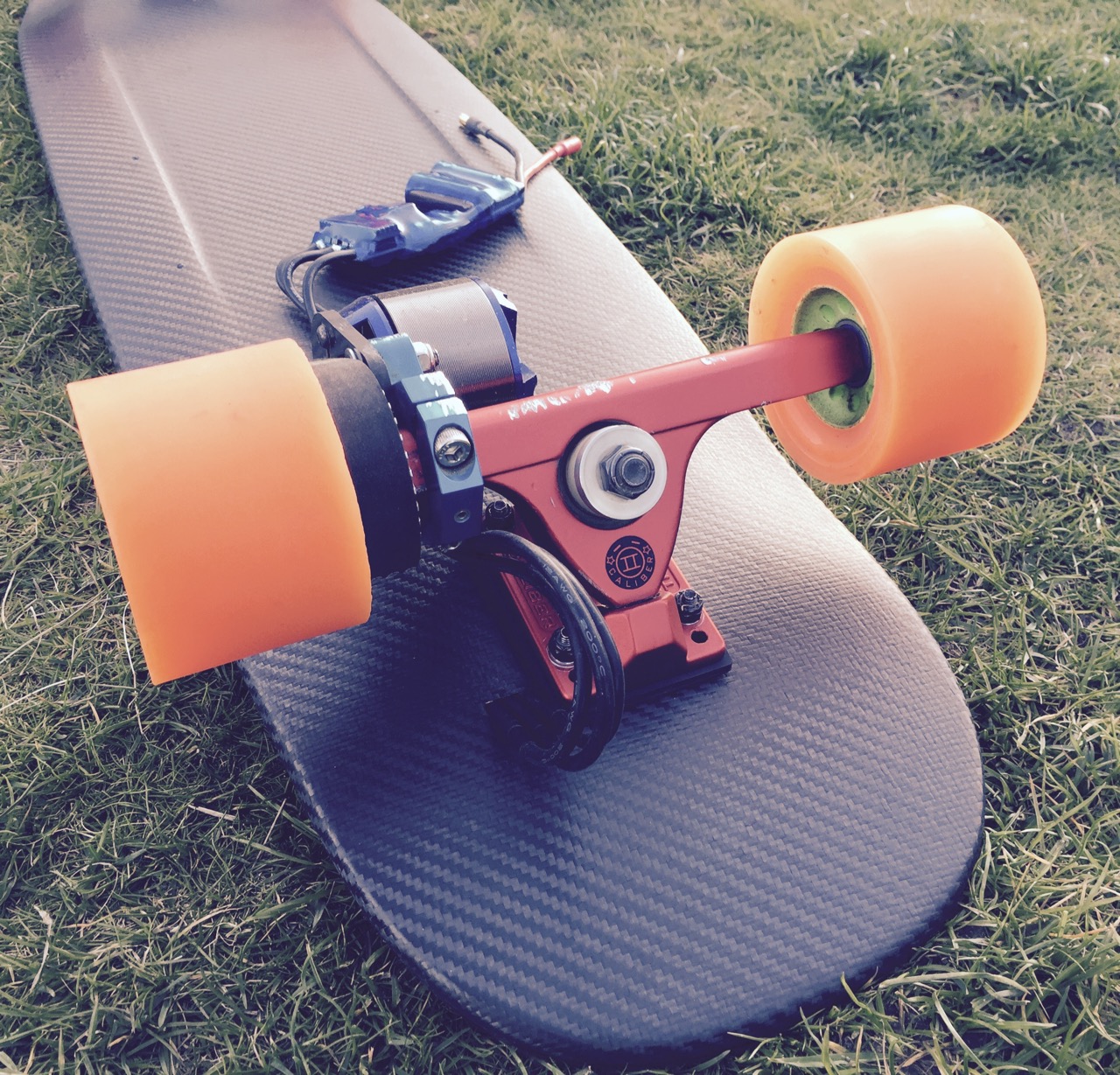

new vicious grip tape and trucks back on - guess I might have to shorten the motor wires a little, but Ill skip that for now. the longer the wires are, the less strain on the motor wire exit. killed one engine already with too short motor wires, doesnt need to happen again!
and thats it:

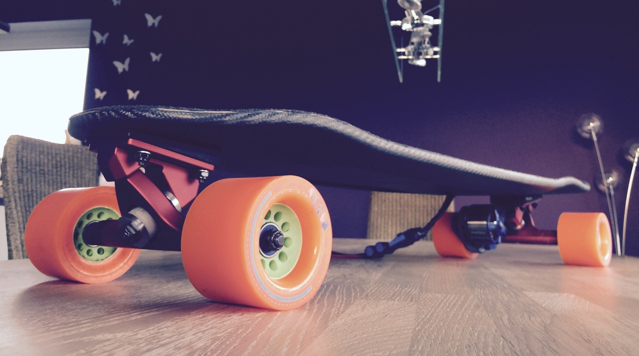

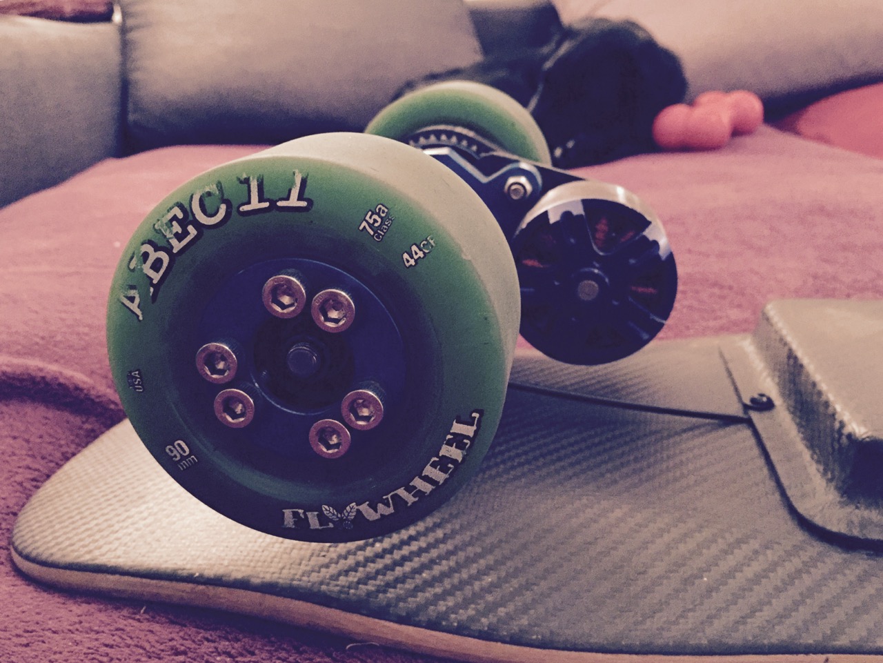

I REALLY dont know why I keep trying the kegels. guess I want them to be good cause they look cool, but god, the 90mm abecs are just so much better for cruising, carving, highspeed and all that on basically any surface.
abec my love, screw kegels!!
still got the 36T drive gears from my topspeed on them - and for some reason torqueboards made them 12mm wide or even a little wider - basically they fit the 15mm belt quite well, only lacking 1, max 2mm! :D
thx hehe :)
I ran the board another 2 battery charges yesterday, also did a topspeed check. originally, I wanted to run 15/36T with 80mm kegels, assuming that a single motor cant really deal with much wider gearing and higher top speed and now its actually 16/36T with 90mm abecs. well, bottom line is: the torque suffers a little when starting, I definitely notice it on hills, but at the same time throttle becomes naturally more smooth and yesterday I recorded 45kph GPS speed consistently (theoretical speed 52kph). and all that with a single 6355, gotta say I was pretty suprised ... not that I would need 50kph. again I noticed how I stopped carving around the 40kph mark.
Overall Im really happy with the 16T pulley and most of all with the 15mm belt - didnt have a single belt slip and I really tried to provoke it.
Im worried about the enclosure though - the mounting holes in the enclosure already show some wear along the skateboard axis. Im wondering now if I need to tighten the screws a lot more to use the surface pressure enclosure<->board to safely eliminate enclosure movement or if I simply shouldve reinforced the mounting holes. for example gfk/cfk race fairings for motorbikes ALWAYS have kevlar reinforcements around the mounting holes. I can see myself making a new enclosure very soon if the wear continues. :?
