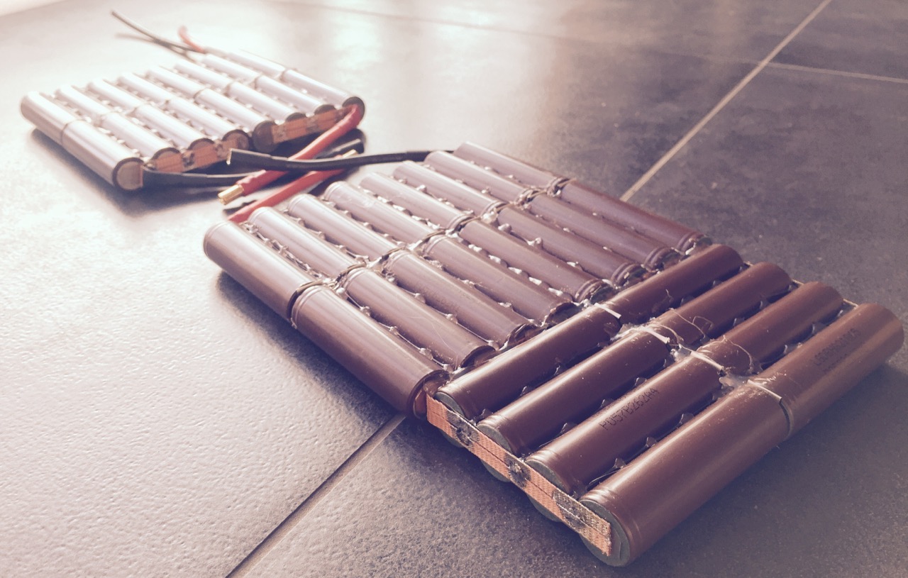

Also Whitepony, I saw that in addition to nickel strips you used braided copper wire in your pack. Do you think that is necessary if I'm only running one outrunner?
cant answer you the spot welder question, Im using a very archaic selfmade version myself. youll never get around a good soldering iron overall - you just need that for building a board. :p
I reinforced the batteries serial connections so that I could make use of its potential. my LG HG2 10S4P can deliver 80A continuous, so I wanted to build the battery properly to allow it to run that current without issues. i think the nickel strips are specified as 15A continuous, so always think about that on serial connections. if you have only one nickel strip that has to carry the current, it almost certainly wont be enough. on my serial connections with 4 nickel strips I didnt use reinforcements, because 4x15 = 60A, which was good enough for me. the bigger motors like 6374 SK3s are usually specified to carry up to 80A!

I definitely understand wanting to use all of the packs potential. With the nickel strips can you just spot weld them directly on top of each other? Do you have plans for another pack, and any design changes you plan to make or would like to see eventually?
yea, you can just weld several layers!
there have been iterations of my battery, some pushed by ES members who complained about several things, some motivated by randyc1:
* added copper wire for high current serial connections
* added protection rings to plus poles
* hot glued cells additionally to GFK reinforced tape
my latest individual 1S4P packs for the 10S4P vanguard battery are also connected by 10AWG wires instead of nickel strips to allow more flexible layouts.

So the vanguard battery is only 10AWG wires, no nickel strips at all?
Just saw your newest thread, the vanguard, and it looks fantastic as well! The composite enclosures turned out very sharp. I did the composite layup for my universities SAE BAJA vehicle. Lots of fun!
BallistrophobiaSo the vanguard battery is only 10AWG wires said:
nono, it looks like this:
still all 4cell parallel packs connected by nickel strips - and then 2 parallel packs in series by 4 nickel strips. the rest is connected by dual 5mm solder wick and the bridge between front and rear vanguard battery is done by 10AWG wire -> 5.5mm bullet connector -> inlaid 10AWG wire in the board!
