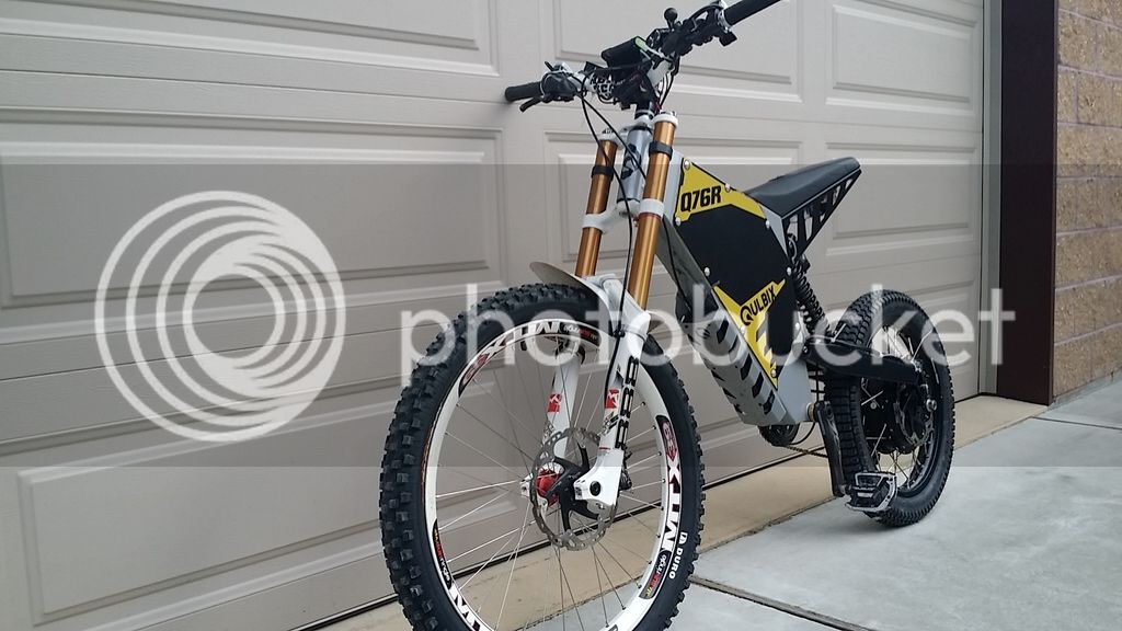

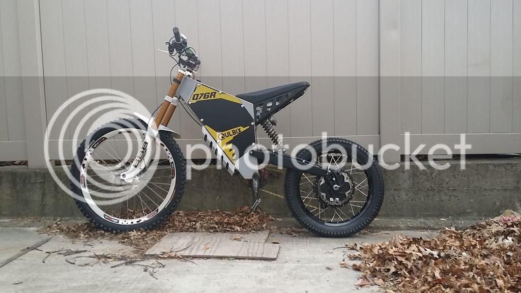

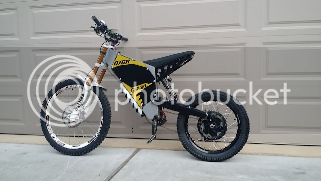

Here is my bike with 26x3.00 up front, and 17x3.00 in the rear. The bottom bracket height is about 14.2" because I adjusted my rear suspension to lift the rear up for the smaller tire.
Brumbrum, what is your bottom bracket height?
You can see in the photos that the 26x3.00" tire looks much taller than the 17x3.00". May not look the best but should offer the best handling. I'll have to measure the angle of the fork to get an idea about the geometry of my bike.

brumbrum, 15.5" is way high if that is to the center, mine is 14.2" to center of bottom bracket. The downhill community says that 15.5" would be way too high and like it more between 13.8" and 14.2". How much of a difference it actually makes, who knows.
If you swap on a 26"x3.00 front it would raise your bottom bracket even higher. Basically, you would want to use a different rear shock mount in the rear to lower the bike some. You would want to try and measure the head tube angle.
I choose not to go the 19"x2.75 route. Mainly because it would hurt the geometry of the bike, as my bike was designed for a 26" front. Using a 27.5" fork will allow you to maybe off-set some of this loss. The other issue is it would add additional weight to the front, but not a huge amount as my MTX 39 rim weighs close to a 19"x1.4 rim and my duro razorback weighs 3.5 lbs, compared to a 19x2.75 which weighs around 6 lbs. Larger tires also roll over stuff easier, so I would lose some performance by going smaller in the front.
The other problem is a 19x2.75 is very stiff tire and I would think it would not work as well as the razorback.

brumbrum, you mentioned you noticed extra weight in the rear, is this extra weight a problem? Do you notice less acceleration because of the larger tire?
Well being one of the 19/17 guys out there I can tell you that it rides perfect. I have a light weight motorcycle with peddles.....not a heavy bicycle!
