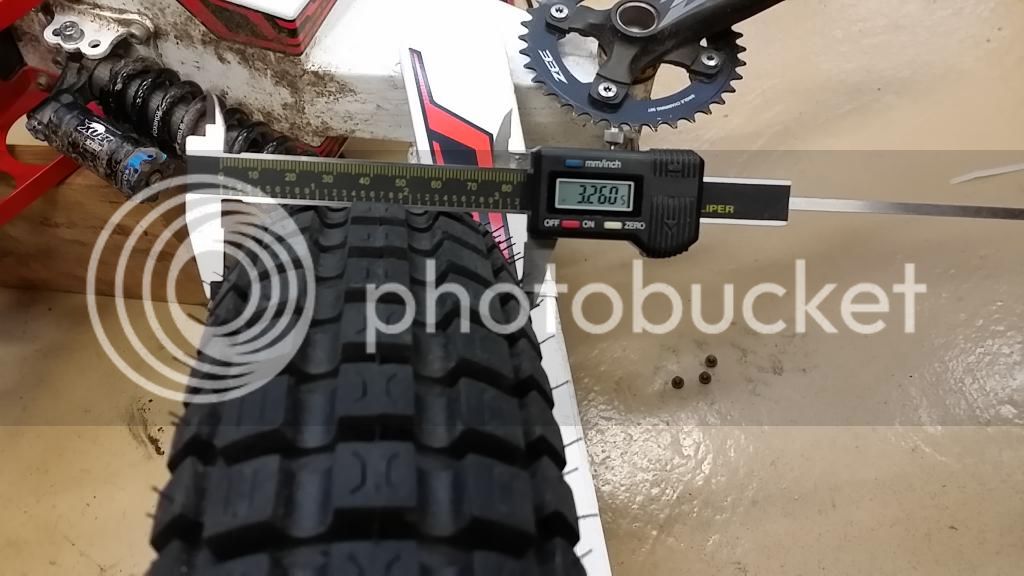

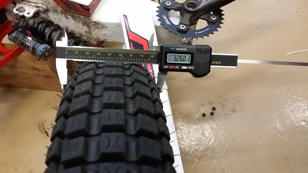

I took this picture a while back but this is the width of a 3" shinko 241 on a 1.6" 17"
rim. The width is 3.260 inches.
I have both the 3" and 2.75 in the shinko 241 in 17. The 3" has more tread, much deeper, on the tire and is much softer compound. The 2.75" compound feels very hard. If you can fit the 3" , use that over the 2.75".
I never rode on the 2.75", but I had a 19" 2.75", and the 17" 3.00" just blew it away so I never even bothered using the 2.75" 17". Both 2.75" are designed for the front and seem to have a very hard compound, while the 3.00" is for the rear and is very soft. You can easily feel it with your fingers.
We are lucky that that they make the 3.00" version with such soft compound, because I think it is just right for an Ebike. I was reading the reviews on it and lots of those heavy motorcycles which use it complained that it wore out fast. But since our ebikes are so light and lacks the torque in the rear to spin the tire, they don't wear out in like 500 miles like a heavier motorcycle would, but last a good 2000+ miles.
I can measure my 2.75 17" if you need a width measurement on that.

I would be curious for you to measure the 2.75-17 SR241 on your 1.6 wide frame as I am curious if there would be any width growth over the 1.40 wide rim I got my measurements from. I know its a PITA to do that though.

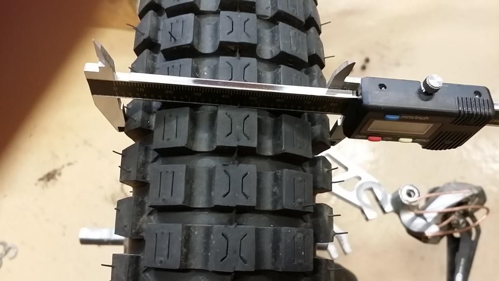

I just measured my 17 x 3.00 and 19 x 2.75 both on 1.6 rims. The 3.00 is 3.322 inches and the 2.75 is 3.17 and that is knob to knob. As Offroader mentioned the front is a harder compound and the rear is softer. I find that on groves streets the soft rear tire has a bit of wander to it where as the front does not. I assume that is the reason for the harder compound. They both do well in the dirt both hard and soft. They also do surprisingly well in sand. They still wander but way less than bicycle tires I ridden the exact same spot with.
If I could have I wanted a 3.00 on the front and a 3.50 on the rear but they were not available in the size I needed. For that I needed a 18" rear and 21" front but I got such a great deal on this buy through I decided it was worth giving up the extra 1/2" rear and 1/4" front width.

Okay LS, not much difference width wise between the 1.40 and 1.60 wide rims. I know one guy running 2.75-19 on a 2.15 rim had 3.35" total tire width with the SR241. Thats a way wide rim compared to the 1.40 and 1.6" wide rims the majority are using.
