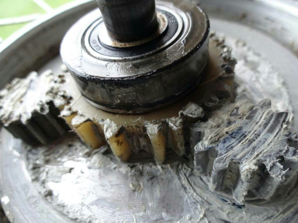

Nelson37 said:
Congratulations, you have raised the count of Xiongda with broken gearsets to an even dozen! Hooray! Or did you already report this one earlier in the thread? The picture and missing spring story sounds familiar.
Any grease on the new gears and if so does it seem to be any different that the original grease? There are one or two reports that A - the factory grease may have been changed, and B - using a different grease may prolong gearset life.
On reflection, though, you already had more miles than the user who replaced the grease himself, (1100, IIRC) and at 1400 miles before failure are among the highest of those users who experienced one, so you could already have the new grease.
The grease is kinda important as, so far at least, changing it has been the only effort made by anyone, anywhere, in an effort to solve the problem.
All ready reported on here.I bought mine at a time when it was mentioned the thick grease had been changed,so did not open up to check.when the gears striped and I opened it the grease remained me of blue tack.
There was a thread on here about oil cooling of motors.so I decided to dill and tap my motor housing and spary in some dry wd-40 PTFE every now and then.
Someone else on here uses the wet wd-40 PTFE.

when you guys did strip gears how where you riding it? climbing a long hill? on start up?
How many volts were you running? what amp controller?
36v 15 amps stripped gears on start up.foolishly changed gear and tryied to pull off again and stripped 2nd gear.The clutch had been rattling really bad that day.

In the summer of "peanut butter" gears for the Bafang BPM, the gears stripped when they were hot and then the rider then applied shock loads (wheelies), and builders around here were trying to see how hot they could get their BPM before it failed. As I've stated before, if you run this at 750W, its an absolutely brilliant solution, and yet...nobody seems to be mad at Xiongda for offering this product, only mad at Luna.
When Eric ran it 72V and XXXX watts, he was trying to break it, a process sometimes referred to as proof-testing. He was not telling potential customers that "you can do this too". When the motor succeeded at climbing a very steep hill, I seem to remember it ran at 860W, and it never reached thermal shut-down...
When mine broke I was enquiring on the price of a new one,yona replayed that the new motor would be fitted with temp monitor and shut down.The date of that email was 2 Feb 2016.
