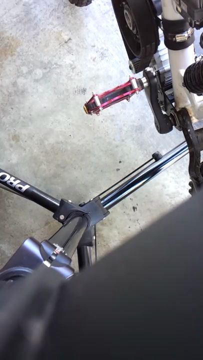

On a side note, I'm using a similar set up Cyclone triple chainring which gives me two usable chainrings up front. The only difference is that I'm using a sickbikeparts.com steel 48T chainring on the outside instead of the aluminum one supplied with my Cyclone set. This is what the clearance looks like with LightningRods lower sheets next to my 32T inner ring:
It really didn't change much from how it was before. I don't think the BB spindle length matters either since I have the 48T lined up to the 13T sprocket on the GNG Jackshaft.
