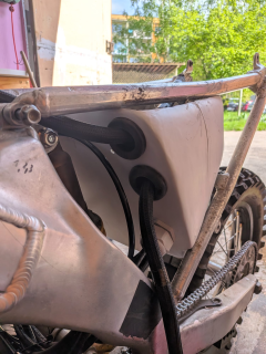

I did some work to hopefully get the bike running again soon. The fiberglass box that I meant for the #2, together with its subframe, got put into use:
This time i decided to make proper wire passthrough grommets as previously it was all just haphazardly thrown into the old airbox shape. Those rubber ones are positively gigantic, but so are my power cables... For the motor cables, i was able to get the big hall connector through a 25mm opening in a wire guide, which is great because i can then bundle all of those 4 cables together and it secures via a collet action holding everything in place. It's still all a mockup, and I'll likely put a heatshrink over that entire bundle.

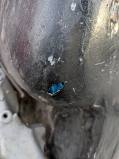

P.S. One more interesting thing; I don't have a photo, but I machined a set of 10mm spacers that will go between the controller terminals and the battery cables. This is a very critical connection, but what this will allow me to do is to angle the thick battery cables arbitrarily; with the semi-recessed terminals, it's impossible to get the cable to go from the wrong side of the controller, as the large connector plate would then rest on the separator plastic, fuse or another terminal; see image for reference:
Raising them will allow me to have much better flow of cabling, hopefully without compromising the contact resistance. I've made them from aluminium which should have decent electrical properties, and over just 10mm it shouldn't really be a problem, i hope. I will of course need longer bolts as well. The phase wires are less of a problem in this regard because they're much more widely spaced, the cables are much thinner (ironically, since they actually carry
more current - i really oversized the battery connections on this bike, didn't I?) and the connector eyelets are smaller.
