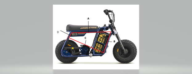

Can someone take these measurements for me. Doesn't have to be exact, just close. Thanks. screenshot.png

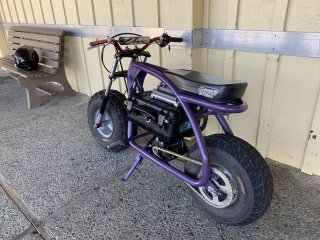

I built this for a customer. He brought me the motor and the rolling chassis though I begged him to change his mind. Well he was a stubborn dude with money. Topped out about 55… felt fine but this is considered a super sized minibike, it’s got the dropouts outside the frame and 20” OD tires. I’ve ridden gas minibikes that have done 20 over this, no thanks
