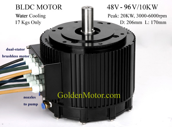

I want to put this motor in a small ~2000lb car like a Toyota Tercel ( or something like it )
I only need the car to do about 45mph for 50 miles - basically a vehicle to commute to work with and use to get groceries.
Looks like it can do 20kW continuous on 120v. Heat would be around 3000W continuous at that level, but can be liquid cooled, so maybe with the right water pump and radiator, it could do this indefinitely? I heard that 40mph requires around 10kw continuous on a small car like this. Maybe 45mph then requires 12-15kw?
The idea of using a 17kg ( 37lb? ) motor is super appealing. Do you think i'm stretching this motor too far?

According to some calculators i've seen online, to cruise at 50mph would require 7KW constant on a 1999 Toyota Tercel ( 0.32cD, 2000lbs, and low frontal area ). That does seem optimistic though! I'd be doing some pretty classic aero mods, like a smooth underbody plate, grille blockoff, rear wheel skirt, etc. Then i'd also reduce the weight however i can.

The golden motor unit can be liquid cooled, so i think that shedding 3kW continuous might actually be possible. However in this flat area, i would be cruising along at 45mph on level or slightly sloped ground, so for the majority of the time, i'd be pushing about 10kW, which would only produce ~1500W of heat.
For removing the heat, i was thinking of using a valve that could either run the hot liquid through the original heater core in the winter, or redirect it through a 50cc motorcycle sized radiator. I'm not sure what kind of pump i'd use; maybe 500 watts could flow the coolant pretty well, and i could run sort of an electric thermostat that would run the pump at a certain temperature threshold.

Your cromotor will do about 85% efficiency too. The reason it's cold for you is that you aren't likely pinning it at 3000W-4000W continuous, and the motor is huge.. so it can shed what heat it generates really fast. It still generates around 15% of it's power as heat. I can't get it to do 90% efficiency on the ebikes.ca simulator.
That's 3,000W of waste at 20,000W of power, or 15% energy wasted in a 85% efficient motor. If i am cruising at 10kW, i can expect to shed about 1500W of waste heat. That's actually not too bad.

Assuming the HPM10000B shares the same design principles as the HPM5000B.....
.....The thermal resistance between the phase coils and the liquid cooling is terrible with this motor design, just as it is with the fan cooled motor. The whole motor needs a case redesign to efficiently get the heat out of the coils and into the casing. The best way I can see is using vacuum impregnated thermal epoxy (unfortunately from the reading I have been doing is way too hard to DIY properly with basic equipment).
The path phase coil heat must take is coils > air gap > Nomex paper (or like) > tooth laminations > a few small tack welds joining the tooth laminations to a spiraled disc of backing laminations > non thermal greased and unlapped clamping to cast Aluminium backing plate > liquid/air = Piss poor thermal conductivity. In fact im sure that the thermal path though the air contained within the motor dominates in the thermal transfer rather than through any solid medium.
Anyway, bottom line is that to bring the real-world continuous power figure closer to the unsaturated burst power potential of this motor, the thermal managment design needs serious revision.
Hmmmmm, yeah that's something to consider.
The interior of the stator would be really hot trying to ditch 3000W of heat on hills.
Only one side of one stator would get cooled.

The more i read, the more it seems like i'm gonna end up with an impulse 9.
This motor is 129lb, which i don't like, but it's one of their lighter motors, and can do >30hp continuous, so it will climb those hills with some extra headroom.
I wonder if the 90-94% efficiency is real?
That would negate the extra weight.
If i wanted to stick with the golden motor 10-20kw units, i could run two.
I'd get two 96V models and run them at 120v x 120A. This would produce 14,400W each x 2 = 28,800W total, or 39 horsepower.
Each motor would then only need to shed 2160W at peak.
If i split the load between the two motors while cruising at 10kw, they run only 5kw each, and only need to dissipate 750W.
