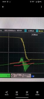

I'd meant a few weeks back to make some more notes on the waveforms your found. You've all but fixed it I suspect with the isolated drivers but I think it's important to note a few things:
In my screenshot of your scope you can see the Miller effect between the two red lines I've drawn. It's about 1.5V. this is about what I'd expect for that MOSFET and bus voltage.
The high frequency stuff is the result of the Miller capacitance turning the FET on and off as the voltage falls. I don't know if it's especially harmful or not. It's certainly going to result in more energy dissipated in the junction than a smooth transition since you're charging and discharging the output capacitance multiple times and that energy is dumped into the junction but whether it's too much...
The next thing I note is your gate rise time constant. About 400ns from eye. That's quite slow already. If you slow it down even more you're going to have issues with dead time, which I presume you must already be running about 1.5us or so. That's a lot of dead time, it directly affects your output voltage. Dead time is effectively an opposite voltage so rather than driving there motor during the dead time it's... Anti driving it. If you're running 15khzpwm for example, 1.5us represents 5% voltage loss.
Despite your slow time constant on the gate, your FET is still switching in about 50ns. Clearly slowing down the gate more is not going to help things much but will have serious detrimental effects. I would speculate that the high frequency noise during the switch will be amplified and last longer... More damaging to the FET
The higher amplitude noises you've labeled as Miller in various screenshots of the scope above are 100% not Miller effect, they're inductive effects. If you try to treat them as Miller related problems, you will only succeed by sheer luck if atall, and in the process cement incorrect understanding.

So, what you say, it is 100% NOT miller effect, it is inductive effects (the gate spikes), so they mess around with the gate voltage and produce the shoot thru event? sounds resonable, that inductance might come from the long twisted wires (few 4 or 5 cm) from gate drivers to the power board, with the new gate driver board witch will be mounted on top of power board that distance will be eliminated almost completely, and 5A gate drive punch will certenaly be able to switch the gates faster than 400ns, plus the clamp function keeping the gates voltages secured down.
