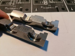

I have made a die (jaws) for crimping cable lugs, for 35 and 25 sqmm cables, i followed the specifications for hex size for correct crimping. I came out nice, a big vice (100mm at least) is needed to make a good crimp. Here a few photos of the die and a crimped cable and lug.

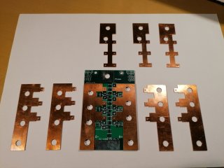

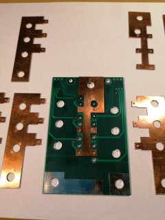

A bit of progress here, i have made a fuse box to encase the fuse witch will be bolted to the battery + cable, now i know that fuse is rated at 32V and i'm pushing 92V thru it, it might arc a bit when it blows, but still better then nothing and blowing up my power board, i'm aiming for a bit less damage if the fet-s get shorted.
The boards arrived, i'm impressed with they'r quality and tolerances, far better than local my pcb supplier.
I'm still waiting for the metal parts, case and busbars, that are cut and bent at the metal work shop, they only do guillotine cutting and bending, then i will have to machine the holes in to them.
Here are a few pictures.

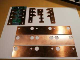

A bit of progress, i had some time to machine the bus-bars and the case, the pcb bus bars ware a bit of headache to make since they are so small and thin, the copper is so soft i had to add some aluminum plates to support the copper in order to be able to machine it (see photo). Now i have all the parts and soon i'l start assembly.

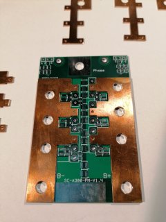

I put together the power boards, i came out nice and sleek, now i have to solder the FET-s and DC-link caps , make the big cables, and a few things here and there, then some testing.
This is beautiful. Hope it works! If it does, it should take all the power!
Big laminated DC bus a very good call. Might just solve all the inductance issues in one hit.
Great job in your power bus packaging. You've got way above average electrical and thermal conductivity, and tight inductance. I'm excited to see how they perform, I may need to make or buy some for my own projects.
I just noticed you populated the snubbers and a load of gate to source capacitors already. How did you know what values to use without testing and what did you choose?
They should be in the 1-10nF region (similar to the output capacitance of the FETs but not actually the same) and the snubber resistors 0.5 to 2 ohms.
It's slightly complicated by your having 6 of them, half each to V+and ground (you only need one of these since for high frequency with such a lovely low inductance V+and ground are basically the same) so calculated values would be C/6 and Rx6.

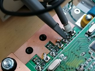

I did some testing, all tests ware with motor and no load (prop).
First tests ware at 30v at 1A with Rg 12ohm Cgs 100n and low side snubb R1,1 C4,7n, and the results ware not quite ok, there was some wired oscillation at the end of Ls fet Vds rise time, i made some test at 90V and the ochillations ware way worst (forgot to save the waveforms), so i blamed Cgs, and removed them.
Here is the probing, the Vds had low inductance probing, Vgs din not unfortunatly and as you will see it might had introduced artifacts...

Here is the log from controller showing the max voltage and current on test 5
All in all it performed well it spun the motor to 3200rpm, stayed cool, all waveforms ware consistent there ware no wired pulses and spikes like on V1.3 tests, so so far so good.
Next month i'l get a new scope (100Mhz BW), with my picoscope, i'm way over its BW and samplerate limits now, i'l redo the 90V no load tests with the new scope, and report back, until then please comment on what you think i presented here.
